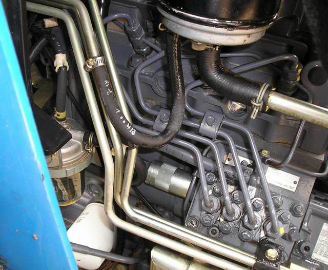

The TC45D is advertised to have "self-bleeding injectors." The top of the injector pump has a bleed point near to where the fuel line attaches at the banjo bolt. That is the only recommended bleed point. I would change the fuel filter rather than take a chance. Filters are cheap and my time is expensive. After putting in a new filter, remove the injector bypass return line off the top of the filter assy and open the petcock. When fuel flows out the loose hose fitting, the entire filter and bowl are full of fuel. You can also bleed the bowl by loosening the ring at the top, but that can leave a small pocket of air inside. The bypass return method will ensure the filter bowl is full. Then all you have to do is loosen the bleed point on the injector pump and crank the engine until bubbles stop. Tighten the bleed point and see if the tractor will start. Only if it does not start at that point would I consider bleeding the individual injectors.
I think your process is good, but rather than say "clean the fuel tank and lines" I would say check that you have good flow from the fuel tank and lines. With the fuel filter off, open the petcock and see if you have fuel flow. BTW: You also have a lift pump between the fuel filter and the injector pump. I have never heard of anyone having a problem with that pump.
I'll try to post a photo or illustration of the injector pump bleed point if you can't find it.
   / New Holland TC45D Working fine and then died , will crank but wont stay lit #14
In the photo below, the injector pump is shown. Where the fuel line comes to the top of the injector pump, there is a banjo bolt where the hose attaches. Above that, there is a hard line coming down from the injectors with a hex-head above that. The hex-head is the bleed point. Set the engine throttle to wide open and crank the engine with the hex-head loosened enough to allow fuel and air bubbles to escape. When the bubbles stop and there is only fuel coming out, the tractor should start. Be ready to decrease the throttle so the engine does not rev. Tighten the hex-nut, but don't over-tighten, just enough to stop fuel flow and snug enough that it won't vibrate loose.
Notice also in the photo that there is a hose on top of the fuel filter. That hose is connected to the injector's return to tank vent line. to make sure the fuel filter has no air, close the petcock and remove that line. Open the petcock until the bowl fills and all air escapes. Then close the petcock and replace the hose. Bleeding is a bit messy, so you need rags and something to catch fuel.

this is great help, thank you for the photo. I will work on this week, take pictures and, report back
