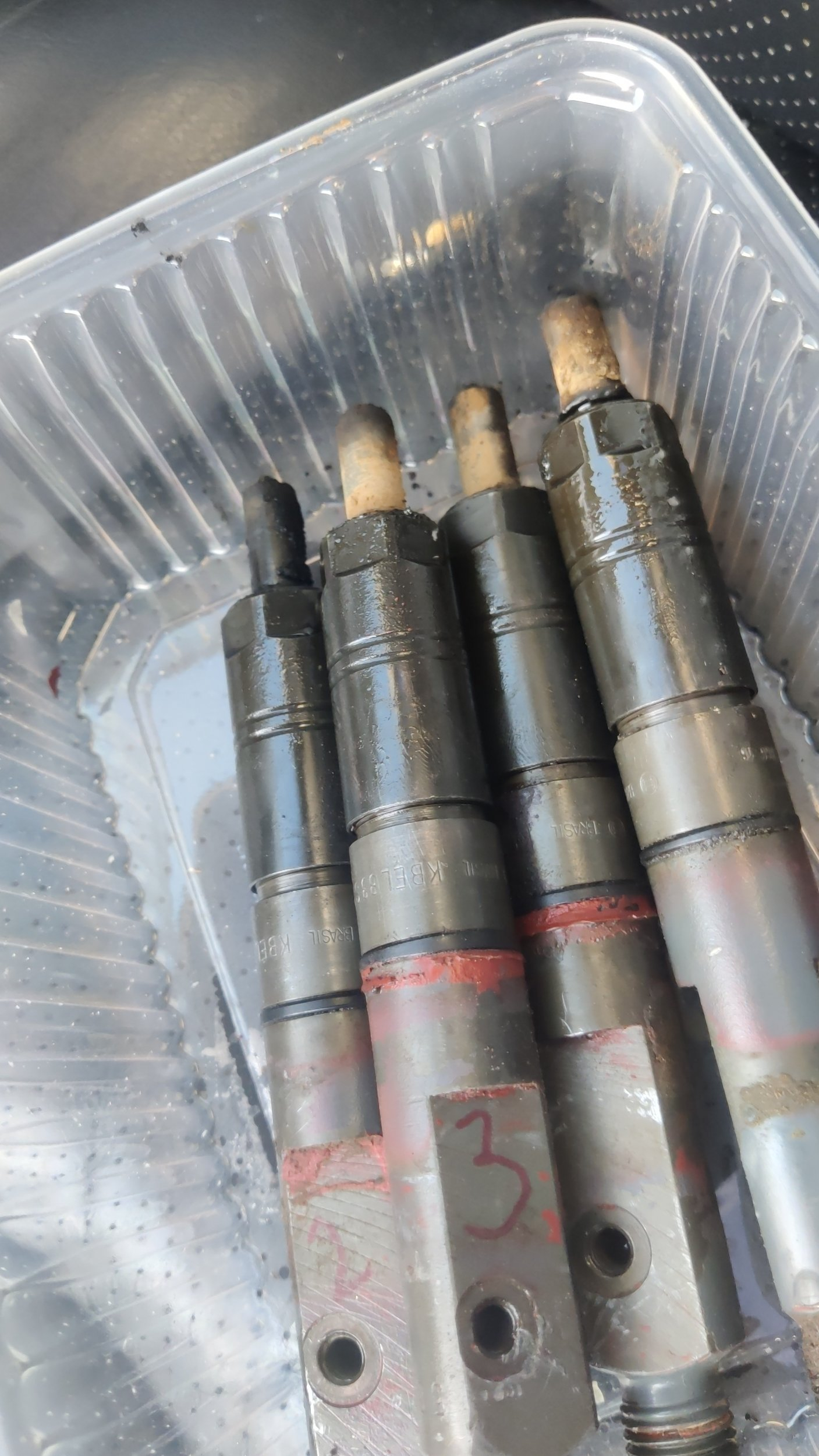

I would pull the injectors and hang them outside the engine and hook the lines back up..& crank the engine to SEE if they’re firing..
DONT GET NEAR THE SPRAY.!! IT WILL PENETRATE YOUR SKIN.!!

Injectors out to test... 3 looks dry, one looks wet and dirty.
