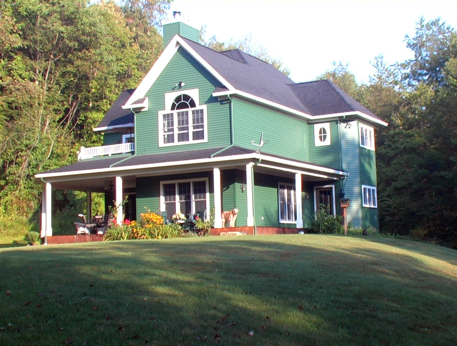

Scoutcub, Our home was built not far from you (Malvern) in 2003. It is 2x6 construction, 9' ceilings, hardwood and tile floors through out, with seamless steel siding, five french doors, a full 12 course block basement, and a wrap around Ipe deck. Back in 2003 it was built for about $125/sqft (the best I can figure). It is a very well built home. If you are going to be the GC you could knock some off that price.
As far as your specific question about the breakdown for foundation, framing, and so on, I really can't help you there.

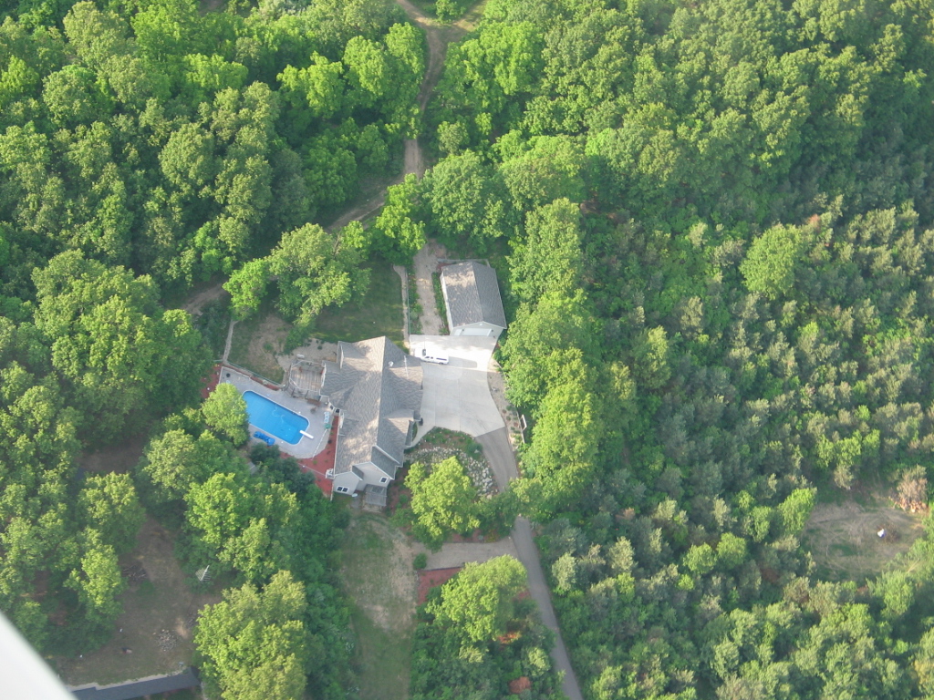

I was the GC on my house project and I will tell you after it was completed, I vegged for a few months. The missus couldn't get a team of horses to get me out of my easy chair. With that said, I have to say I really enjoyed doing the project. One of the key elements is not to always take the less expensive way. I built a 2400 sf ranch with a full poured wall, walkout basement. You see, I learned a lot helping other friends build their house. I was mostly the grunt labor for the different projects that were going on. That way I built up time from all of them and they came over to help me on different parts of the project. I watched and paid attention to a lot of what was going on. I also seen some things I would not except and saw some other thing I thought were pretty cool.
Some things I learned, I in no way had enough budgeted for landscaping... Well I did for my taste, but the little boss wanted something totally different than what I was thinking. I am here to tell you boulders are expensive, especially 4 leads of boulders. Second, all the plants she put in would have scared the monkeys away in the jungle....I couldn't tell you the name of a tenth of them, but she could.
Kitchen, bathes and lighting can get out of sight. Who would've of thought pine cabinets wasn't ok for the boss. We ended up all hickory with granite everywhere including the walk-in showers.
For my own peace of mind I overbuilt everything, upgraded the trusses, floors, shingles. Didn't want to do them again. Glad I did, because I have absolutely no deflection on my floors. We did the tile, installed the cabinets, lights, doors, siding and painting too.
I subbed out the flat work, poured walls, framing, plumbing, mechanicals, septic, well and drywall. The rest we pretty much did. I am here to tell you installing 1400 sf of tile will make a old man out of you in a hurry.
I prepped the land and cut in the diveway (400 ft).....any reason to get on the big toys, I used it.
But there was significant satisfaction after it was all complete and I know everything was done the was it was supposed to be done. Key element was also making sure you used subs that have a good reputation and you have seen their work. While it gets time consuming to go check, make sure you do.
We also had building inspections along the way and the inspectors made sure they checked it all real close because I was the home owner building his own house. I was frustrated at first then thought later of it and appreciated them looking as close as they did. The real question, would I do it again.....probably so, but I sure won't lay the dang tile again.
All in all it came out great and I can carry the bragging rights that I built it myself...or at least some of it. I would estimate I saved 50 -60k on GC charges and another 30k or so soing some of the work we did.
