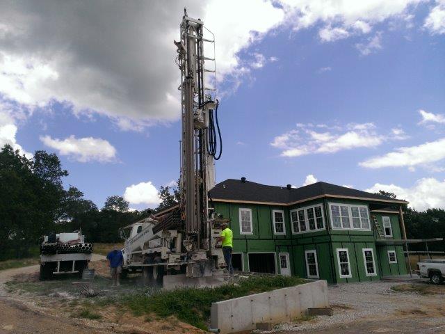

Geothermal wells going in:
382455-new-home-construction-wp_20140702_004-jpg

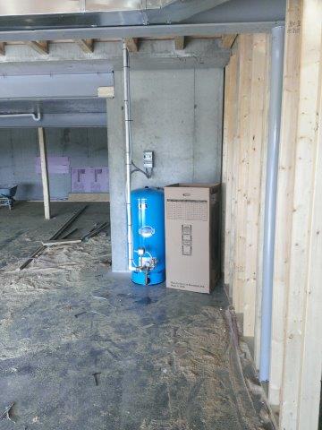

Missed pics of the water well being drilled, but the pressure tank and spigot are in:
382456-new-home-construction-wp_20140710_001-jpg
382457-new-home-construction-wp_20140710_005-jpg

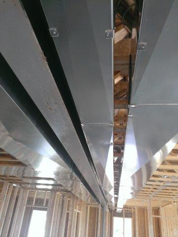

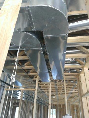

And most of the ductwork for our 5-zone heating and cooling system:
382458-new-home-construction-wp_20140710_003-jpg
382459-new-home-construction-wp_20140710_004-jpg

How many wells did they end up drilling? I thought hard about geothermal when we built a few years ago and am still thinking about it.
   / New Home Construction
#106
We ended up with 5 wells, enough for 6 ton of capacity. We are putting in a 5 ton unit, but added the extra well for added efficiency. We have geothermal in our current house and love it! Our bills went down while keeping the temperature cooler in the summer and warmer in the winter after we added it to our current home.

Normally it's 1 ton per well, or 1 1/2 tons per well. with 5 wells and 5 tons, you probably don't have extra capacity. What size are the loop pipes in the wells and lengths, that is usually a good indication. I have designed and installed geo systems.
The house looks great. I was unfamiliar with zip panels, I have seen them used here but didn't know what it was.
#110
Yeah, it's normally 1 ton per well. I think they just went a bit deeper in each well instead of drilling an extra well. I'm not sure of the size and lengths of the pipes.
