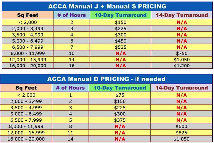

Thanks, I'd no idea as to the name of the software. I expect to pay for it but don't know what is reasonable, is $200 about right for the manual J?
Keep in mind, Wrightsoft is only one software program out there of many out there (Wrightsoft probably is one of the most expensive ones out there, and I'm thinking that becomes a racket as well).
A room to room load will proably cost more than a block load, and I'd guess the sqaure footage would determine. I looked online, and it seems my guess was right.
