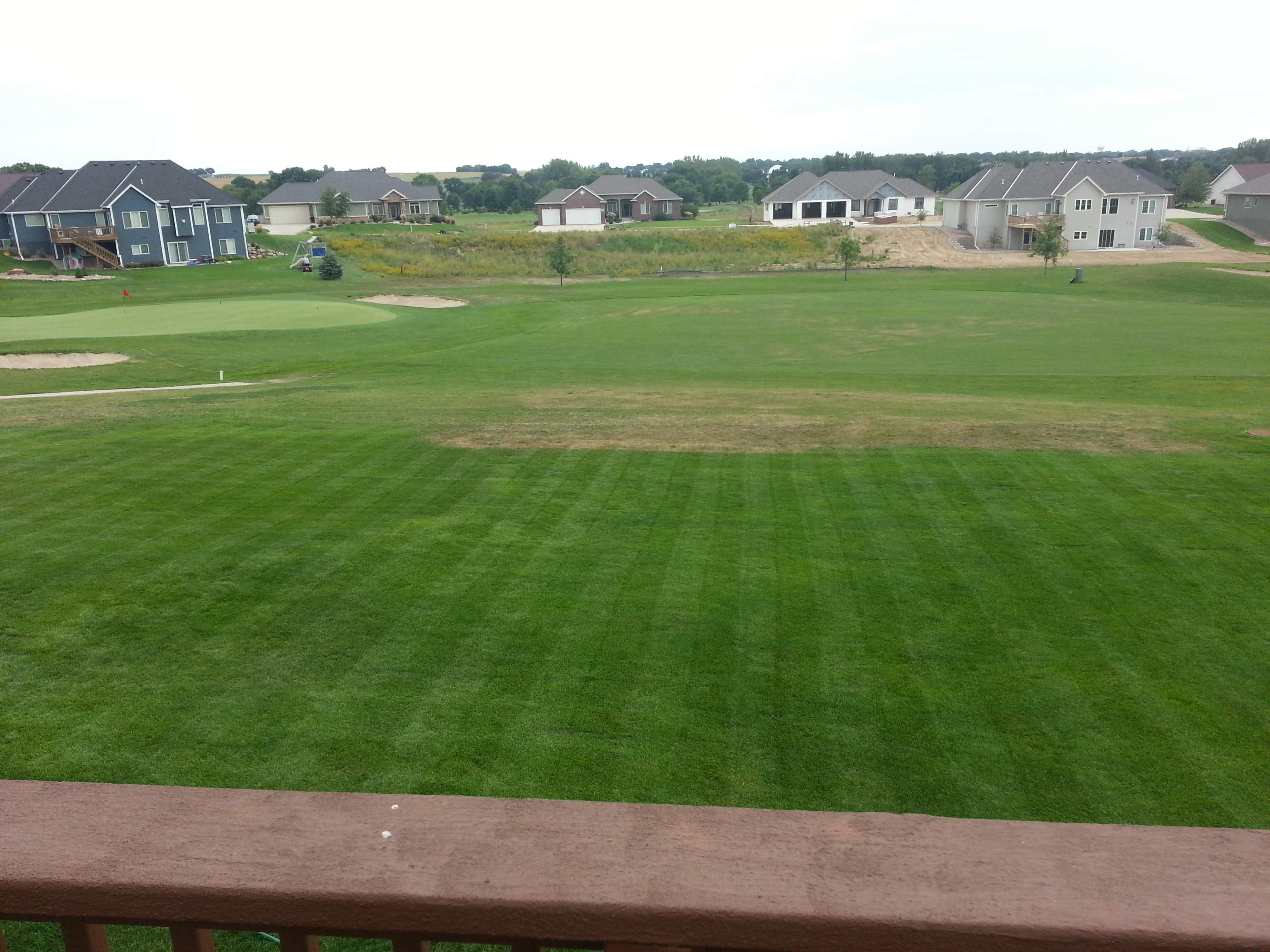

Bird, thank you for fixing my duplicate I appreciate it!:thumbsup: Also I never.....well...almost never mow when the grass is wet. I dont like the way the cut looks when its cut it wet. My last house I had a Cub Cadet LTX 1046 which I still have but I didnt have a roller on it, but I had one on my push mower. So over the past 3 summers I only put 10.5 hours on the Cub Cadet. I mowed about 2x a week with the push mower cause I love the stripe effect, and I liked the exercise(first picture is my old lawn). I am definitely going to get a Checkmate Striping kit for my next zero turn because this lawn is way to big for a push mower. :S

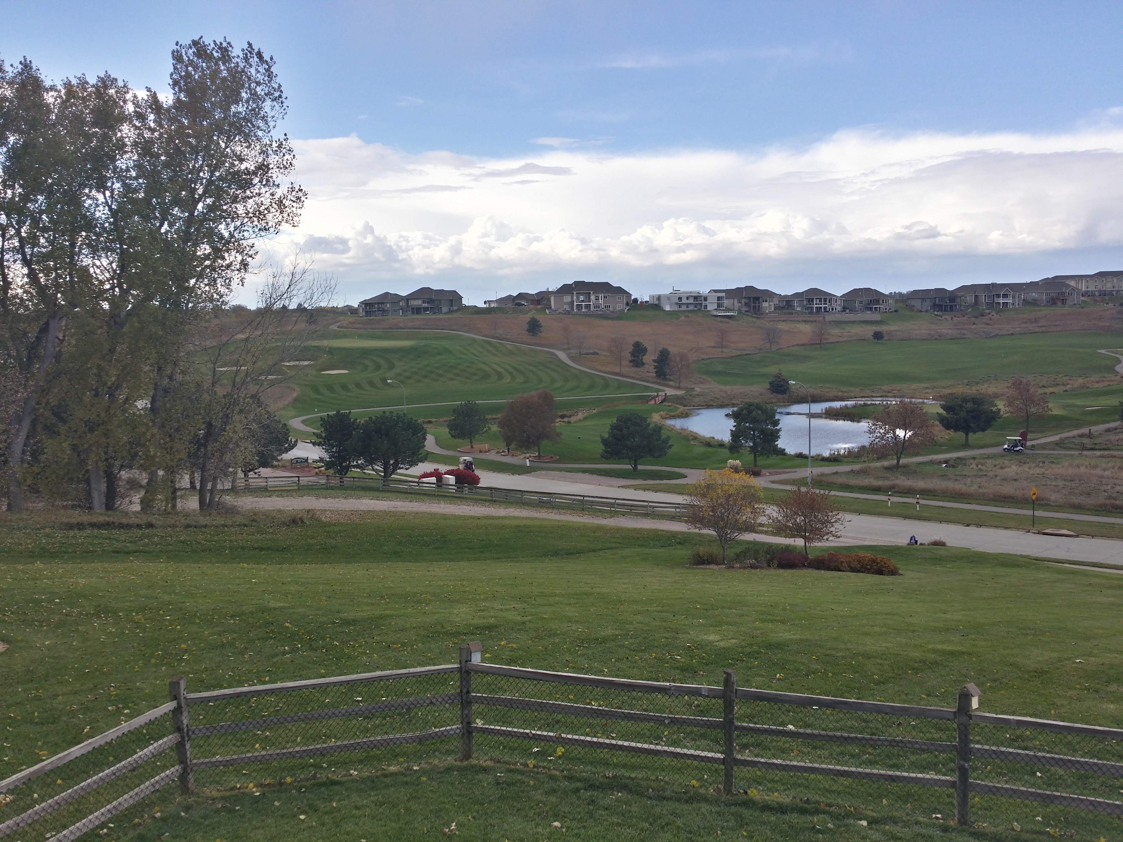

Note: First picture is my old lawn using a push mower with a pull behind roller I bought. Second picture is view off of my deck.....for those of you who like to compete with you neighbor.....this is what I have to compete against haha!:laughing: I hope the Checkmate roller works well.
