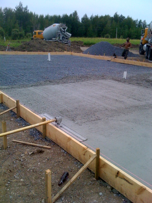

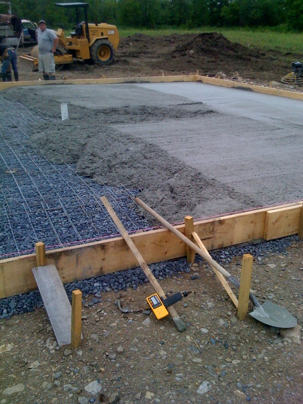

here are a few pictures of us pouring the concrete slab, just as we finished polishing it started raining , rained half of the day today seems like it's ok. tommorrow we will start framing the walls. trusses are scheduled to arrive on friday

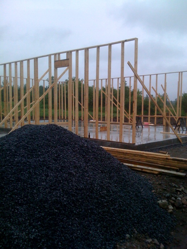

here's a picture of the walls we got up today, it rained most of the day here and was hard to get anything done

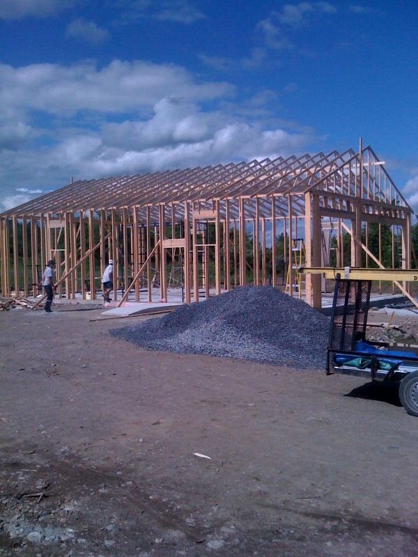

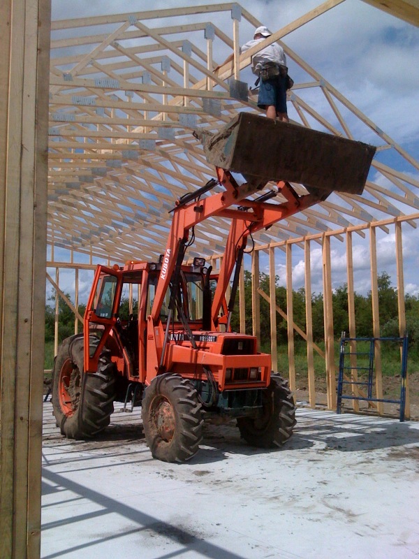

finally had a couple of days of no rain and got some work done. finished the front wall and put the trusses all up. the walls are 12' high and make it hard to get trusses up. i also ran over my paslode framing nailer with my 96hp kubota, barely a scratch. what a tough tool, and so handy. tomorrow we will sheet the roof with osb and add strapping to the walls for the tin

my slab goes 10" deep around the outer edge by 16" wide and tapers up to the 4-5" accross the center. we used 2 rebars around the perimeter and mesh in the whole thing. and we cut it it every 10ft for control joints. my last garage was built like this and i never had a problem with it . i always install tile drainage around it to keep the water away from it

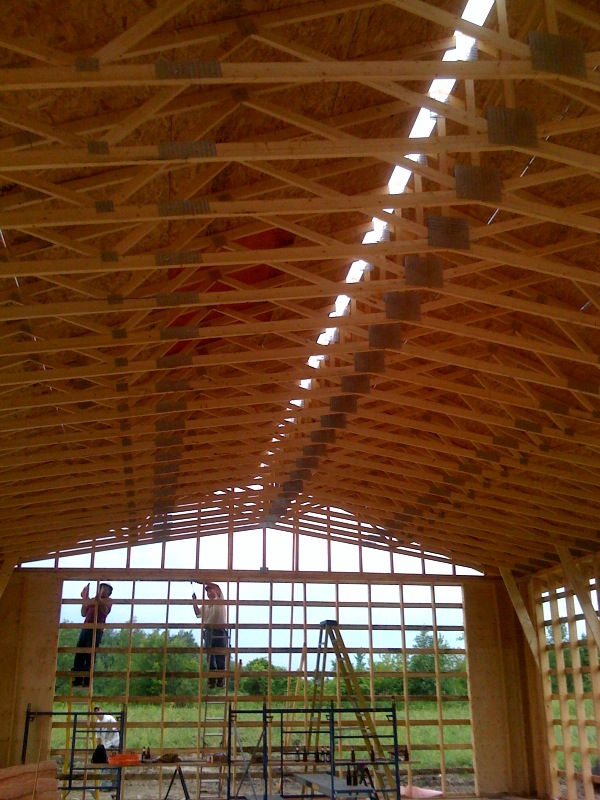

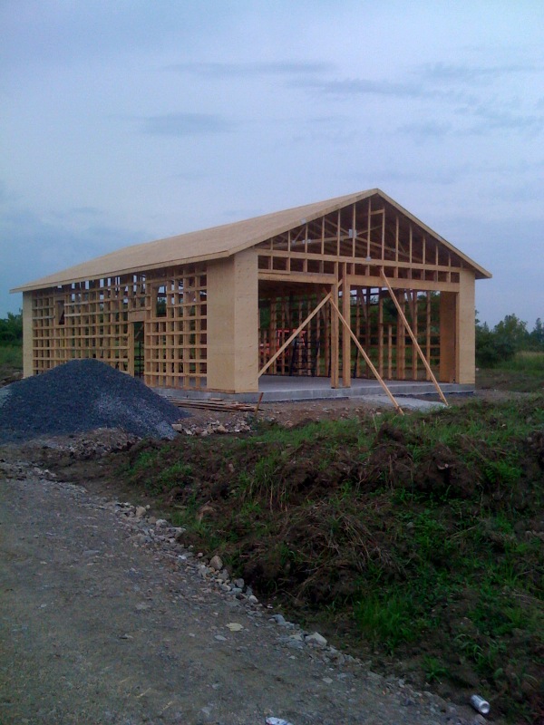

a couple more pics of the garage, got most of the strapping finished and all off the osb on tthe roof. knee bracing all installed, ready for inspection then on to installing tin
