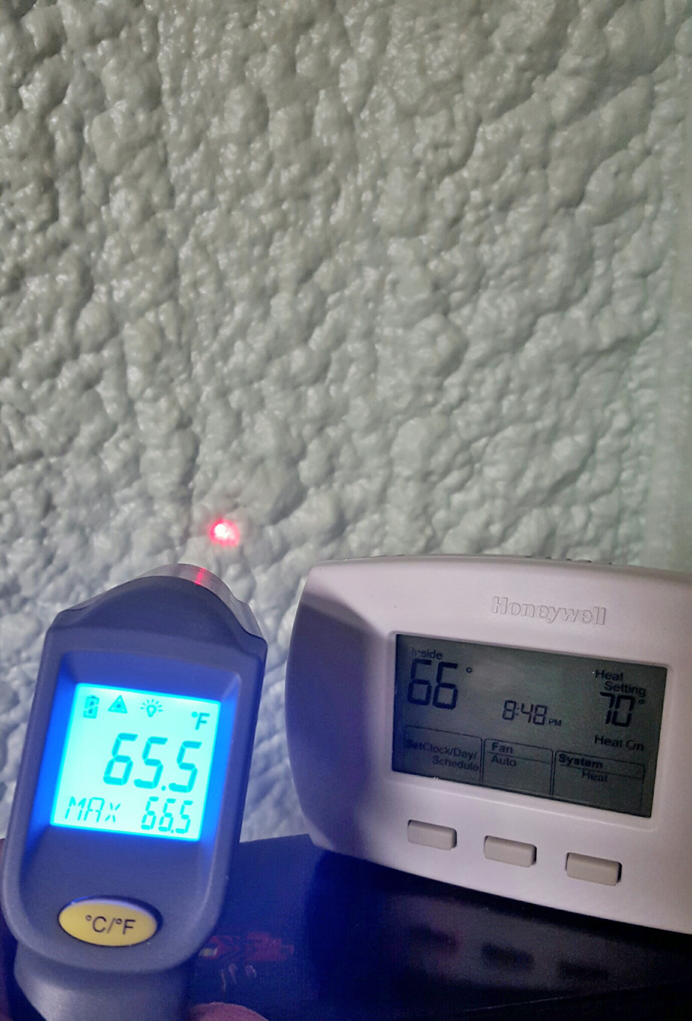

I really like the idea of spray insulation, but it just isn't in the budget. We are about maxed out as it is. I can almost guarantee that this will become a "I wish I would have done that" down the road....
Justin if there is any way to swing the spray foam try to do it. You can get to the attic later but now is your only chance to do the exterior walls. I've made some adjustments to zoning dampers and spent this evening monitoring HVAC run times from my laptop. Heat is set at 70 degrees for all zones, basement off. From 8:30 this evening (outside temp 35 degrees) until 12:30am (31 degrees outside temp) I have a total run time of 53 minutes heating our 1st and 2nd floor with a total of 3,900 sq/ft. That's with no solar gain.
Here's one more example. The below pic is an outside wall with 2-1/2" of closed cell spray foam. Under the foam is OSB sheeting and vinyl siding. Outside air temp is 29 degrees when pic was taken. Inside air temp was 66 degrees.
I do understand how hard it is to stay on budget though, let alone find several thousand dollars for something extra. At least seal the best you can with vapor barrier and make sure you blower test.

How much better is closed cell vs. Open cell?
   / New House Build in the Country!!! #324
Closed cell will give you a much higher R value which is very important for small spaces, like the depth of your rafters. Open cell is a lot cheaper, so you can reach an R value for a lot less money if you have the space.
Closed cell means that each little bubble is water tight. It keeps out moisture, it's hard to the touch, and for docks, it floats.
Open cell absorbs water, it's soft to the touch, and when it gets wet mold grows. It is very bad for metal roofs, or most roofs when sprayed right on the roof. Condensation will form under the roof, soak into the open cell, and mold will grow. It just gets worse from there.
As a comparison, during those same 4 hr times last night, my upstairs geo unit ran 1.8 hrs and downstairs ran 2.09 hrs. Outside temp went from 36.2 to 33.6. I have all batt insulation, and too much air leakage around the batts. R30 ceilings.
Mine set at 67.
