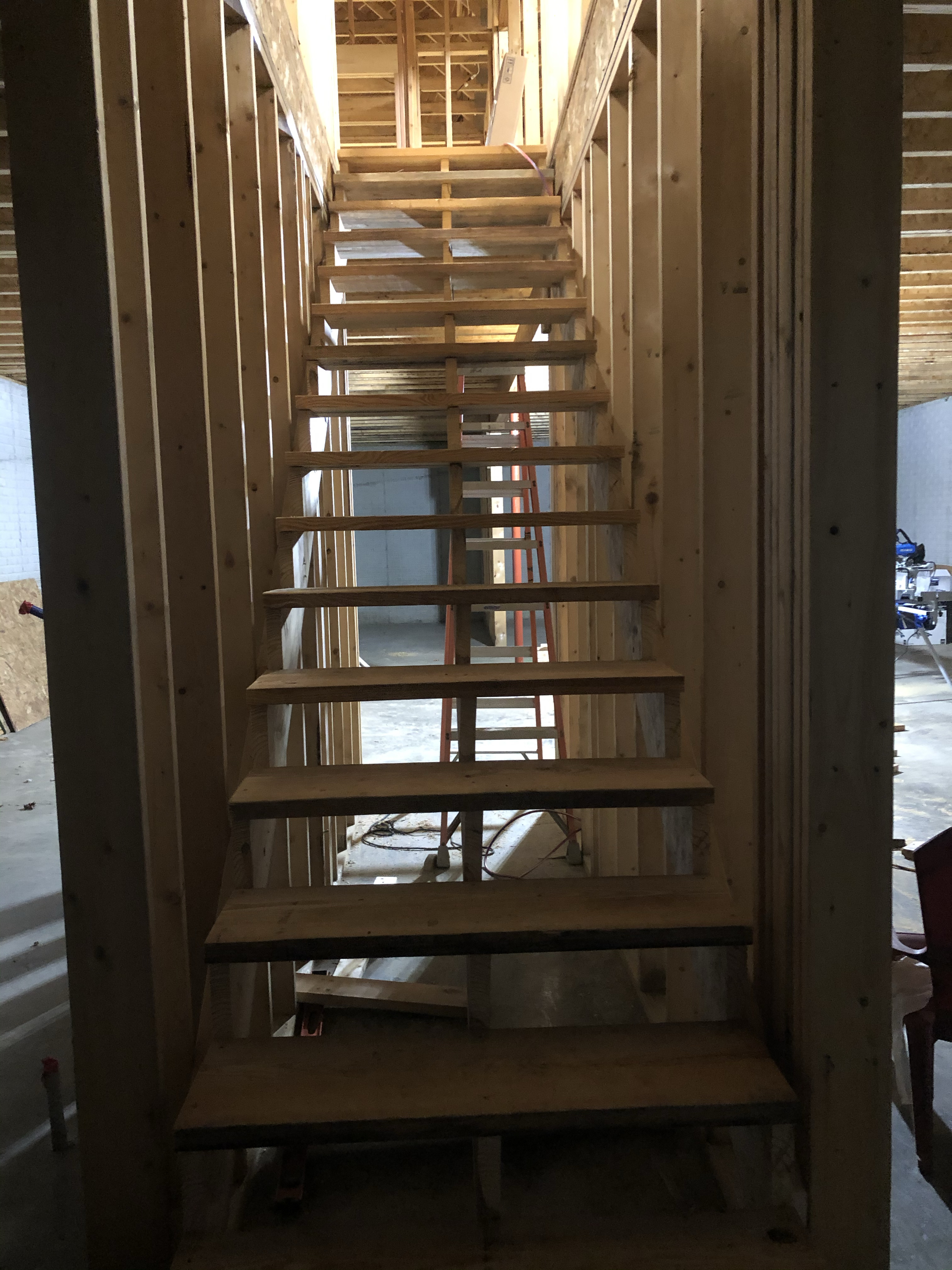

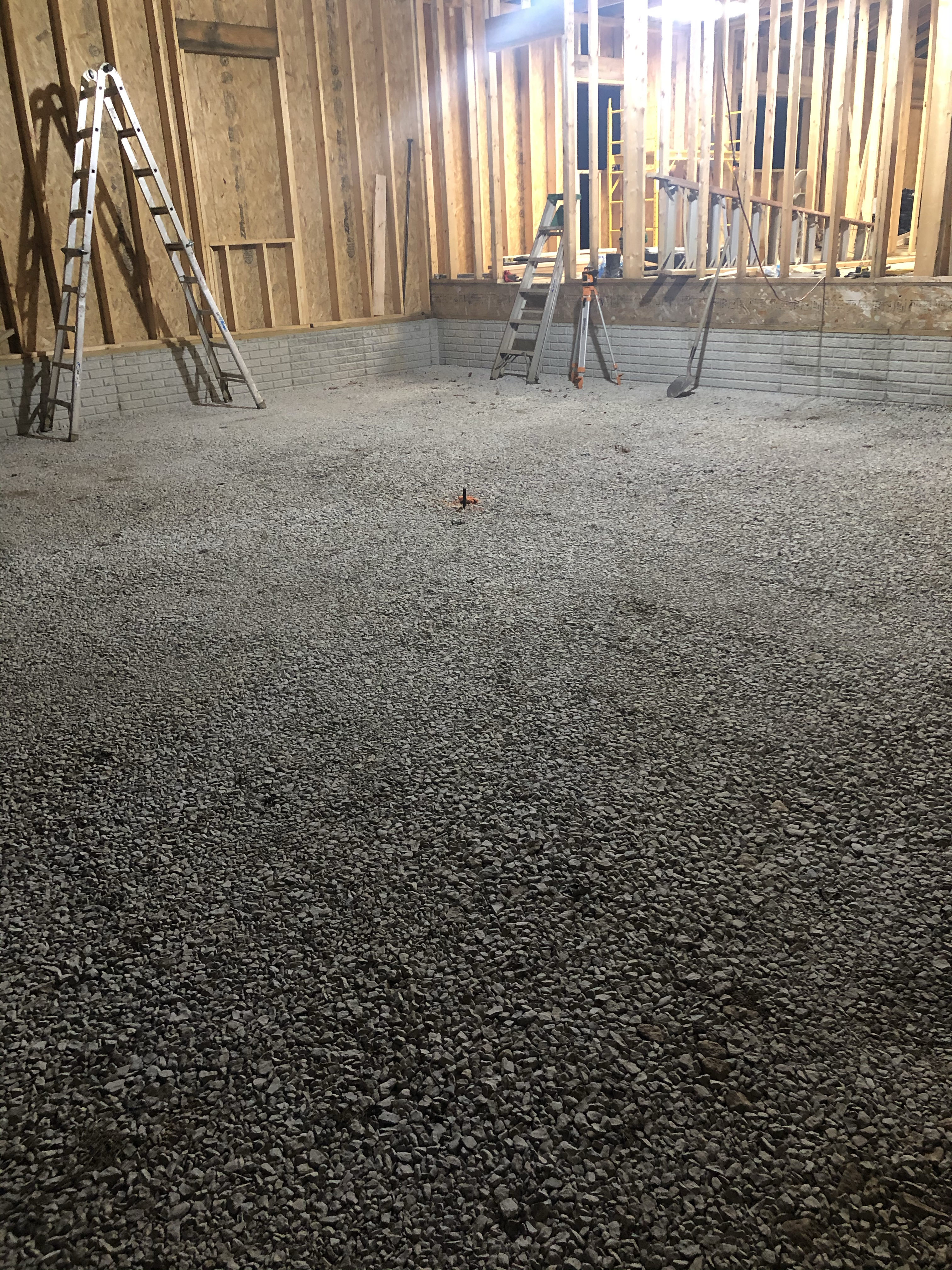

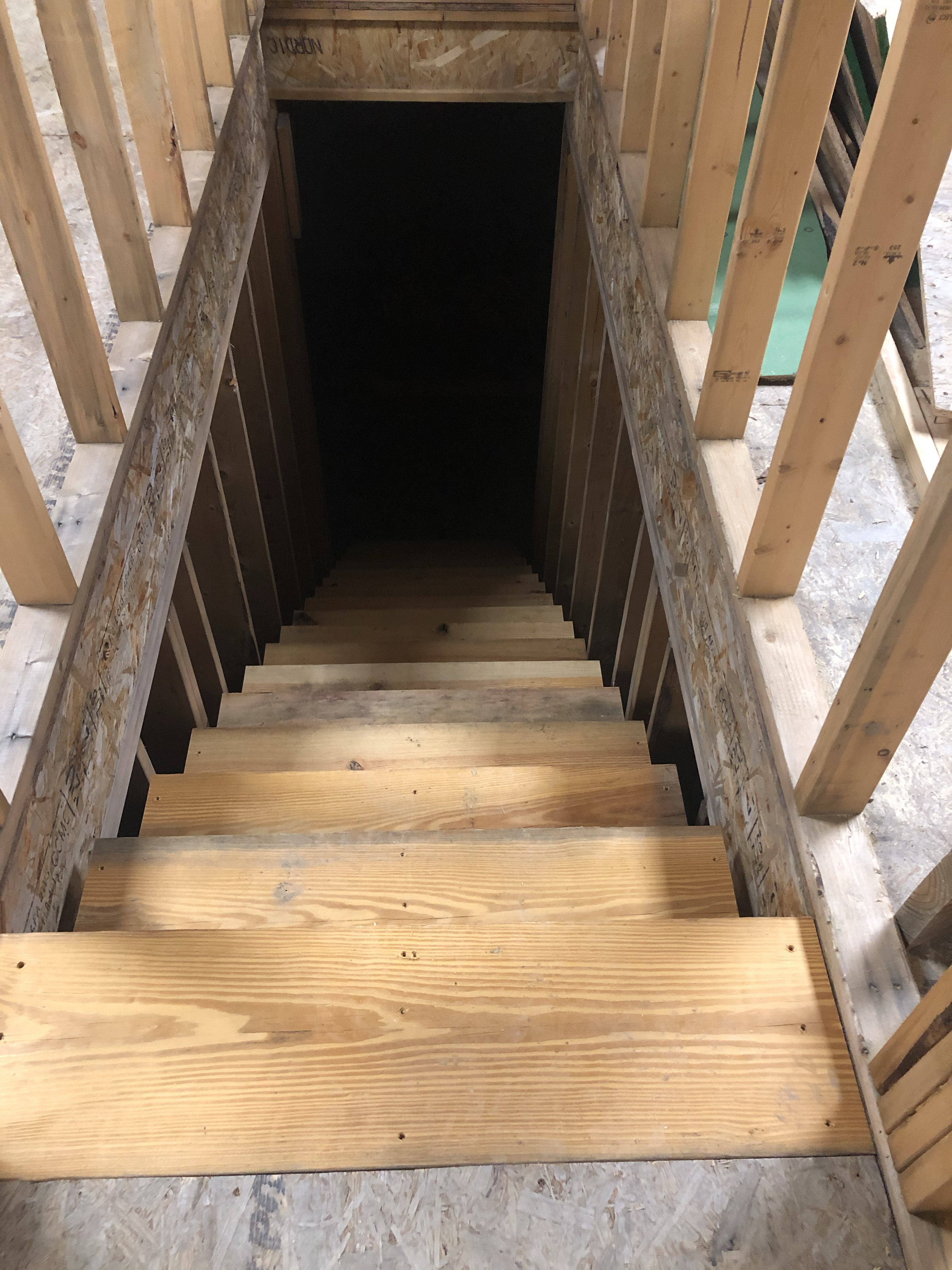

Been a slow week but did make some progress. Finished the stairs to the basement and got the gravel pretty much finished in the garage. Also picked up all the supplies for my underground electric service. Have a guy coming Sunday morning to dig my ditches, he’ll likely help me install the conduit and water line as well. Rain in the forecast for the weekend now, so not sure that will happen.
I’ll work on the last of the garage wall and decking through the weekend. If rain holds off, I’ll till and drag the front and side yard and plant seed.
I’m off all next week, so should get a lot done.

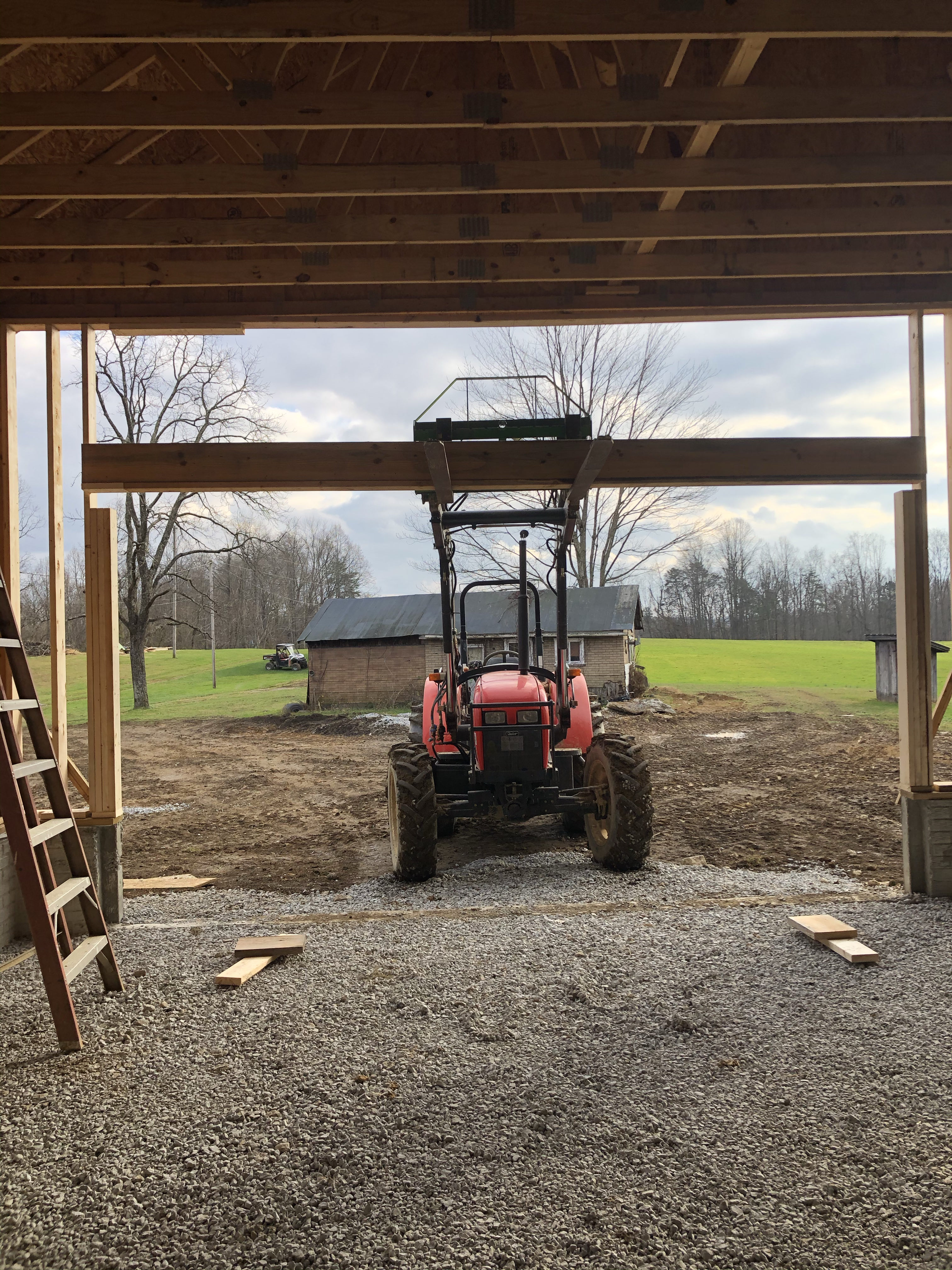

Not sure if I mentioned yet or not, but I purchased a set of forks for my tractor just before starting the build. One of the best purchases I’ve made and I’m not sure how I would have done most of this without them. Here’s a shot of the tractor helping lift the 16’ garage door header in place.

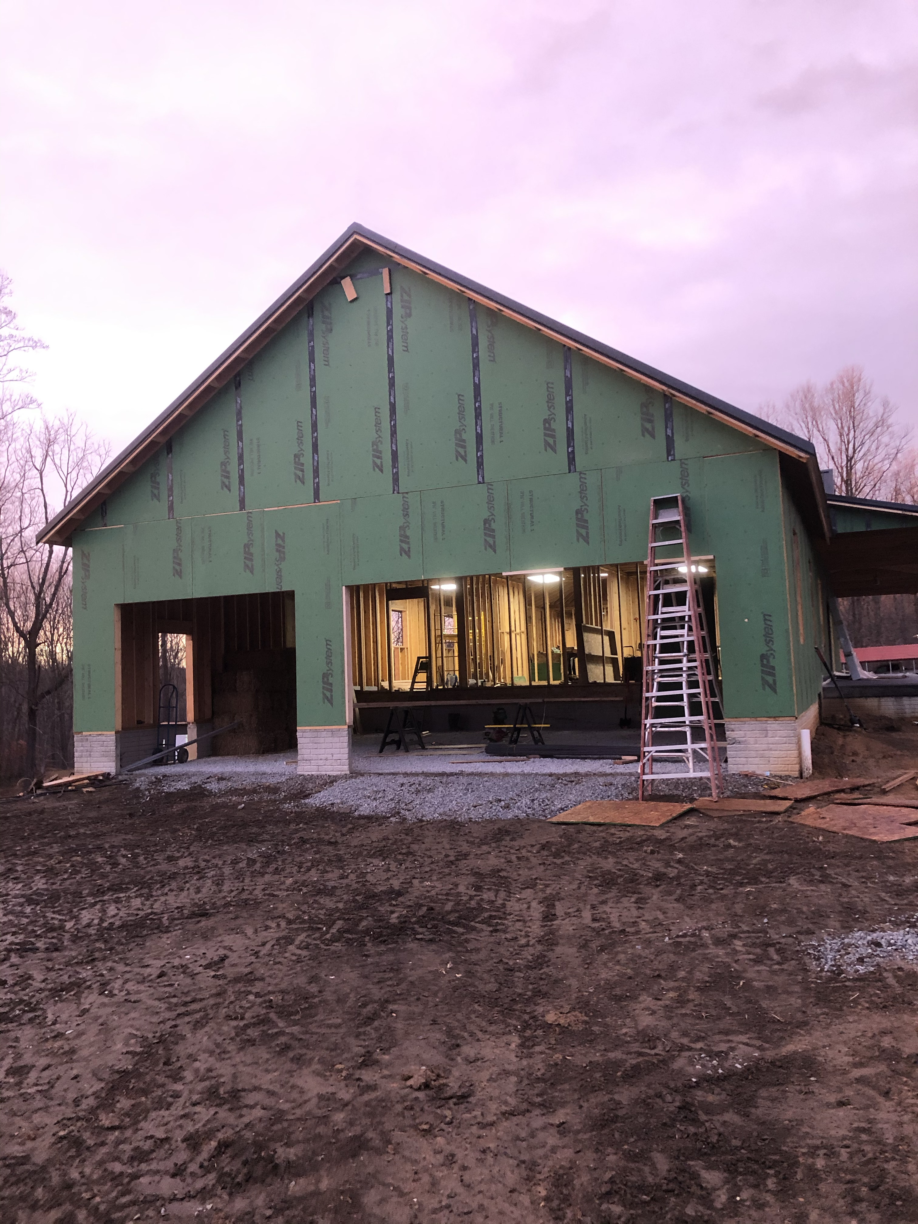

The garage wall is sheeted.

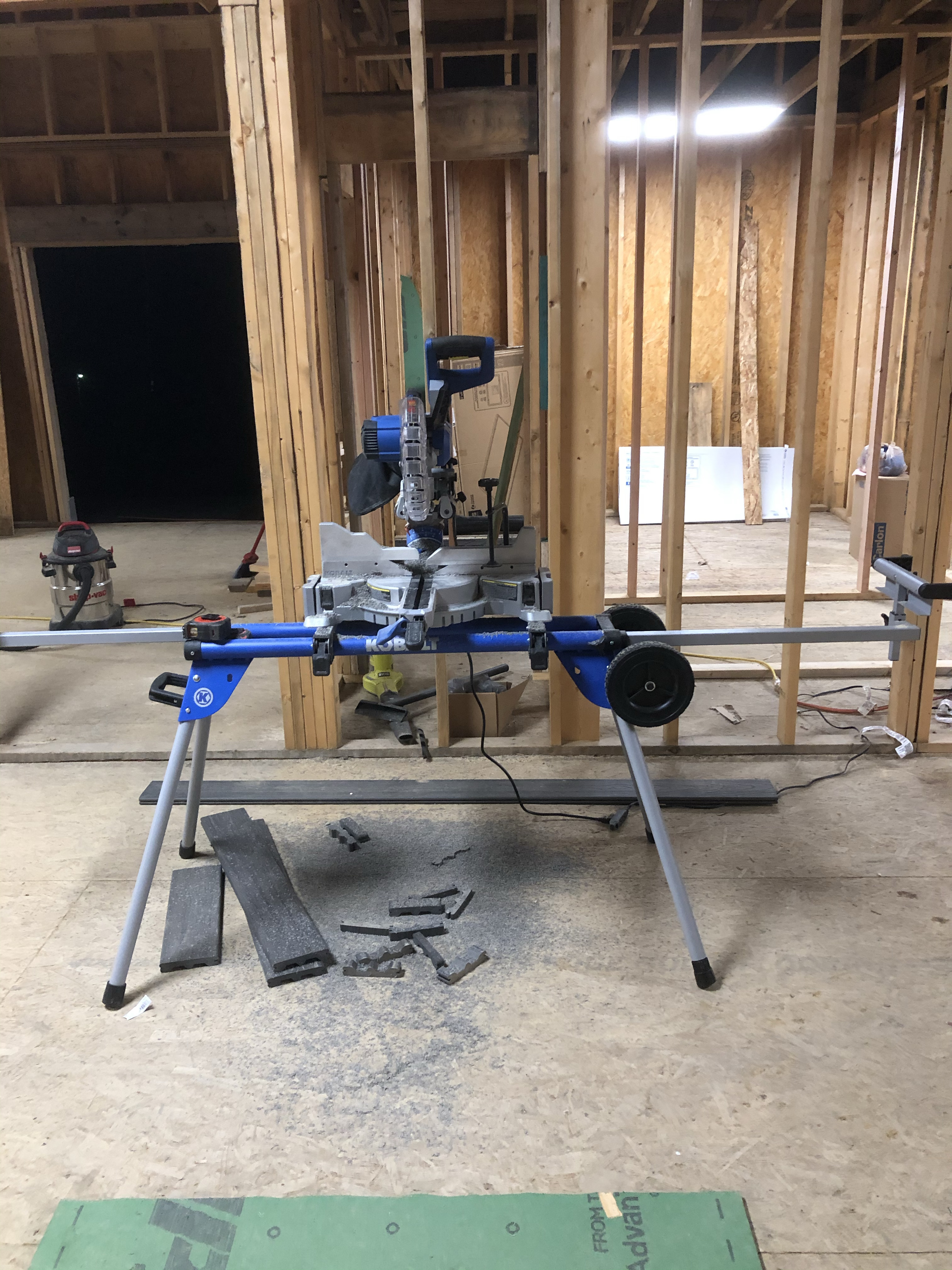

I’ve got all but 6 rows of the composite decking down as well, hopefully I will finish it tomorrow. I bought a sliding miter saw and stand to make cutting the boards easier. A board across to studs makes a nice extension of the stand and really helped with the 16’ boards. I should have bought this setup at the beginning of the build, no more leaning over or using the circular saw for cutting boards.

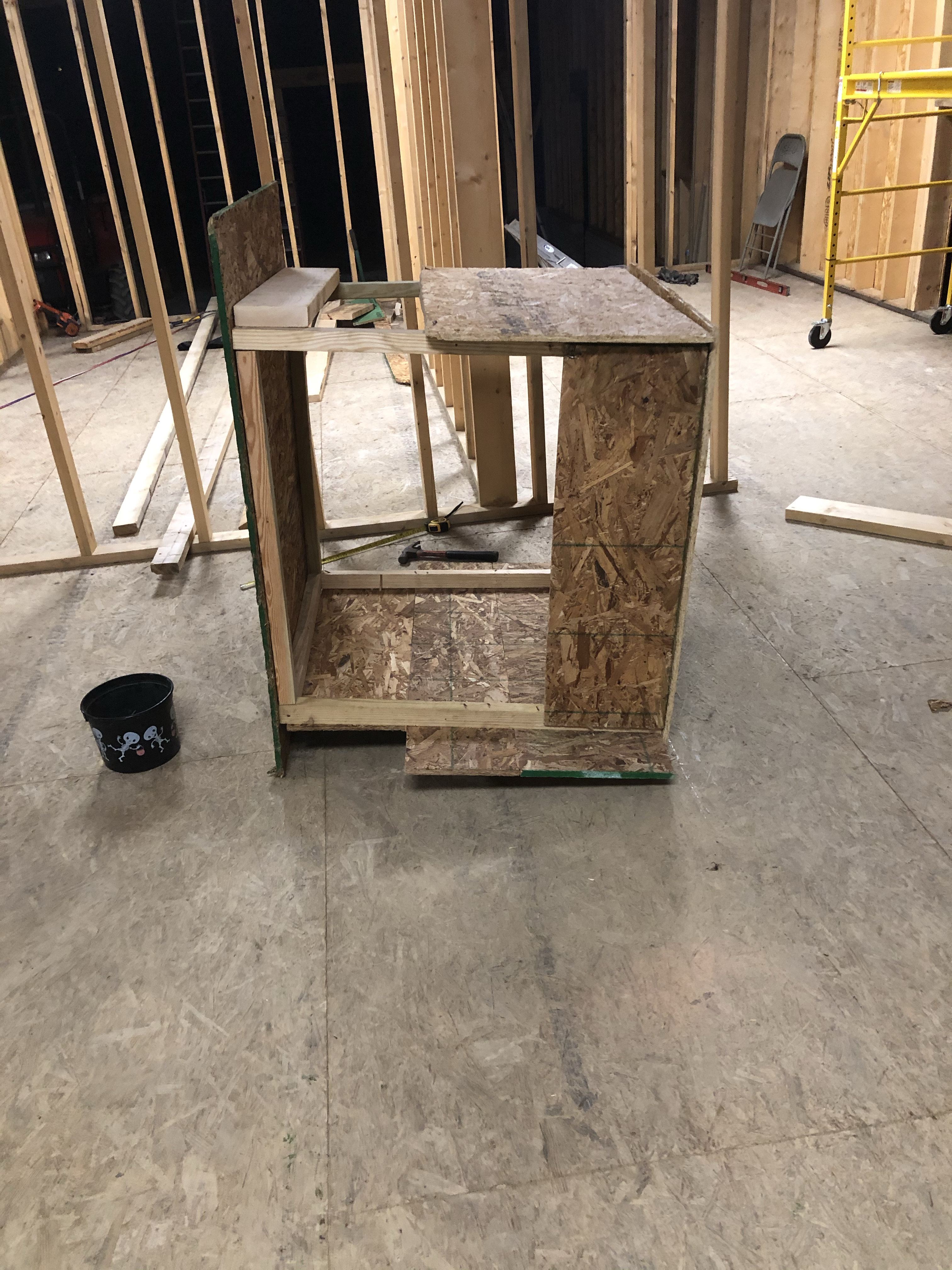

My 7 year old son has been working on a house of his own lately. It gets sturdier every day!

Your 7 yo son's house is priceless. :)
Maybe let him make a fort or treehouse with it?
   / New House Build in WV
#160
He has added to it since the picture. It will at least stay in the basement for him to play with.
He has gotten pretty good with the screw gun!
