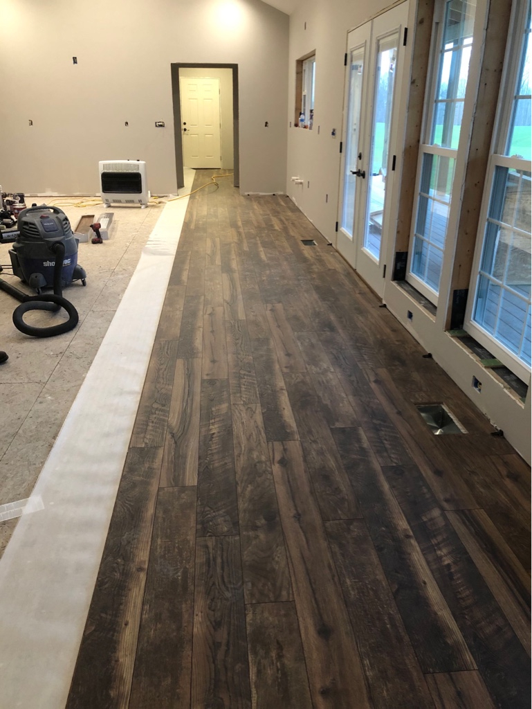

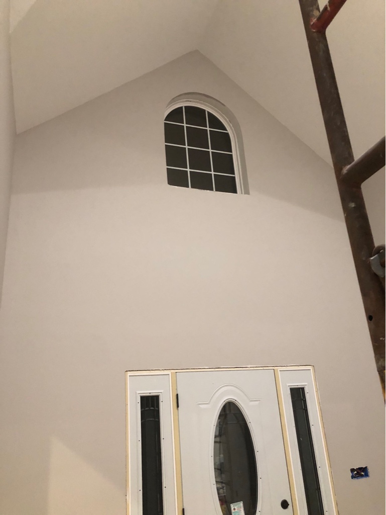

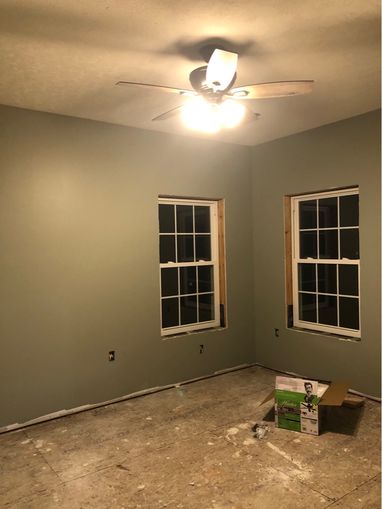

Made good progress the last couple days. Everything is painted except a bathroom, hallway and a couple closets. Wife picked up a few more gallons of paint today, so that’s on tap for tomorrow. Total so far is 20 gallons of primer and 17 gallons of paint, including what was bought today. Not as much as I expected.
I managed to start the flooring this afternoon and it went pretty well, hope to get al lot more done tomorrow.
Also hung several fans and light fixtures. Put a bunch of switches in too, nice to be able to turn breakers on and not have to turn them back off.
Here are a few pics of the progress.

   / New House Build in WV #403
That flooring looks really nice!!!
Thanks, it definitely worked well with the paint color. I was afraid the paint might be a bit grey for it, but it worked out well.

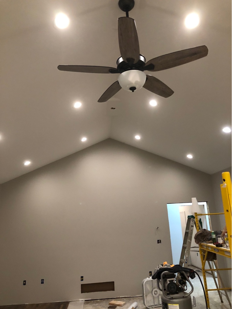

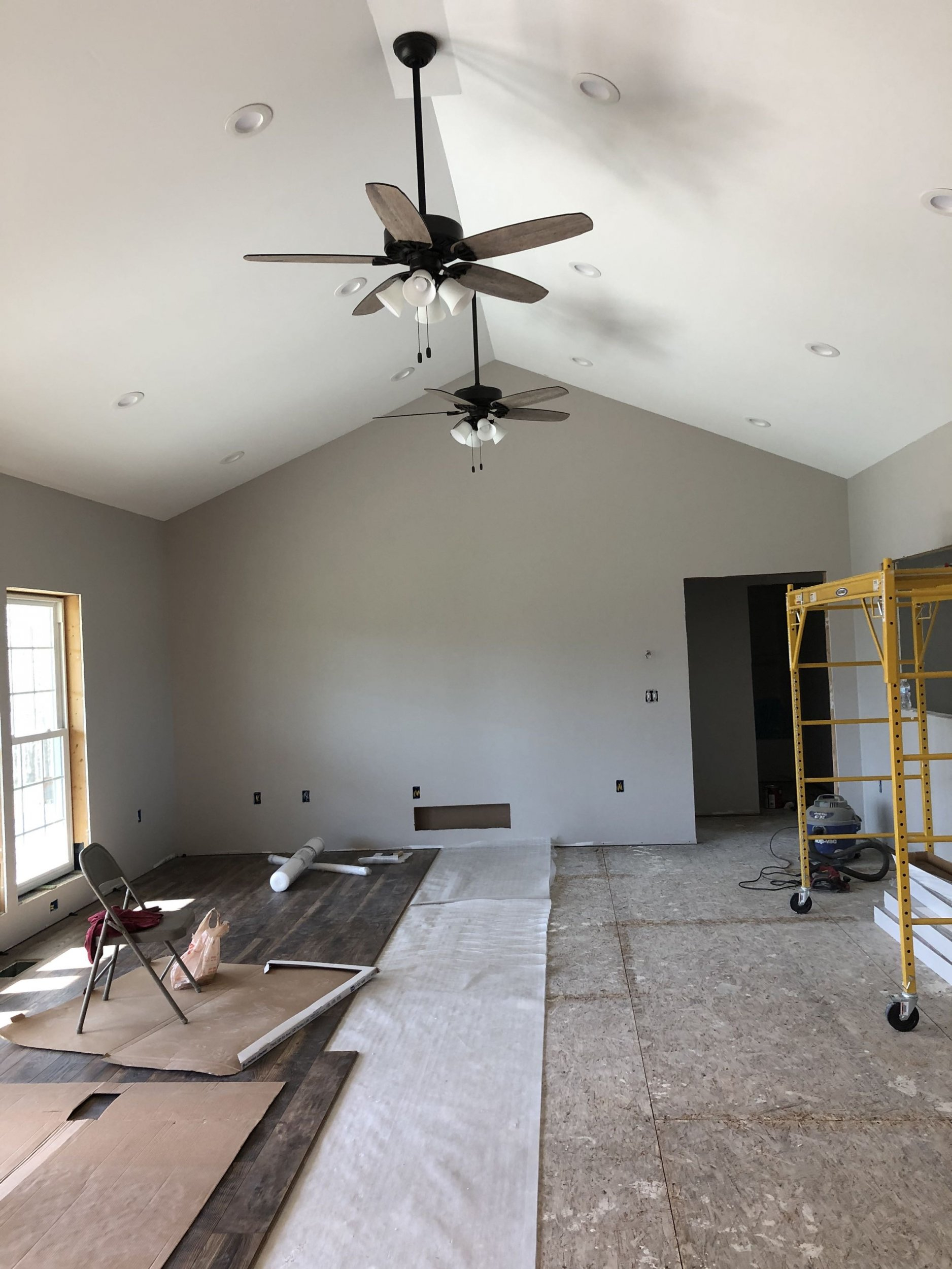

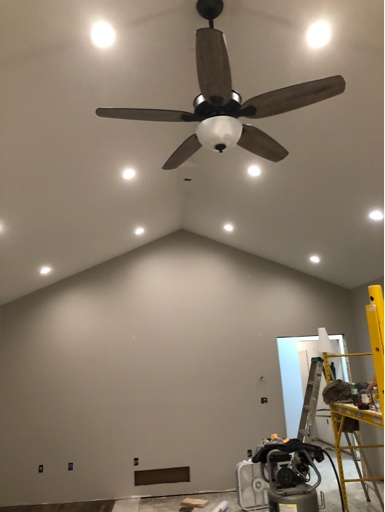

Fought with ceiling fans way too much the last couple days. I hung a second in the living room identical to the one above. These fans have remotes and I’ve never had one with a remote before. They would be nice if you want to operate from only one switch and not have them connected to each other. I wired for the fans to be one one switch and the lights on a 4-way so light could be turned on or off from rack entrance/ exit from the room.
Hooked everything up and the lights went haywire. Flip a switch and one would come, or may be the other, or maybe both. No rhyme or reason and it had me questioning my wiring and testing everything. Turns out, you just can’t connect two remote operated fans and expect them to light up consistently without using the remotes. Also found that these particular fans require the fan to be on for the light to work, even though the lights have a separate lead.
Never seen anything like it and it cost me hours of troubleshooting. Finally just took them down and had the wife return them for regular pull chain models. They work as they should.
Anyways, installed lots of other fixtures, switches and outlets. Finally made more floor progress this evening. And my wife did some more painting. You can see in the picture that I had to plane the subfloor at the edges a bit to flatten it out. Too much time in the weather I guess.
