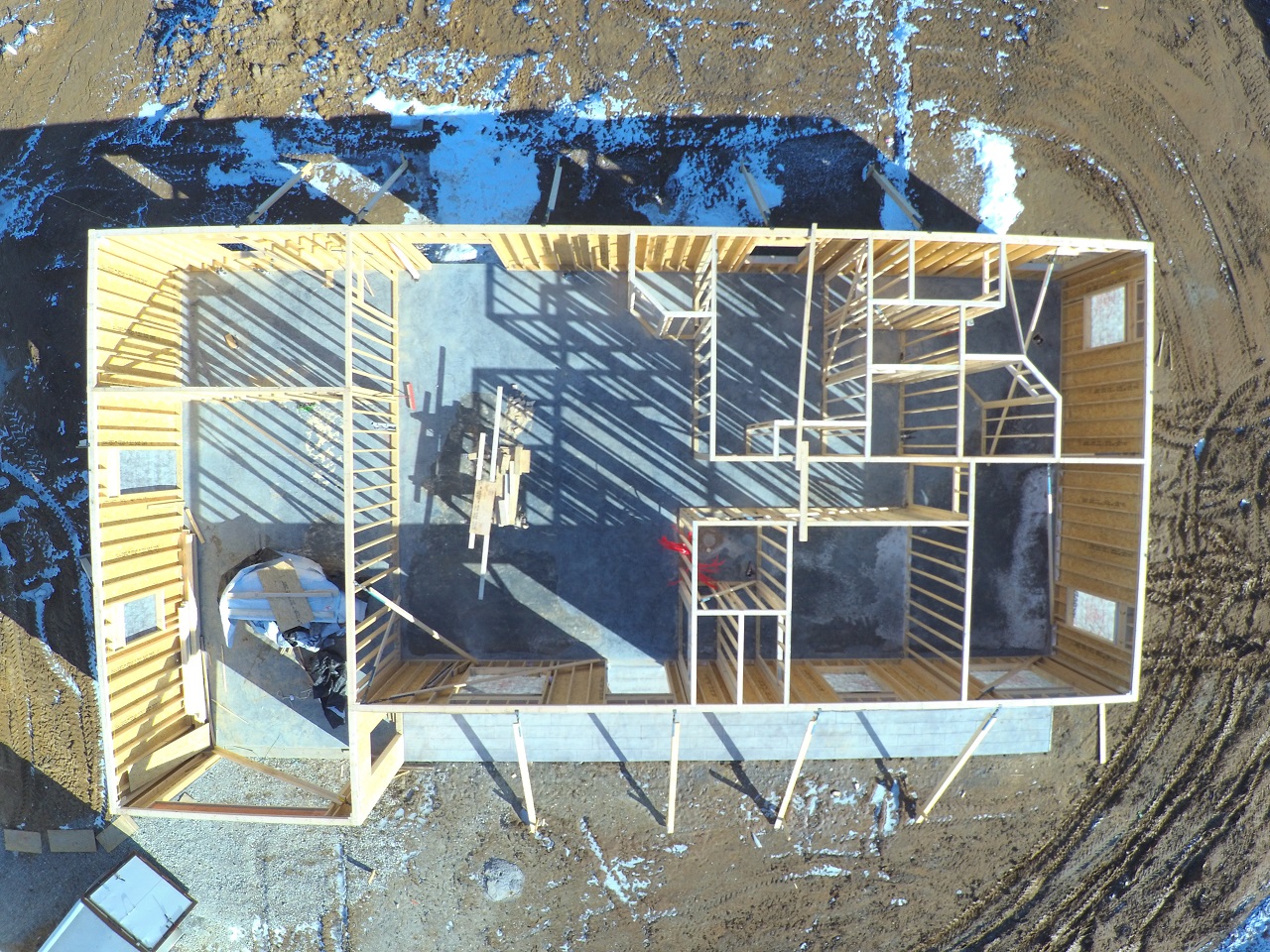

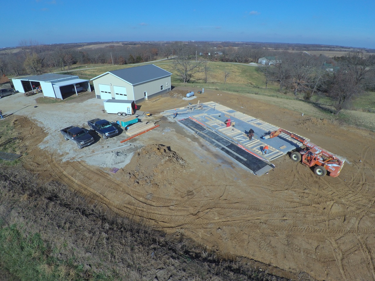

I'll dig thru my drone pics for the best shot of the layout.

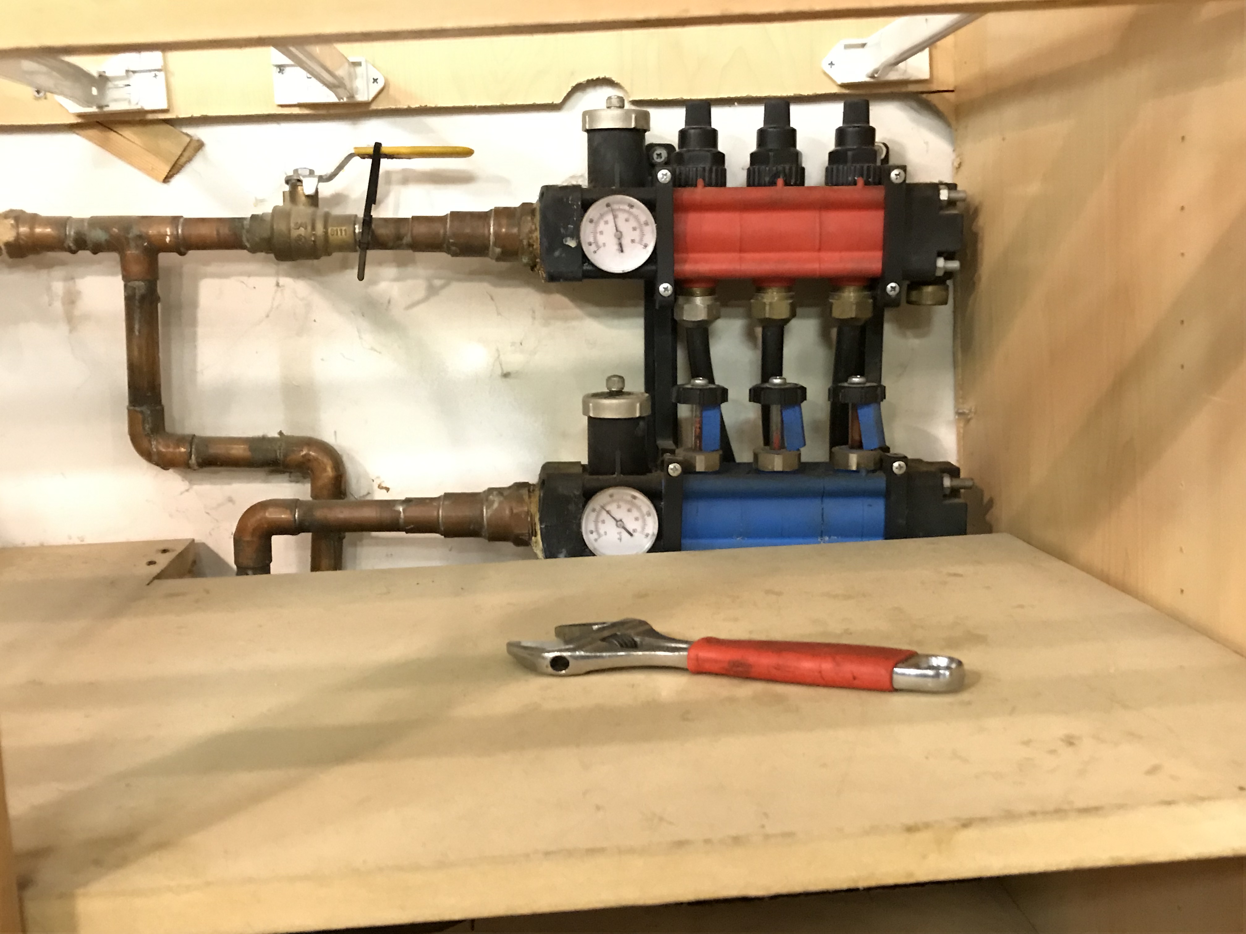

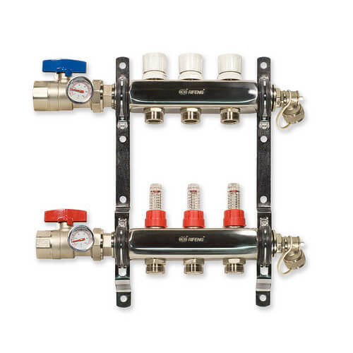

there is a big difference. The above is a radiant floor manifold.
And i did not mean to insult anybody. I can blow smoke up your butt like everybody else. People are complaining that there tankless boilers aren't lasting. There is a more correct way of doing it.
I am not a heating contractor. My son is he went to school for it and is journeymen HVAC tech. I had him look at it. I learned the hard way. We are looking at a tankless boiler for a room we added to the barn. I told him they don't last pointed to the post and he went on to explain. I am going to install it more correctly. I don't care to replace my tankless boiler in 3 years.
Without being able to shut off each loop separately then running water through it you are hoping you can get the air out through the separator over time. There is no why you can have even flow through the loops with your current manifold. The above measures flow in each loop and gives you a way to adjust, so then you know you have it correct. With what you have you are guessing. A tankless boiler does not like air going through it.
How do you get the air out of it if you have to replace the pump? Run the system, which will run the air through the boiler then over time it comes out the separator. Your tankless boiler does not like the air going through it.
I just replaced the manifold in the house garage, 18 years ago I did not bleed it right, there was still air in the system, i have an air sperator. I heard no noise, so for 18 years air has been running around in the system. I however do not have a tankless boiler, on that system.

I've never saw a manifold like that. Is that what you are using? All the systems I've saw use manifolds like mine with or without valves.
If air is trapped in a loop why would only opening that loop for flow fix the problem?
If you have no cavitation problems such as noise or poor flow how would you know there's air in the system?
As for proper flow. I've checked my system twice by IR temp readings on the hot side pex as it goes under the floor. I've got nine loops. They are all within .1F degrees. The return loop temps will vary 1.5F degrees.
Having valves to adjust flow thru each loop sounds like a good idea. How would I know what adjustments to make?
How did you decide you had air in your system for 18 years?
Do you have your water system hooked live to you radiant circuit? How much pressure?

The one in the house garage looks like this:
We will be replacing it with the one pictured above. On the top of the manifold those are plastic caps that screw down onto a poppet valve. you tighten the cap it opens the valve. On the bottom(supply) those are flow indicators, glass tube with a ball in it. When the flow increase ball moves up in the tube indicating increase in flow. So, if you restrict the return side poppet it that would decrees the flow. You would then set the flow the same all the way across. The manifold above is used in a closed system that has antifreeze in the system. It was filled with hard rust filled water 18 years ago. At Thanksgiving the kid noticed that the floor was not the same, warm and cold spots, so we went looking.
In my garage system it could be piped more correct. The manifold you are looking at is 60 ft from the buffer tank and pump and that is also where the air separator. So when we filled it originally we did it very similar to how you did it. Connected a garden hose filled it till water came out and started it up. One of the most common reason a loop is not heating is trapped air. So we hooked a transfer pump up, one end in bucket other on the loop, then hose from other side of the loop back to the bucket. Air came out into the bucket. On first start up some is to be expected. So how you bleed it is with the transfer pump running you close the other poppets(loosen the caps closing all but one). When we did that to one of the three we got more air. On the third poppet, it would not close. So since we could not close each one we could not correctly bleed it. We figure the dirt in the system is keeping the valve from closing. Also one of the flow indicators is broken. We are going to replace it. Add a pressure gauge, which it should have and add a purge t. Our thinking is it may have never been right. The kid seems to think that is possible, because he has seen it and I did not bleed it right when we put it in 18 years ago.
We fould it by temp difference in the floor then feeling the supplies and returns.
Don't know if an IR temp gauge is going to be that accurate. If you want to measure temp like that they make a clamp on temp probe for your fluke. Also it is more about flow. Hence the flow indicators. You may very well be close. Once we saw your current manifold it sent up flags.
Close or open the poppets until they are the same. They also make a coil for that, replacing that cap, allowing you to zone each loop. I did not use that Kid has seen it. Then with ECM pump you could zone all day long.
See above and if when I am done bleeding it and I can make the flow even across the manifold, then I will know for sure. I am also hoping that it it as that is the easier solution...
Not on the one I am talking about above. The kid and are are still discussing that one, because you probably should. Which is why we are adding the gauge. Also we did not see one on yours, but your boiler may have one. I want to say you should have 12 psi. I will double check and if it is NOT 12 I will get back.

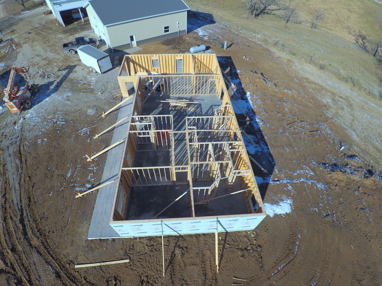

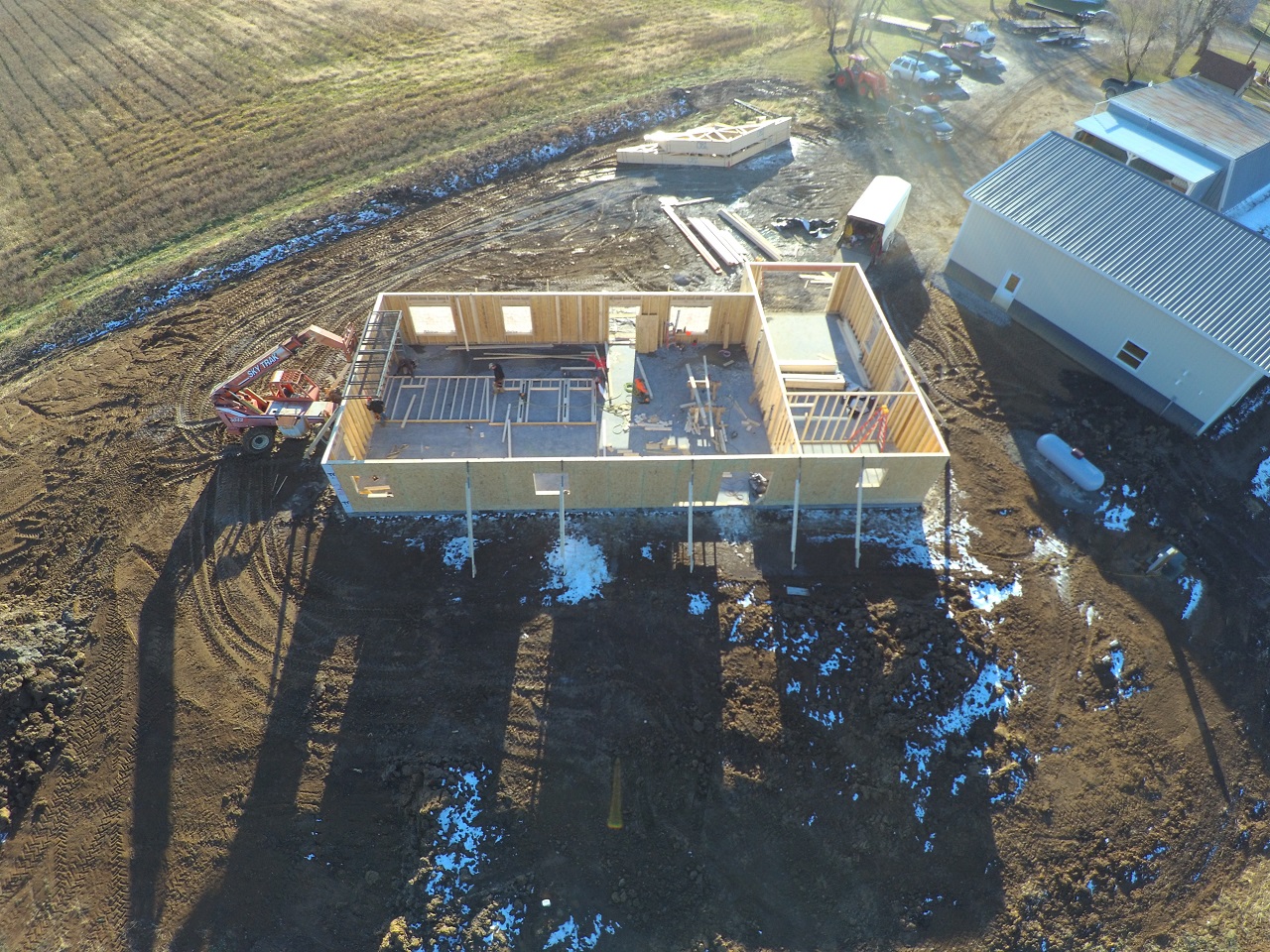

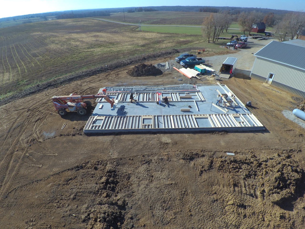

Forgot how far behind I am on this project. So, I'll try to catch up a little..... Sorry.....
On the 15th of November the builders showed up and started laying out walls. Had a lot of weather delays. November was the coldest on record here this year. They worked on a few days when I couldn't have. I spent a lot of time watching from the warm shop window.
Here's a series of pics of wall construction.
