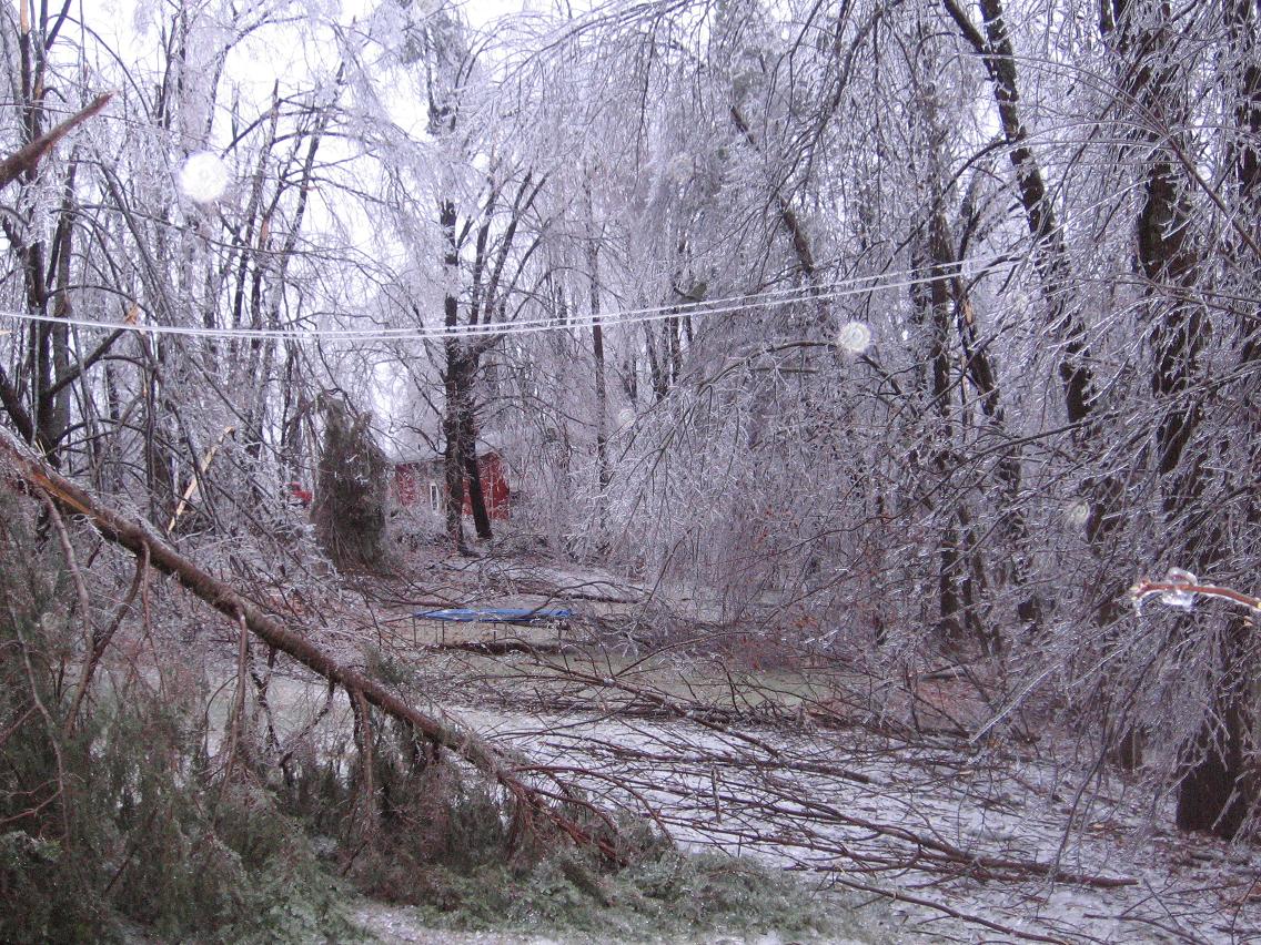

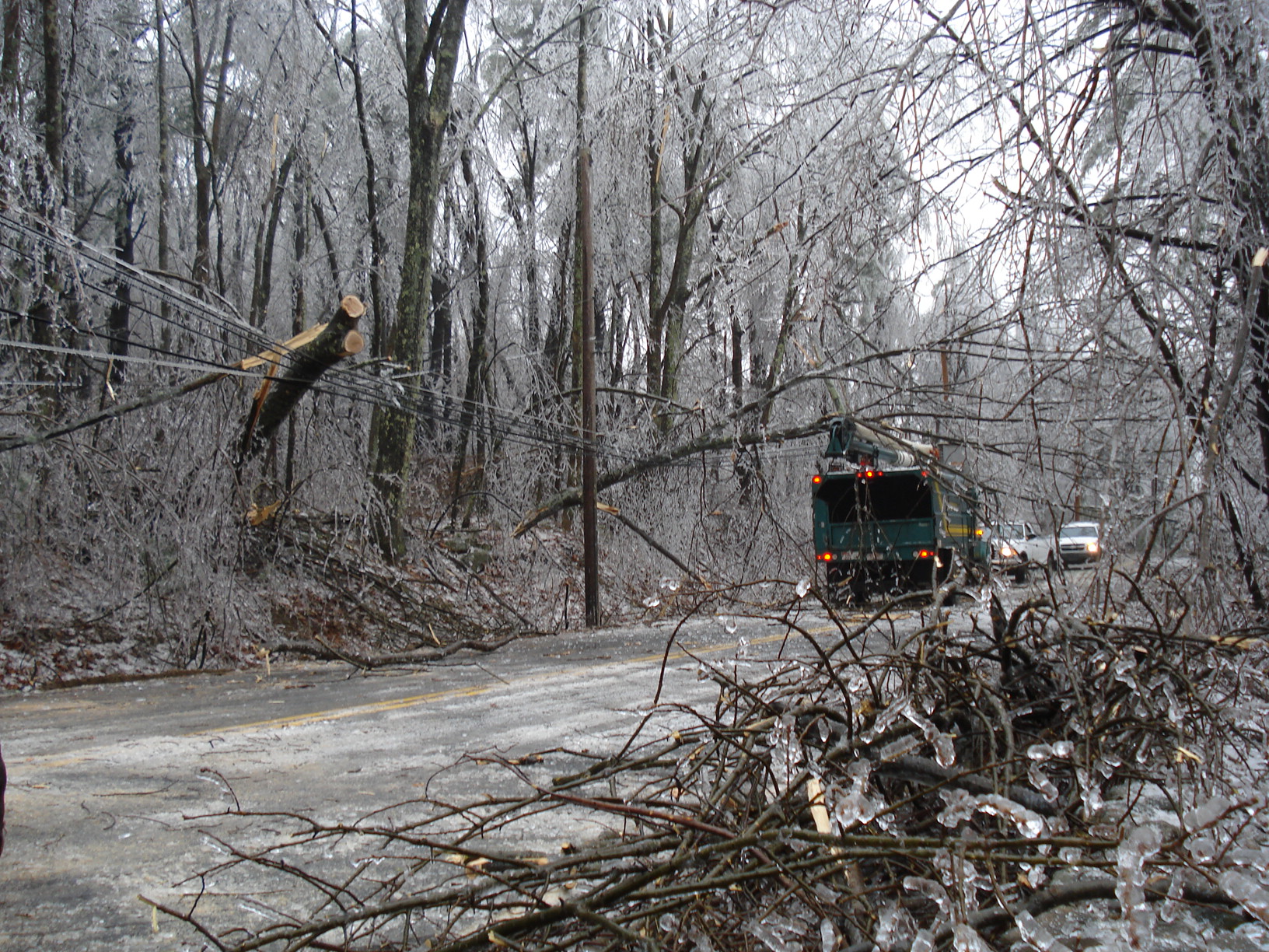

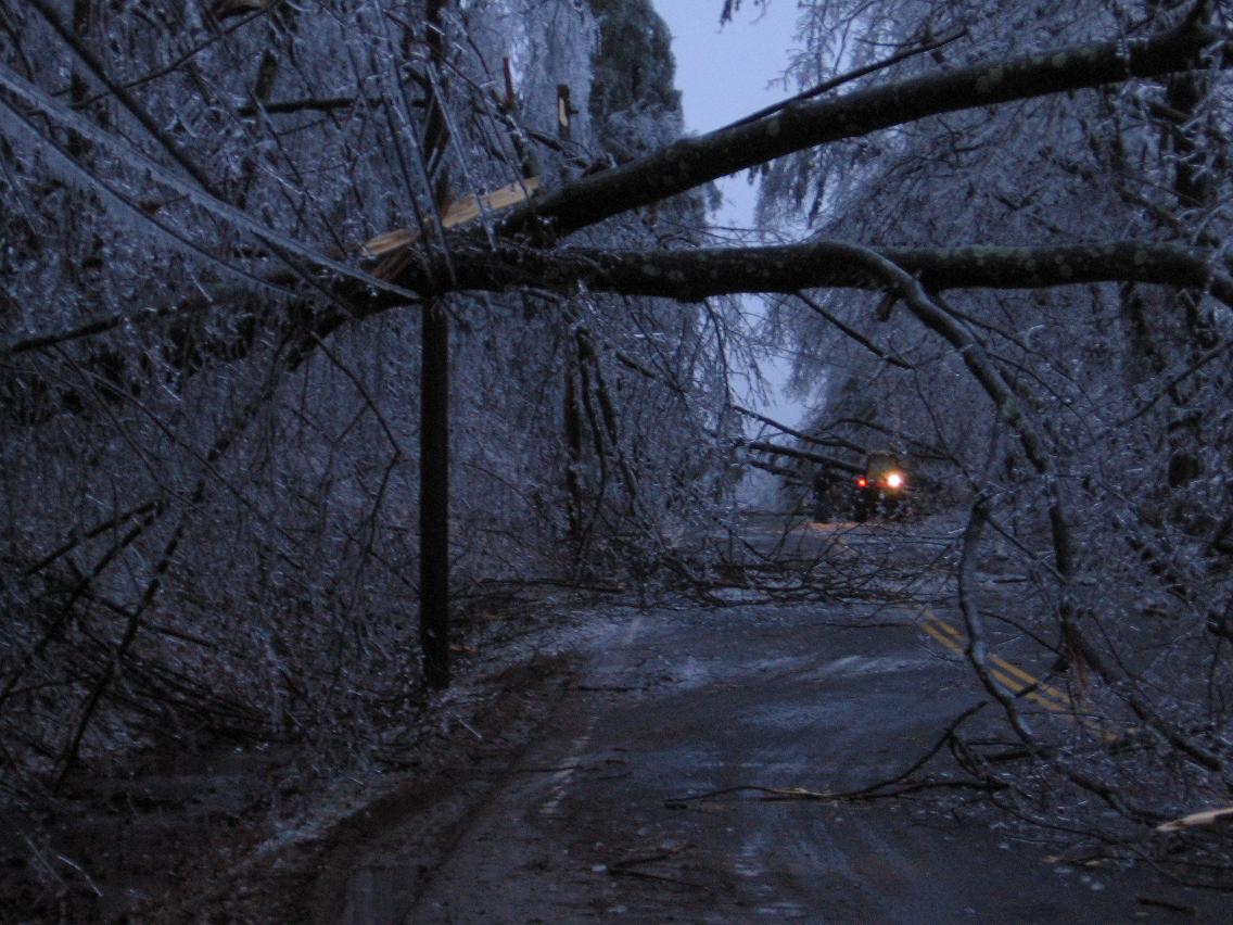

Did it look like this mess? This was our ice storm of 2008. It wiped out our 36 acre woodlot, our back yard and the trees on our farm next door. The picture with the tree sitting on top of the tree truck is funny. They had just stopped when the tree fell on their truck. The tree you see cut down in the foreground that is on the wires was removed by me about and hour before this picture was taken. I cut that while standing in the bucket of my tractor. I was trying to open up our road. We lost out power for almost a week.
