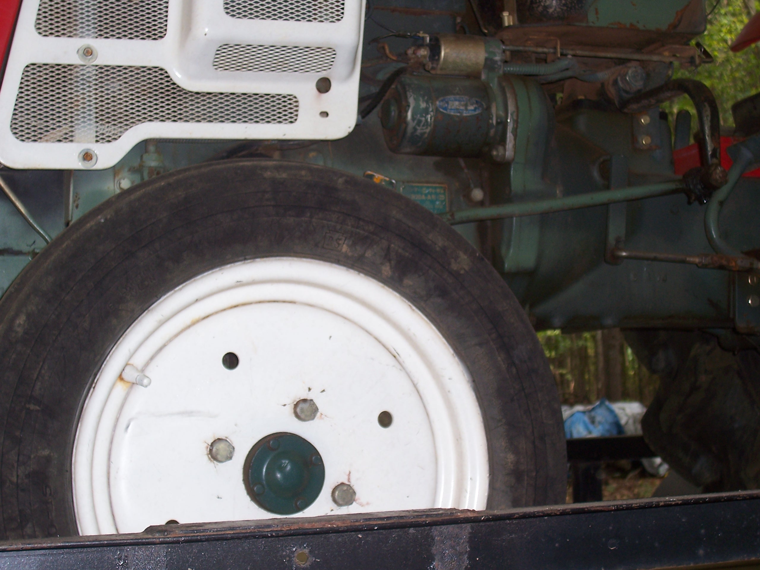

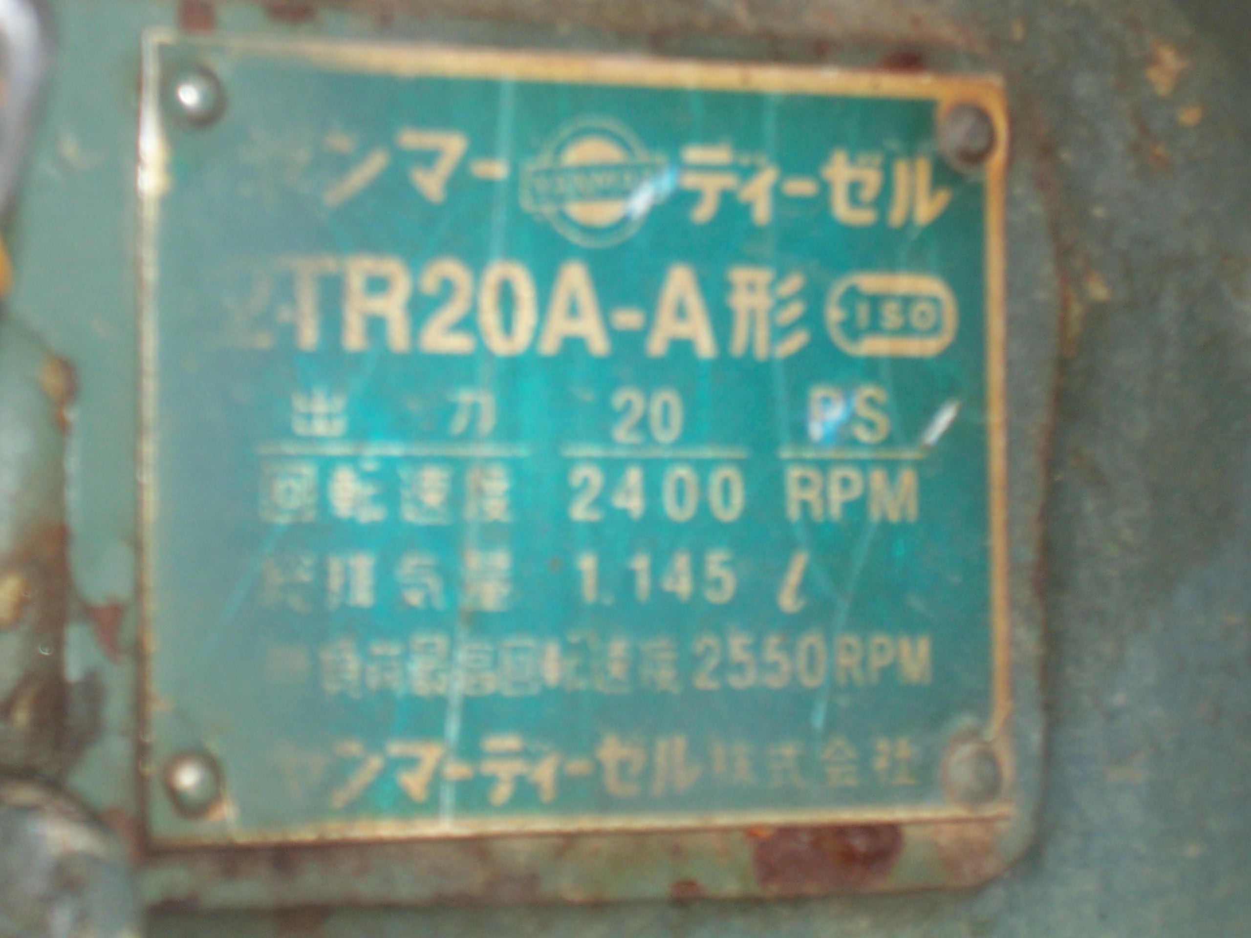

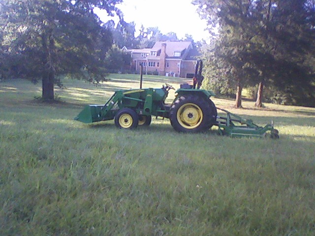

Mine's a import with the same HD. Adj. Axle and HD. Front Hubs that have 4 bolts on the cap. "NO Numbers or marking on the Pump" But I have on the Model Decal T2R20A-A. I have only heard of "1" and have yet found or heard of Anyone that Knows What the -A stands for. With nothing on the Hyd. Pump probly rules that out for Loader ready. I also have access to a JD.5103 to use if a FEL. may be needed. But Knowing what It's capable of doing at 55Hp. the little YM 2000 will is basicly stay as my Lawn Mower and BH. and occasionaly use it to grade my gravel Dr. Which I can Bog and get Stuck easily with Crush and Run. It's Org. never been Refurbished. I left Steve a Check for it until I was able to get back and pick it up! :D

... Model Decal T2R20A-A. I have only heard of "1" and have yet found or heard of Anyone that Knows What the -A stands for.
I've seen the -A at the local VN import wholesaler. (Long closed). My YM240 engine tag is T2R20A-X. Maybe X is 'export'?
There were minor updates to YM240 engine when they went from green to red sheet metal paint, and maybe at another update too. For one thing the dipstick is on the opposite side of the early ones. I expect your -A is the final Japan-market update.
   / New hydraulic pump, new fluid, lift is veeeery slow. #20
No doubt it's there for a reason. My guess A- American and for X- X-out and had enough. :laughing:
