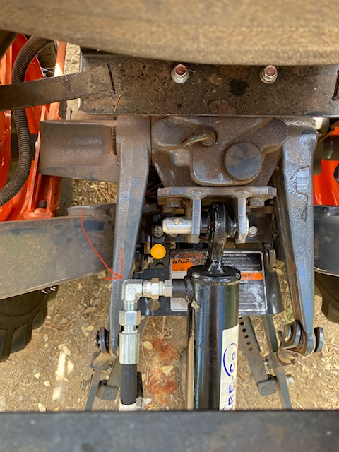

I recently purchased a hydraulic top link for my Kubota B2301 and when I connect it all up the hydraulic hose fittings won't clear the lift arms of the 3-point hitch. I.e. when you raise the lift arms they collide with the outer edge of the 90 degree elbow:
Any suggestions? Is there a way to make this top link fit? It seems like the top link and fittings were designed with a larger tractor in mind...

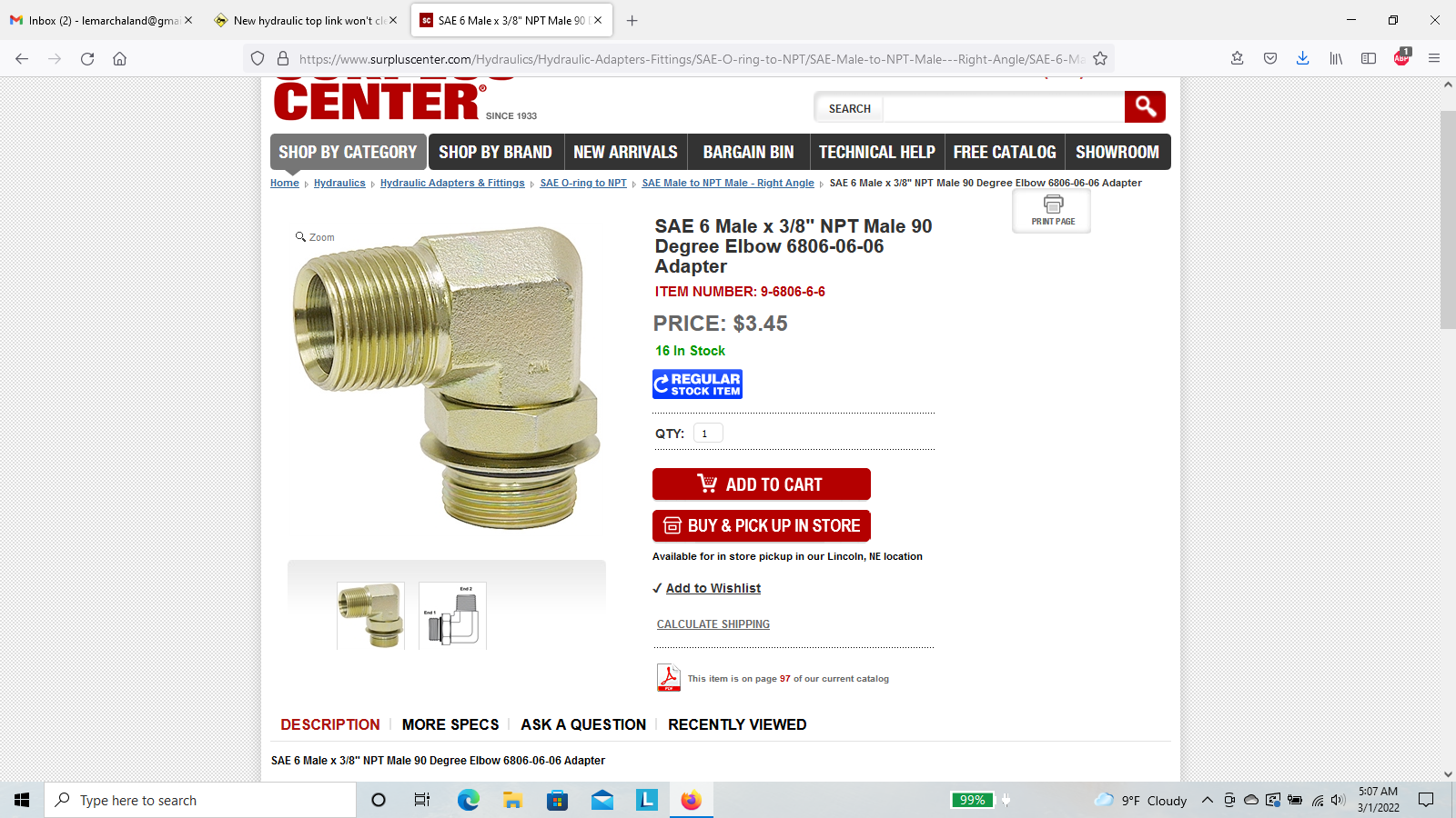

Flip it! New Holland Workmaster 50 is same way. Also your connectors extend away from link too far. They make right angle connections that put hoses closer to link. Will attach pic if you need my set up.

Looks like you need a male to make right angle fittings instead of the multiple fittings coming off the cylinder
