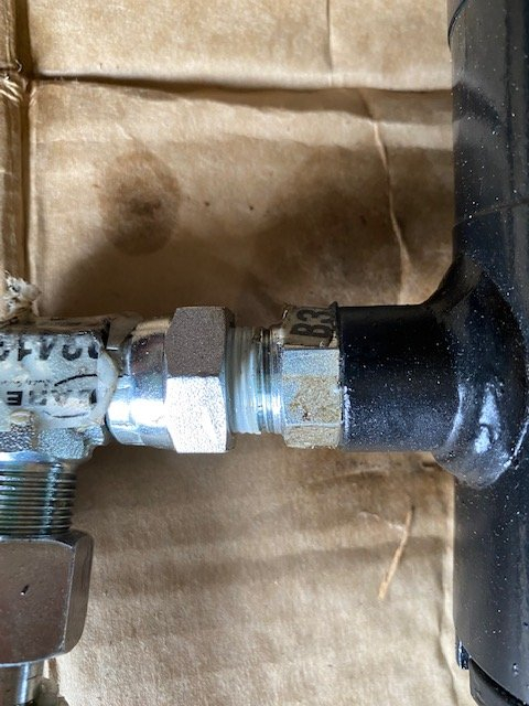

New hydraulic top link won't clear the lift arms on my B-series

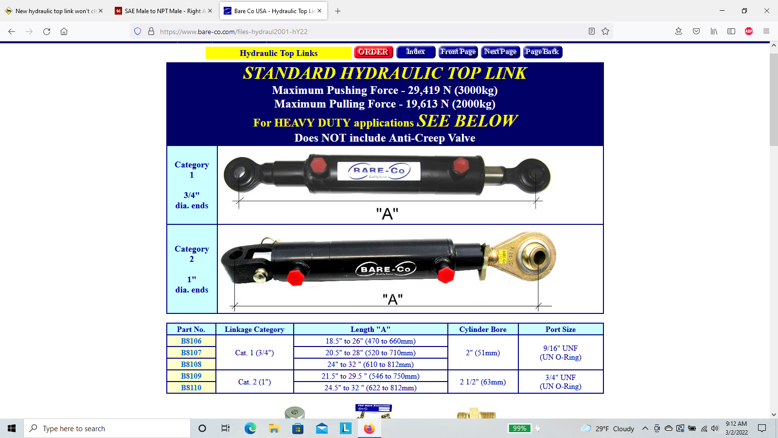

OK, looking closely at the OP's first pic;
The fitting port size is 9/16" UNF
this should be a 9/16 fine thread if using a bolt to verify,
also called an SAE -6 or a -06
just guessing as the hose kit doesn't say what size they are;

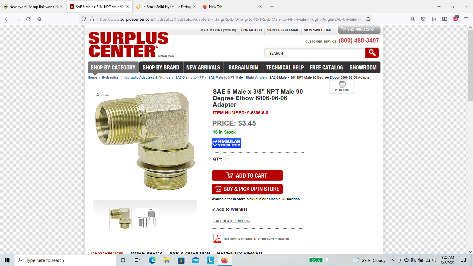

A -06 male X 3/8" male npt might be the correct fitting,
SAE 6 Male x 3/8" NPT Male 90 Degree Elbow 6806-06-06 Adapter​

The 90* fitting works for his application, I do this all the time. He will need to keep his anti sway links snugged up though.

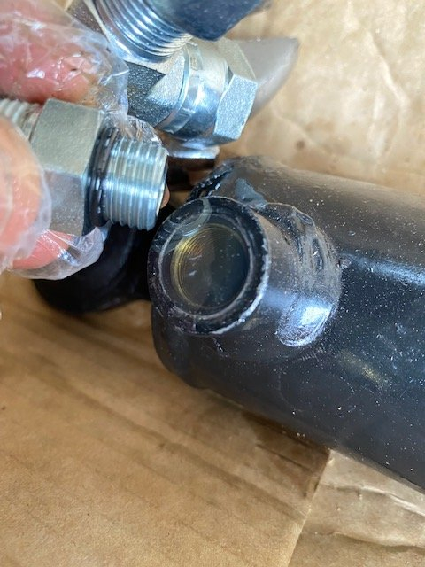

LouNY yes you're right you tracked down the top link I have! I've circled the fittings from the hose kit which go directly into the port on the top link.
As you can see it has a rubber o ring on the 9/16 UNF end, which pushes into the tapered part of the female port:
So when screwed all the way in looks like this:
The other end of the elbow is 3/8" BSPT.
So I gather the elbow I am looking for is one which has "9/16 UNF" (AKA "SAE -6" or "-06") on one end, and 3/8" BSPT on the other? Do I need to specify anything extra to ensure that it comes with the rubber o-ring as well (assuming it is necessary)?

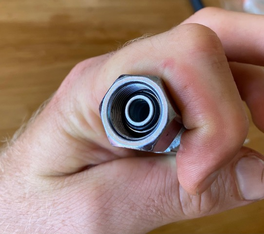

A side question someone might be able to help with...since we are talking hydraulic fittings. I've googled high and low and can't work it out. It turns out the hoses supplied with the top link have BSP (parallel thread) fittings on each end. For some reason, all of the fittings supplied with the hose are BSPT (tapered thread). I would have thought the fittings would need to be parallel thread (BSP) fittings too, so that they can be freely screwed all the way into the female BSP fitting on the hose and press down on the o-ring (see photo below) to create a tight seal. I raised this with the dealer and they assured me they are compatible, yet to my lay-man mind I cannot see how they would seal tightly.
