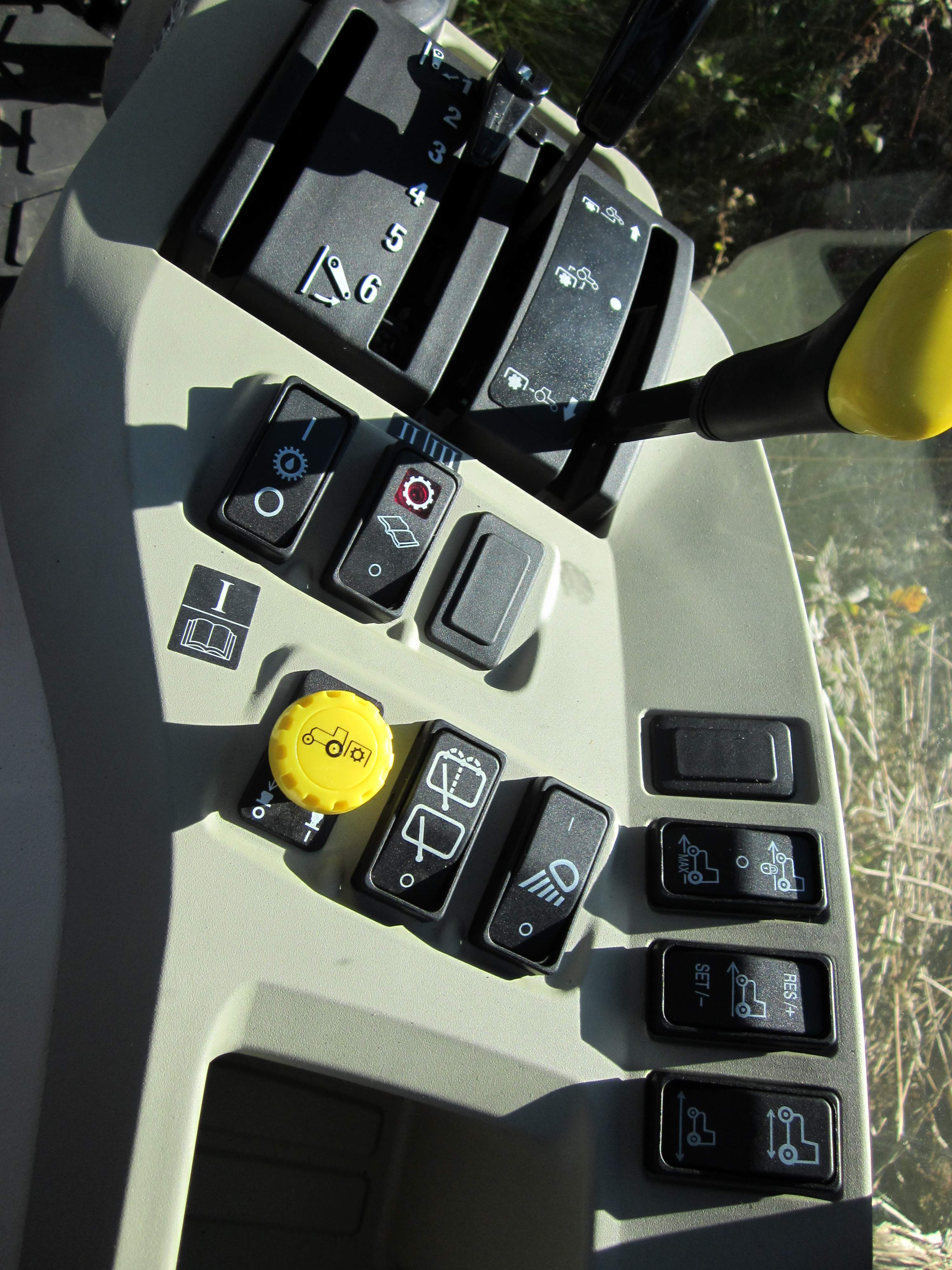

Here's a photo of the switch panel. To activate the hydraulics for the TNT, you turn on the switch labelled in Roman numerals II/III, the one with an image of a gear and a book on it! It sounds ridiculous when I put it like that, but the icons actually make perfect sense once you get used to them. Once the switch is activated, the loader joystick controls the TNT instead of the loader.
Edit: I just added a Frontier AV20H root grapple to my collection. Photos anon, but for now it's worth mentioning that the switch in this photo labelled with Roman numeral I activates the hydraulic circuit for the "thumb" on the grapple. The switch resets whenever the ignition is turned off, presumably for safety. Once the switch is toggled on, the little grey control pad in the main joystick controls the thumb. It's easy to use in practice. The hydraulic hoses are very long and have to go from the rear of the tractor to the very front. I had them snag on brush a few times, both around the grapple itself and also under the tractor. I replaced the dealer-installed hose clips as they broke and made slight adjustments to the routing. So far, so good. When I change back to the bucket (very easy to do) the hydraulic hoses remain and are a bit of a nuisance. I could remove and reroute them each time but it would be a hassle. One last thought - I found out the hard way that the hoses for the thumb cannot be reconnected if there is pressure in the lines (doh) and the easiest way to relieve pressure is to open a T-handle valve behind the cab. It's right there in the manual - who knew? :)
