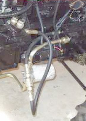

John,
Does the filter actually stick out that far? I have ordered the conversion kit but the way it looks to me I might stand a chance of ripping it off on something!

</font><font color="blue" class="small">( Does the filter actually stick out that far? )</font>
I cropped and clarified the part that I think concerns you, and it's not as bad as it looked. If the QD hoses were tied up out of the way, I don't actually think the external filter assembly sticks out all that much farther than did the original rigid pipe position.
Ugly, but effective - I guess that's what counts.

Wayne,
It is hard to tell from the pictures. Given the bend in the pipe before it enters the hyd pump, I'd say its does stick out. Once you put a fel on, it is probably not that bad. PM or email me. I'd like to know the total parts ordered (4?), and cost. Thanks.
