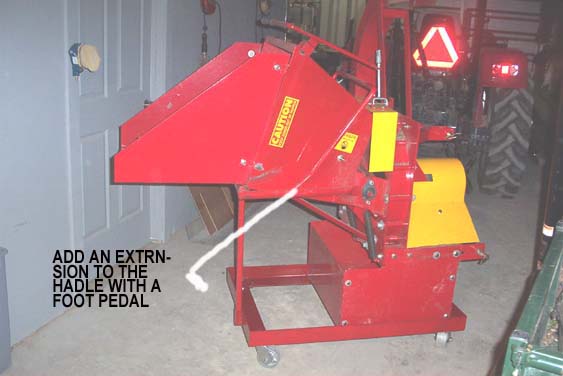

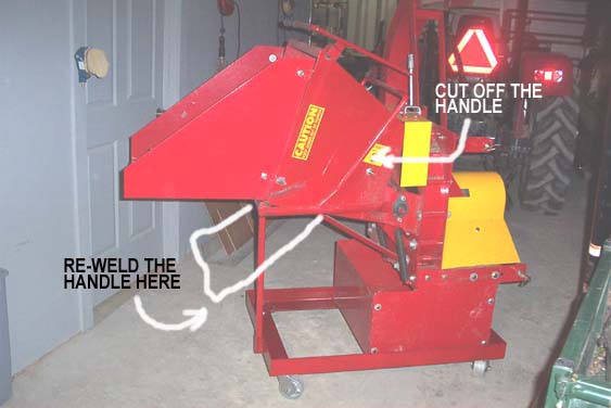

I've read the thread on Stop the Burn and there were several mentions of making a mod that would allow foot operated feed release. What I have not found was either a description or pictures of this mod.
Can anyone describe this mod or steer me in the right direction as to this mod ?

If you weld you can try what one fellow said he did. I can't remember where I read it, but he cut off the feed roller handle and rewelded it on the underside. Sounds good to me, but I like having the handle there to grab by hand, if needed. I attached a picture (PIC 1) to try and illustrate what it would look like.
My plan is to add a foot pedal to mine as shown in PIC 2. When I get it done, I'll post pics and let you know how it works. I think this one can be done even if you don't weld. It can be built by a welder and then bolted on.
By the way the pics also show the dolly that I built for mine. Don't remember if that was posted to the "Stop the burn" thread.

Thanks for the pictures. I'm having a problem visualizing the setup for pic 2 at this time, but once I have the chipper here, it may become clearer.
I like your stand for it. One question though, how is the support arm supporting the chute assembly. Is there a cross arm on top ?
Can you post some pictures of the support stand. I am intrested in building one myself.
And yes, I have both a head stone and mig welder, so fabing won't be an issue.
Peter
