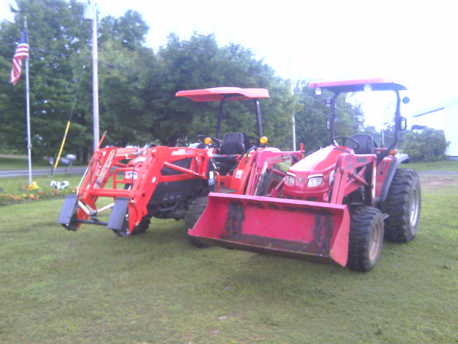

Welcome to the kioti family! Congrats on the new tractor! Well at least so you say. No Pictures, well no tractor:laughing: :laughing: :laughing: I doesn't get any better than a new tractor in my opinion. Keep us updated. Heres a pic of my new Kioti and my Mahindra. My 2 bestest friends and hired hands! .. . John
