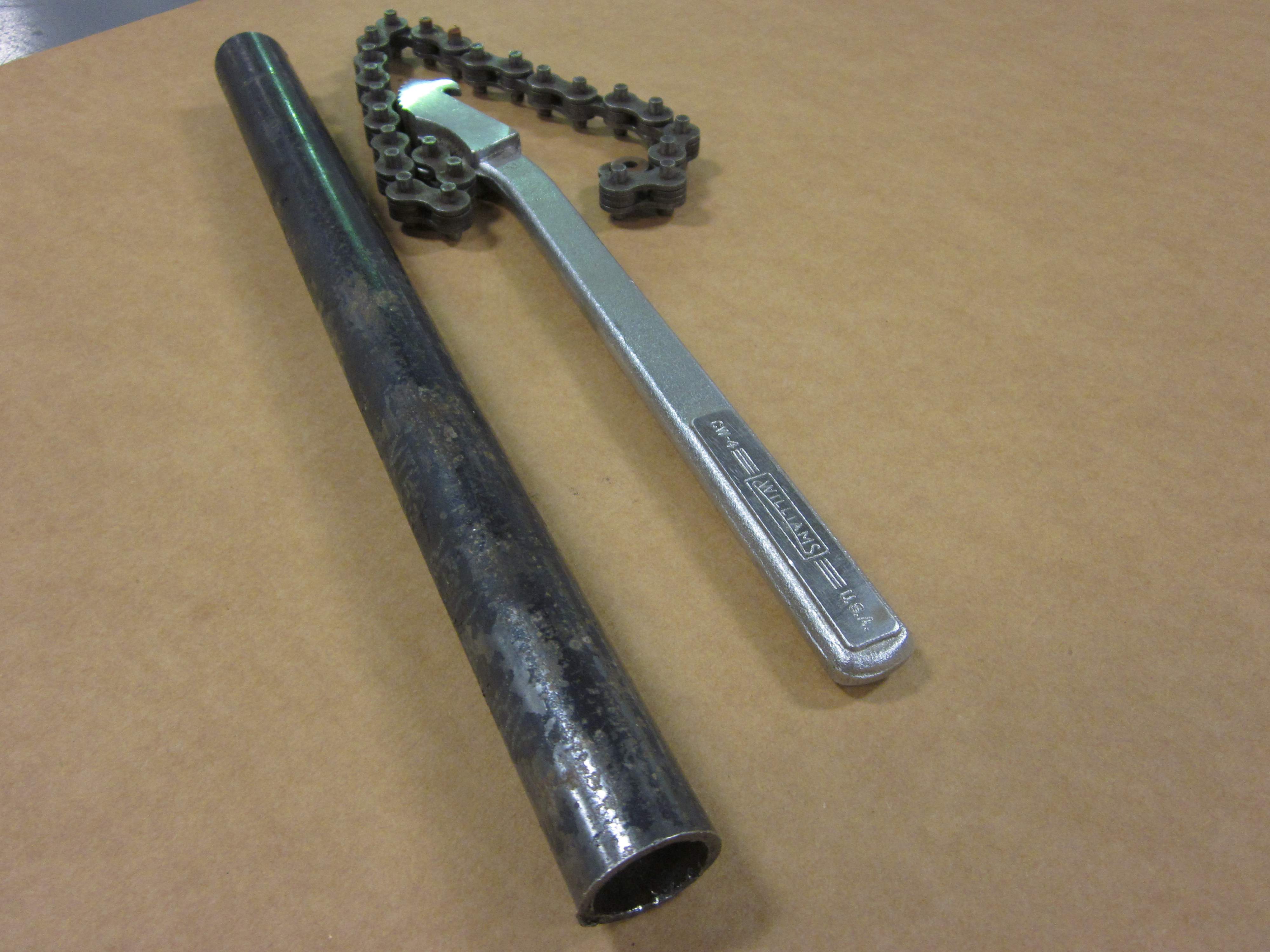

This is the ONLY thing that got my hydraulic filter off and that was after numerous tries of various strap wrenches over two weeks or so, along with borrowing a large, stronger friend who barely got it off on his second or third try. Crescent CW15 15-Inch Chain Wrench - Adjustable Wrenches - Amazon.com
If the rear wheel had been removed, it would have been easier. However, no way that was going to happen. At my 50 hour mark I changed all lubricants and filters as they are relatively inexpensive insurance. My magnetic hydraulic oil drain plugs had large piles of gunk stuck to them.

Thanks sdef! That's exactly the info I needed...I'm ordering it right now through Amazon. Hopefully like MoKelly said, maybe I won't have too much of a problem but at least I'll show up with a proven wrench, along with a cheater pipe.:)

You are welcome. This was a very trying process for me. The filter is strongest at the bottom, by the closed end, so get your grip there. Kioti is known for having a gorilla tighten this filter, along with the hand throttle assembly.

Before I logged into Amazon I went to a guy where I work who has a lot of tools and I lucked out. He's loaning me his chain wrench that looks just like the one sdef recommended. Williams WC-4. And a cheater pipe for extra leverage. Let's see if I can post a photo for those seeking out the same info as me.

I think you'll only need that chain wrench for the first time. My first removal was hard but after that, a rubber strap wrench works fine. Enjoy the new toy!

True, you are not going to put that filter back on like the big ole gorrilla did at the factory. I wonder what they pay him.:)

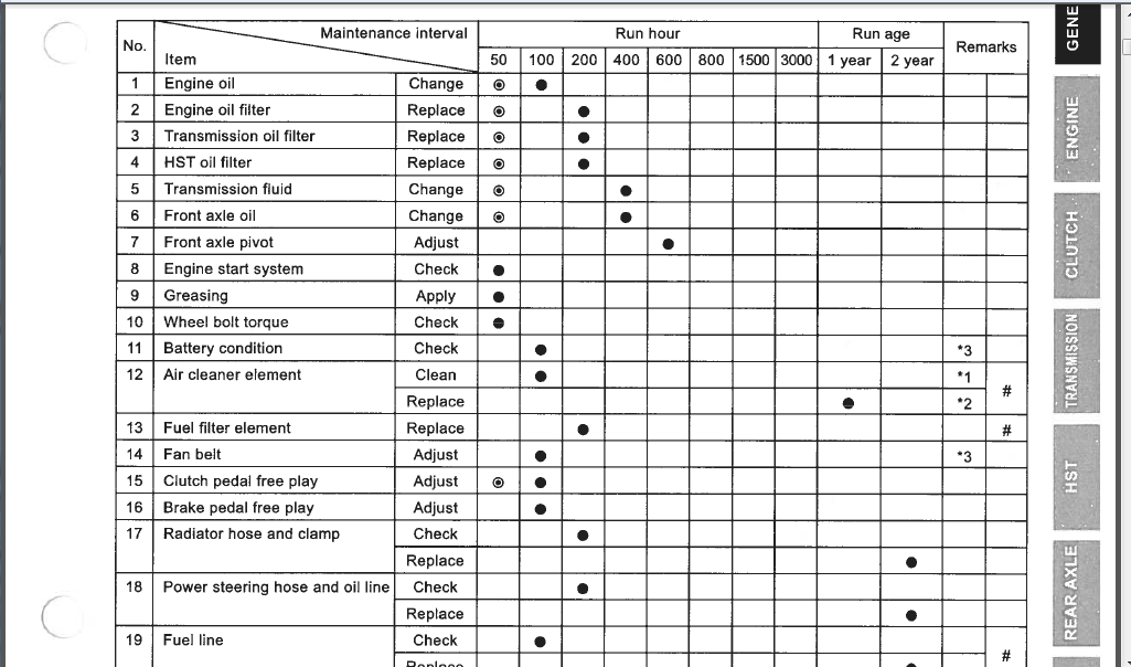

I haven't reached 50 hours yet so no maintenance done. But I do have a question about the schedule I have for a nice TBN'er (online manuel).
For instance on line 1 it says engine oil get's change first at 50 hours. Then it has a star in the 100 hour block. I assume it means it's every 100 following. Same with the engine oil filter, first time is at 50 hours and then at 200 hours and I assume every 200 hours after that. Typically with a car or bike the oil filter get's changed with the oil, right?
