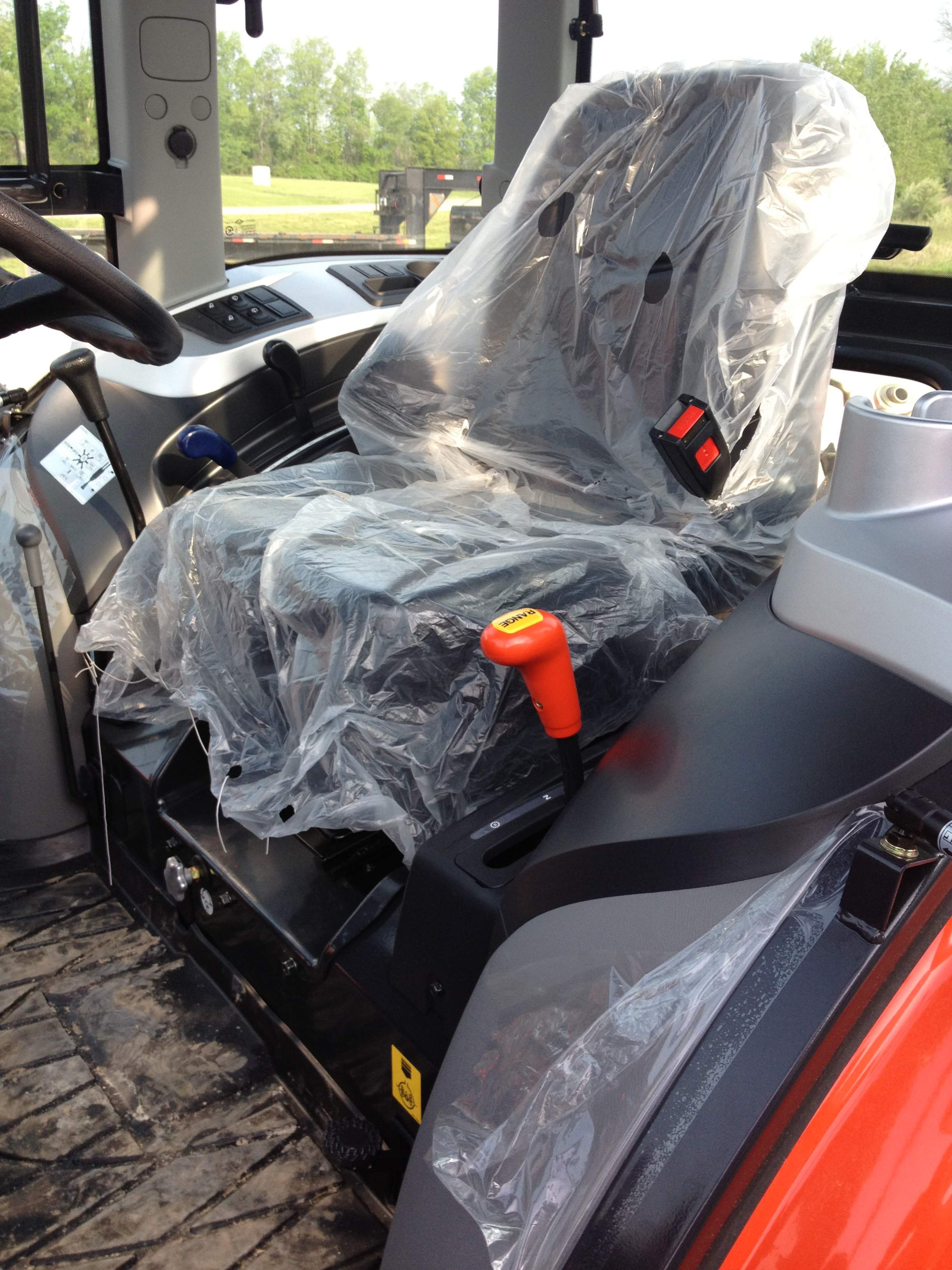

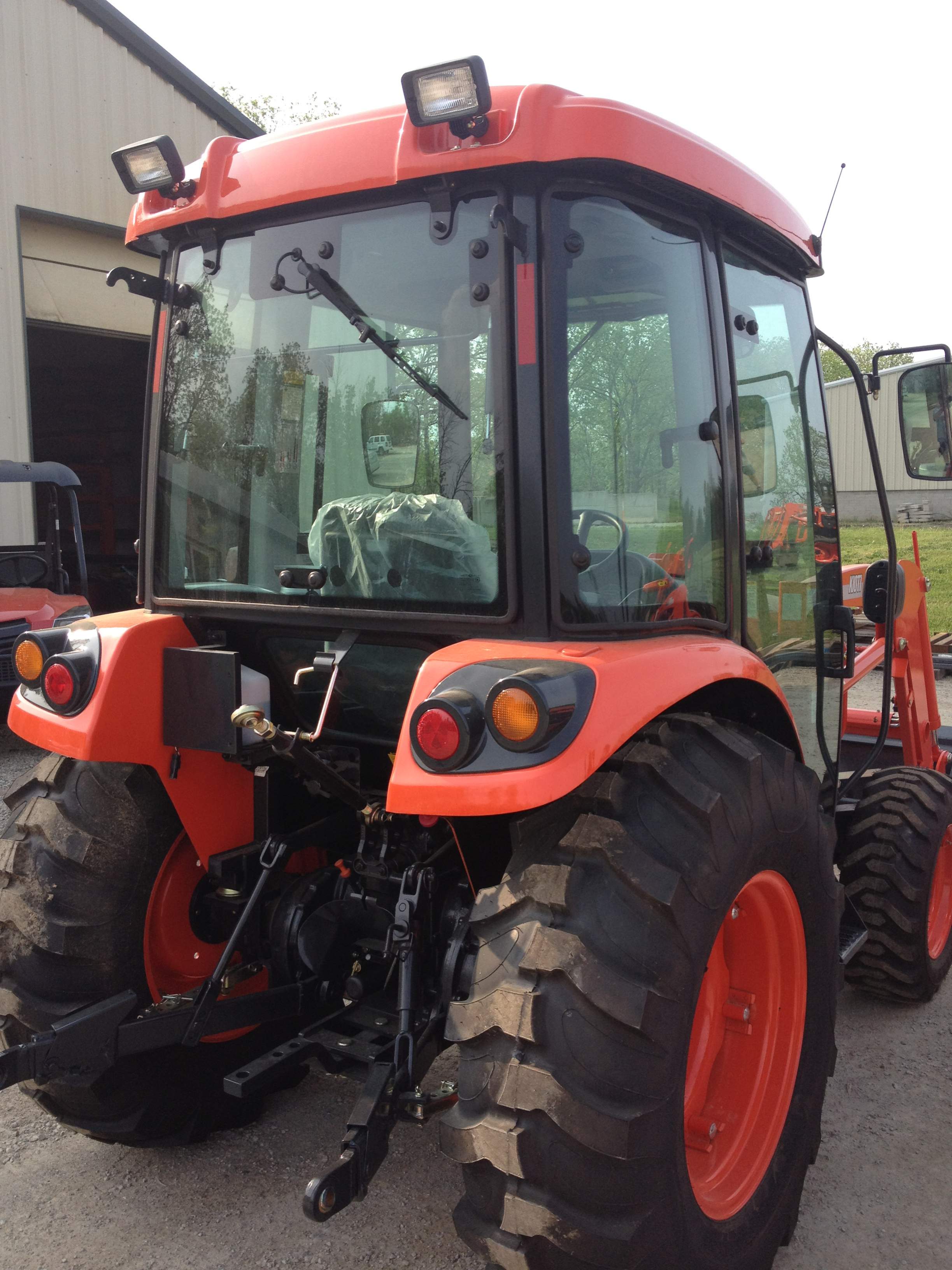

After reading this I dragged out my purchase agreement on my 2012 DK40se cab tractor.I purchased it brand new for $25,000 my how things have changed.
That's how much I paid for my 2013 DK45 ROPS with extras, I almost bought the same tractor you have but knew I'd hammer it up in the woods. Glad I didn't get a cab for my specific use, but boy is that cab sweet, especially when the �� are crazy, like now!
