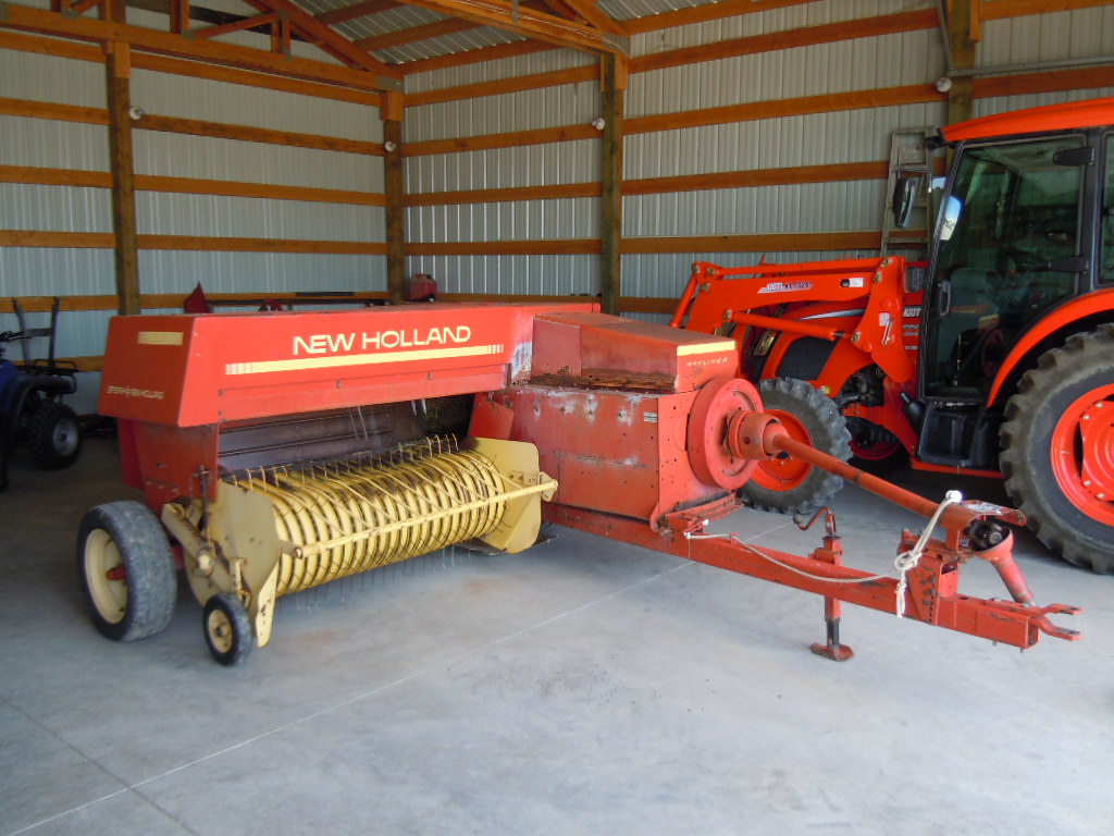

You guys are really tempting me to try taking off my loader. I've been afraid to. I'm sure it will come off easy, I was just worried I would never get it back on. When I am running my haybine or baler it would sure be nice to have it off. I keep the tractor in a garage with a very flat concrete floor, so I think I will give it a try. DSCN1955.JPG

When you get it off successfully and back on, turn around and do it again. Then do it once a week just for fun. The more you do it, the easier it becomes. It is about practice. It quickly becomes so easy it becomes a trivial procedure. I rarely remove my loader on my present tractor, because I just don't have the need to here where I live now. But I used to remove the loaders on previous tractors sometimes several times a week. Moving between loader work and mowing. Give it a try, and you will be wondering why you ever hesitated.

Well, you don't have to remove and install the loader every week if you don't need to,, but my point was if you do it a bunch of times, you will become adept at doing it, and consider it a trivial job. Of course taking one off in a muddy area, and having it sink unevenly can really be all the "fun" you could ever want.

My loader is like any other attachment.
If I need it I put it on, if I don't need it I take it off.
Only takes me a few minutes to install or remove.
Mowing is much better with the loader removed. I rarely mow with the loader on.

Well DK, you and KOua have me convinced. Next chance I get (a day off) I will take the loader off.
