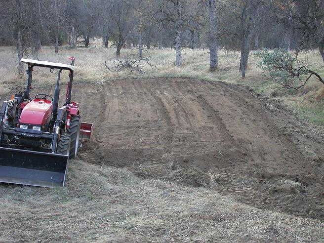

As far as the hydraulic top link... I'm in the process of doing a lot of grading on my property...road work mostly and some pads I'm leveling. There were several areas on the road that had whoop-te-doos I wanted to get rid of, and the pads needed a lot of dirt loosened up and moved around. I also dragged out an area for a deer plot. (See picture)
I use the hydraulic top link to adjust the angle of the boxblade tipped forward so I can rip the dirt and tilt the boxblade backwards to drag dirt from one area to another and further back to smooth other areas without having to get off my tractor and adjust the turnbuckle style top link everytime....just lazy I guess. You know, get out the wrench and loosen the locknuts...etc.
But really, it's very handy and saves time. I don't live on the property so it's important for me to accomplish as much as I can when I'm there.
