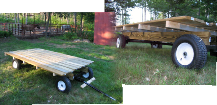

Well, here is the wagon project. I've got the rails and cross-ties mounted. I had some extra steel channel left from building the stalls in the barn, so I used them to stregnthen the cross-ties. The bed is 5' wide and 8' long. The bed planks aren't screwed down yet. Like most lumber yard PT stock, it was awful wet. So I want it to dry out for a few days.

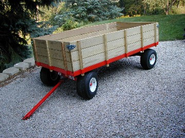

Back in April I submitted a post about a new Kory wagon I had just purchased. I have revised it some and now have the bed and sides completed.
The original design called for the flooring to be screwed into the steel frame members and the stake pockets were on the inside. I didn't like either of these ideas. I welded on outer rails with a removable rear rail and welded new stake pockets to the outside. The rails essentially form a "picture frame" that captures the flooring. The plywood slides in from the rear and then the rear rail is bolted in place.
The floor is a 4 by 8 sheet of 3/4 inch treated plywood. I trimmed it down to provide space for expansion and contraction since this wagon will be outside year round. Sides are made of 5/4 by 6 treated planks. The stakes are 1 by 1/2 inch cut from 5/4 material. Corners clips are the same as used on the DR Power Wagon.
The wagon is rated at 3000 pounds but I don't expect to ever haul that much.
Several photos follow.

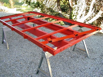

Details of revised frame. Note original stake pockets inside the outer frame members and the new ones on the "picture frame" rails.
