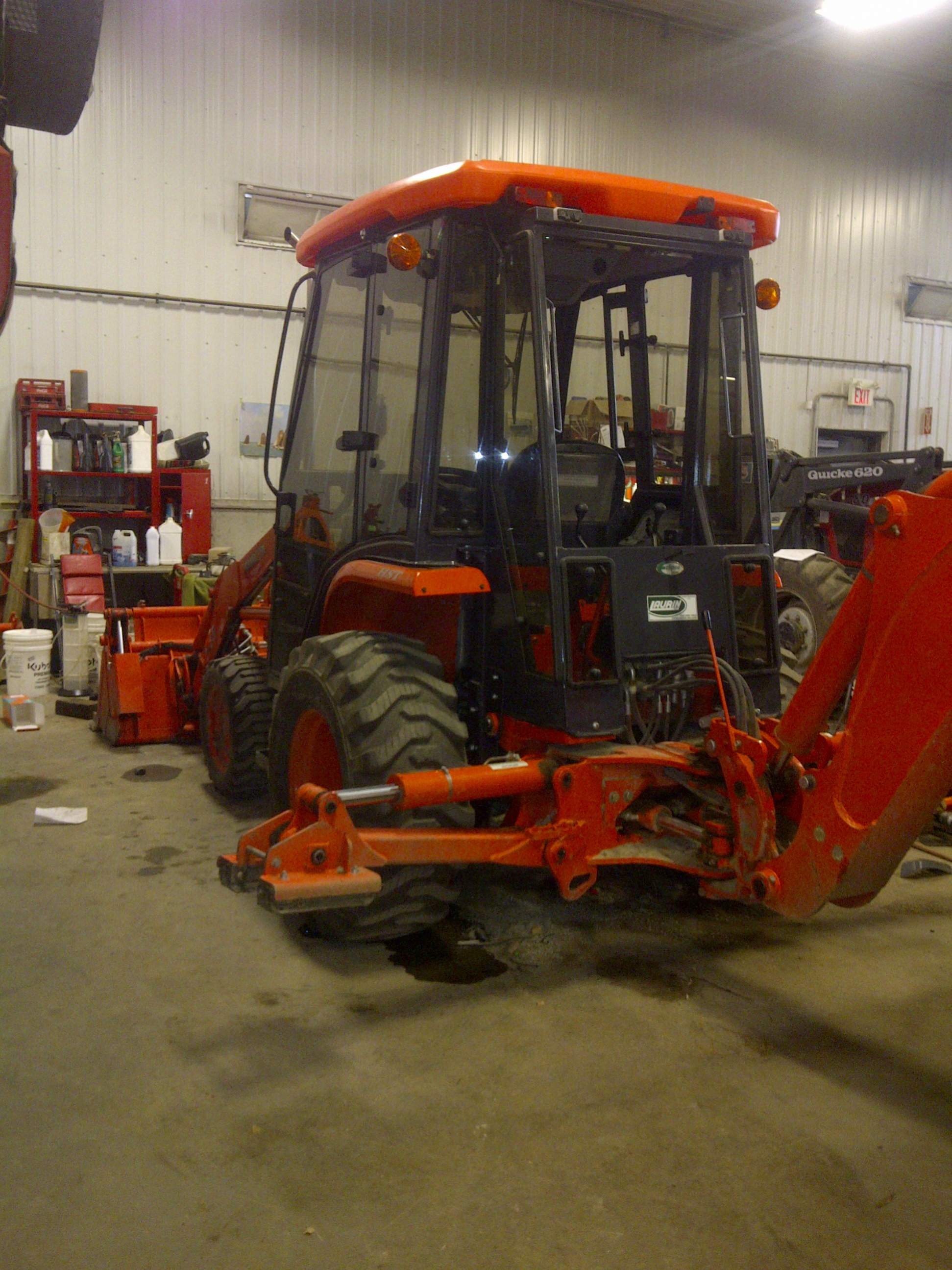

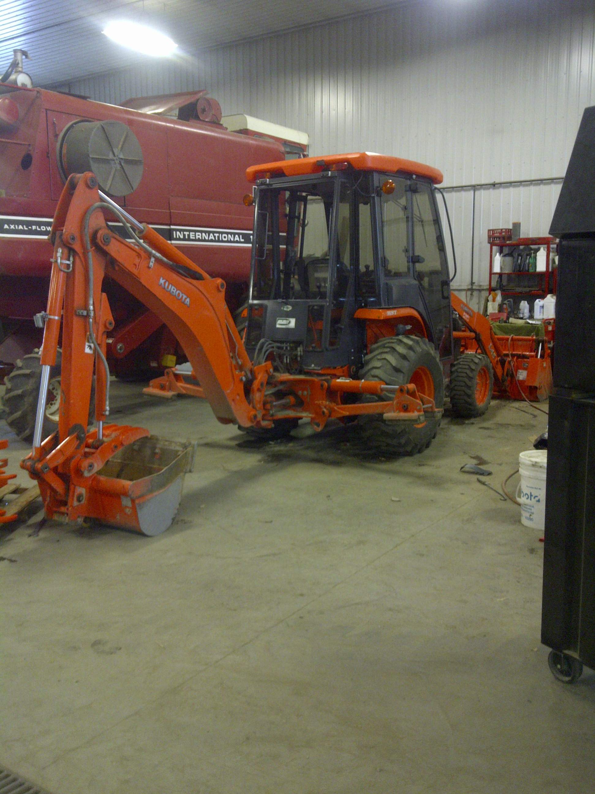

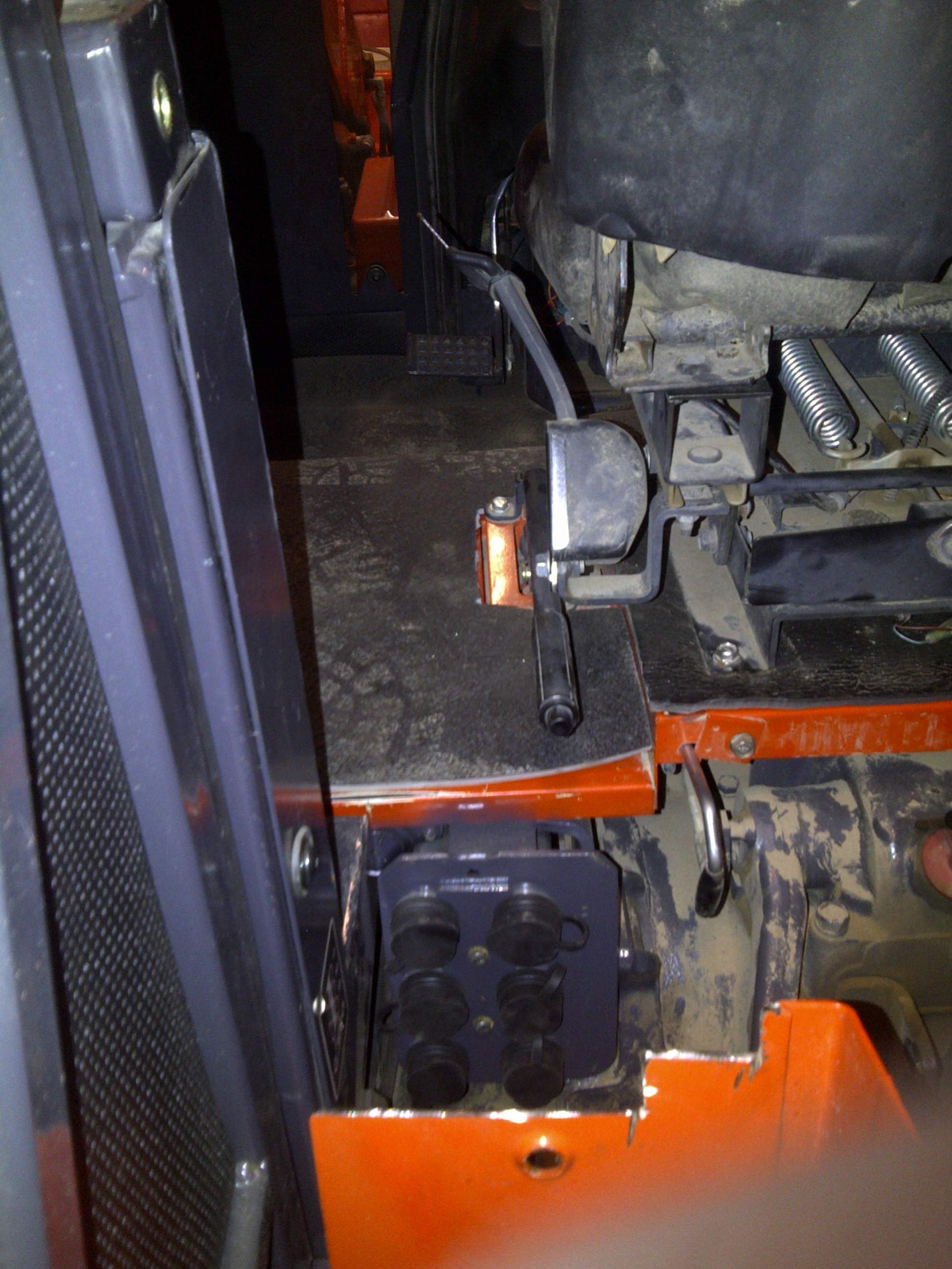

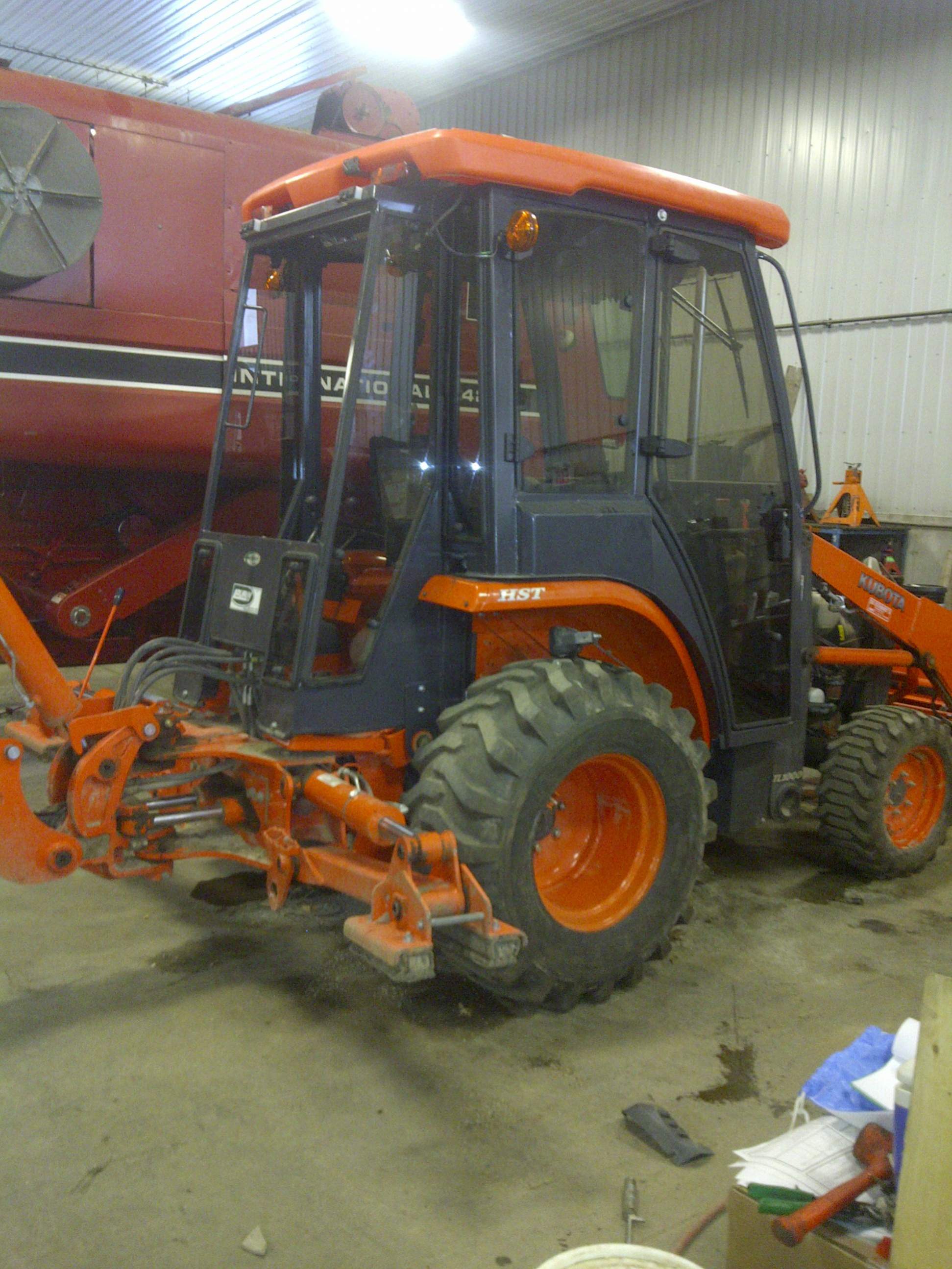

I stopped at the dealer on the way home from work today and I continue to be impressed with the job the mechanic has done installing the rear remotes. It has been such a huge amount of work and customization that the Service Manager tells me that they will not do it again. The odd thing is that I don't at this time need the remotes but when the cab was ordered he and I agreed that the best time to install them was as the cab was being installed rather than later so that is why I ordered them. Here is a photo of the nice, out of the way location on the left side of the drivers seat under the floor where he has placed the hydraulic quick connects for the remotes.

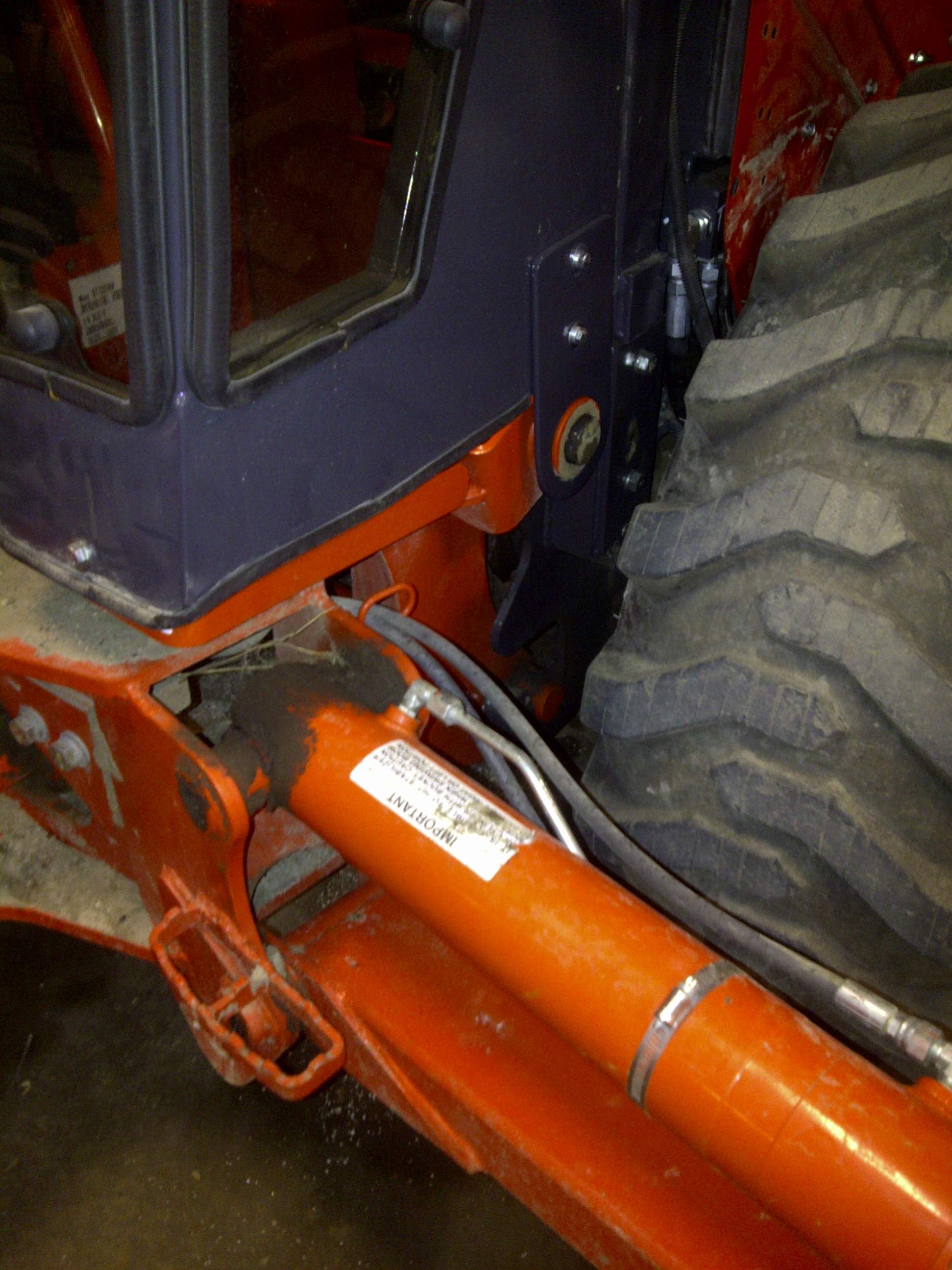

They are supposed to be mounted at fender height on the right side of the tractor but that would have been a real PITA for me when on the backhoe. I am only 5'-10" but a lot closer to 300 lbs then I would like to be so the more room on the backhoe perch the better for me. All of the Laurin TLB cabs have an optional backhoe enclosure that needs to be ordered separately if you want to operate the backhoe in climate controlled comfort. I had thought that I could leave it in place if I was to use the 3 pt hitch but as you can see in the photo below it is actually attached and supported by the backhoe with brackets around the two upper pin bosses that attach the hoe to the tractor. There are two clips at the roof that you release and when you remove the backhoe the enclosures tips away from the tractor with the enclosure. There is a separate metal panel that then is installed to fill the void where the backhoe pedestall is and then you remove the rear window from the backhoe enclosure and install it above this bottom panel.
I hope I am not boring you all with this process but I thought it would be good to document for those who might be considering a Laurin cab installation. I'm looking at you Martian! :)

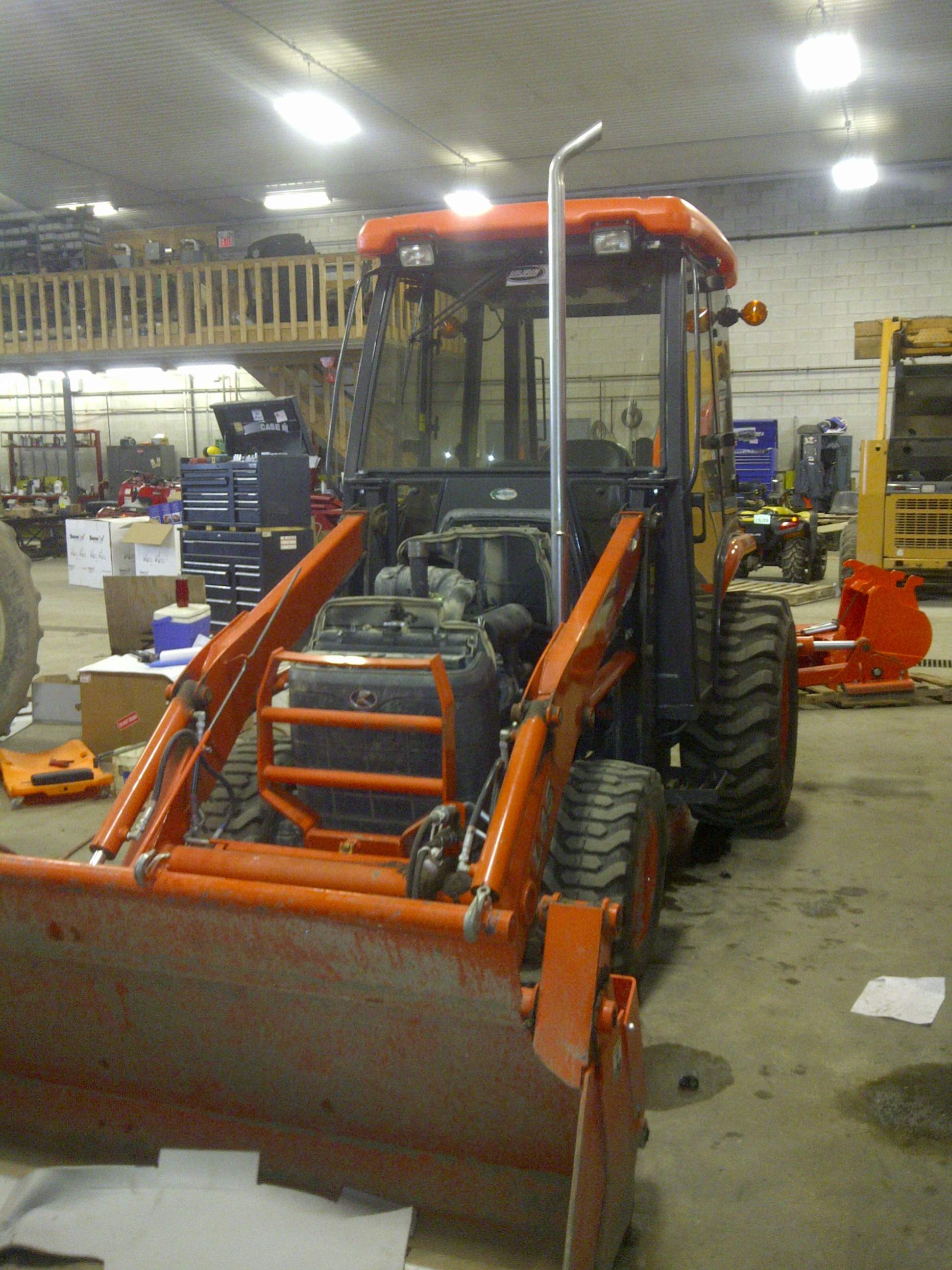

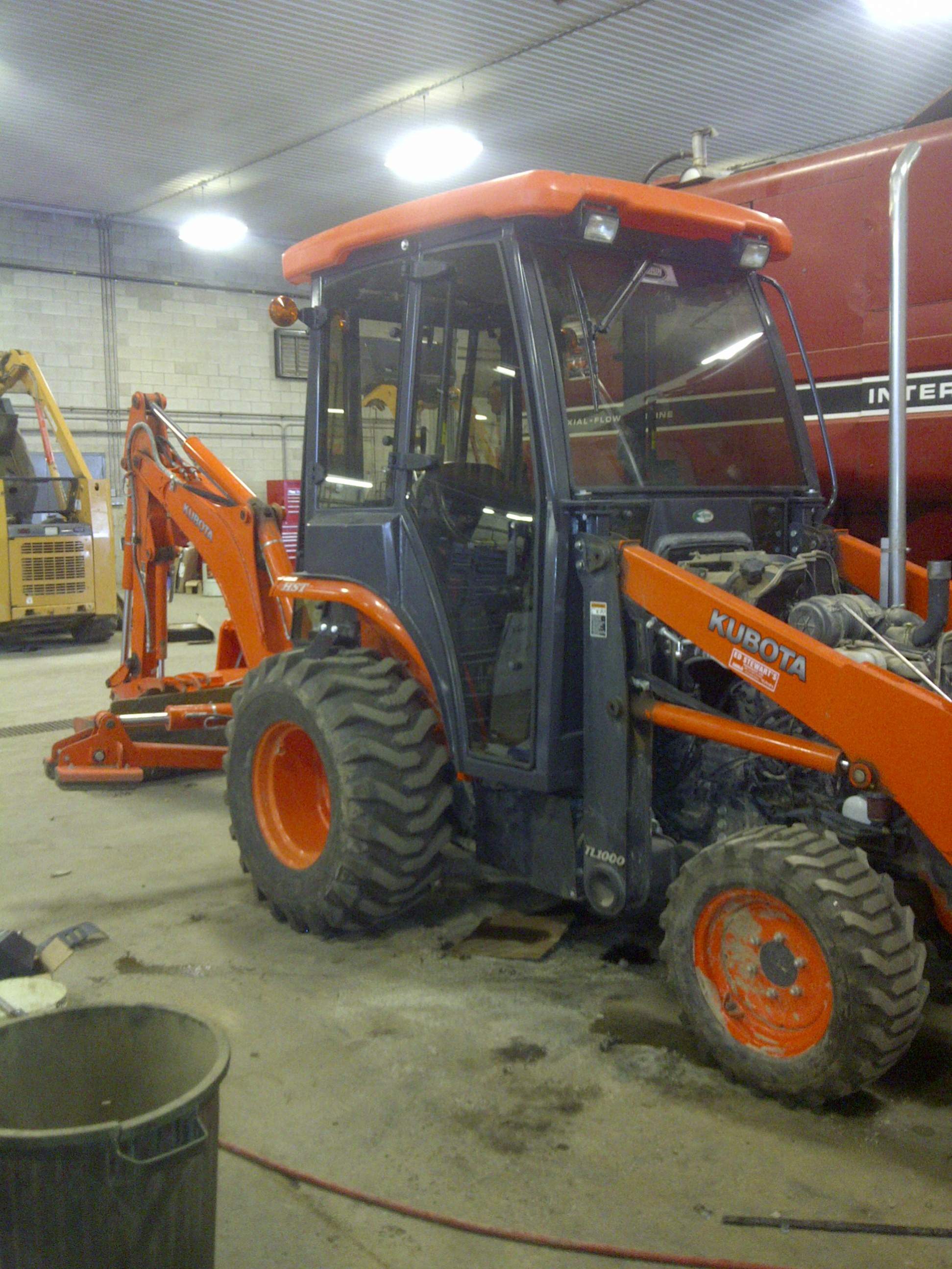

Here are a few more photos. I think all of the hard work is done now - they are just working on installing the factory lights on the Laurin extension brackets and I have asked them to install two additional rear work lights so I can better illuminate the sides of trenches when working in the dark. Then they have to do the 200 hour service and she'll be ready for winter. I am really looking forward to loading her in the trailer Friday evening or Saturday morning and spending some quality time on the seat out of the weather this weekend.
