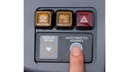

Question for you though - does your dash match the owner's manual in terms of the regen buttons? I can't figure out if the left hand button should be left on (lit up) or off to have the automatic regen function. The button in the tractor seems the opposite in terms of its symbols to what is in the manual. Manual shows an image like below - tractor shows similar with a "no smoking" type line through the left hand button. So can't tell easily if automatic mode means button pressed or button left off.
   / New Kubota L6060HST Cab and Loader #10
Every time you restart the tractor, it is in automatic mode. Only use button if you want to manually regenerate. In auto mode, it will flash on the dash letting you know it needs to regenerate. You can scroll thru the various screens and one shows the %. Once it starts, you can idle up. A different light will flash if you do not have the RPM's high enough. I believe the book has 3 or 4 steps you have to do to manually regenerate. Hope this answers your question.
