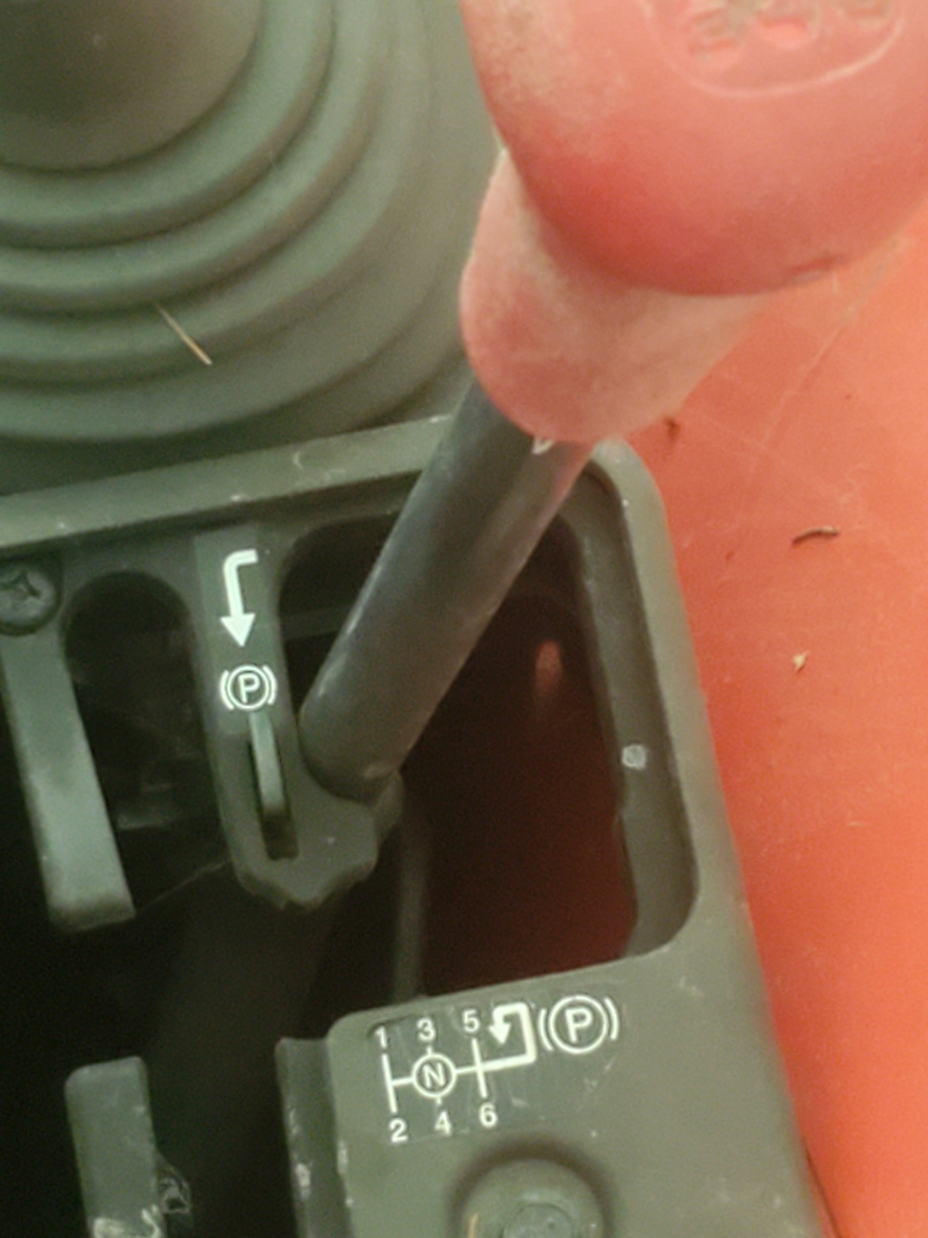

UPDATE: Thanks to all for all your help. I finally made it out to try the tractor yesterday, and it is significantly improved. I can shift it out of Park with one hand most of the time. And it never got stuck in Park. It still does not shift as easy out of park as it does between the other gears, but it is way better than upon delivery. I spoke with service rep, and he said he made an adjustment on the brake linkage (which was what was suggested on this site). - Bob

Hi Buxus, maybe this is obvious to you but I'll try explaining my experience anyhow since I had the same issue on my M7060 DTH12 for a while and it took me a long time to figure out. It's all in the way you handle that shift lever lever coming out and going into park. Coming out of park you really need to rotate in a clockwise direction first right, then downward then left, then up, then right, then down again before getting into the main channel to select the gears, always pressing against the metal like you are forcing on the outwards (radially) along the metal. It's hard to explain, I can try explaining better when I have more time. But this worked miracles for me, it went from incredibly hard to very very easy. Look at the arrow in the pic but force outwards radially following the metal ins rising circle. It sounds crazy I know but it made a world of difference for me and I suffered a long time before figuring this out. Let me know if you need me to elaborate some more on that
   / New Kubota M7060 HD12 a (%&*$! to get out of Park #36
Do this with the hydraulic shuttle in neutral and the clutch in of course, no need to hit the brake
