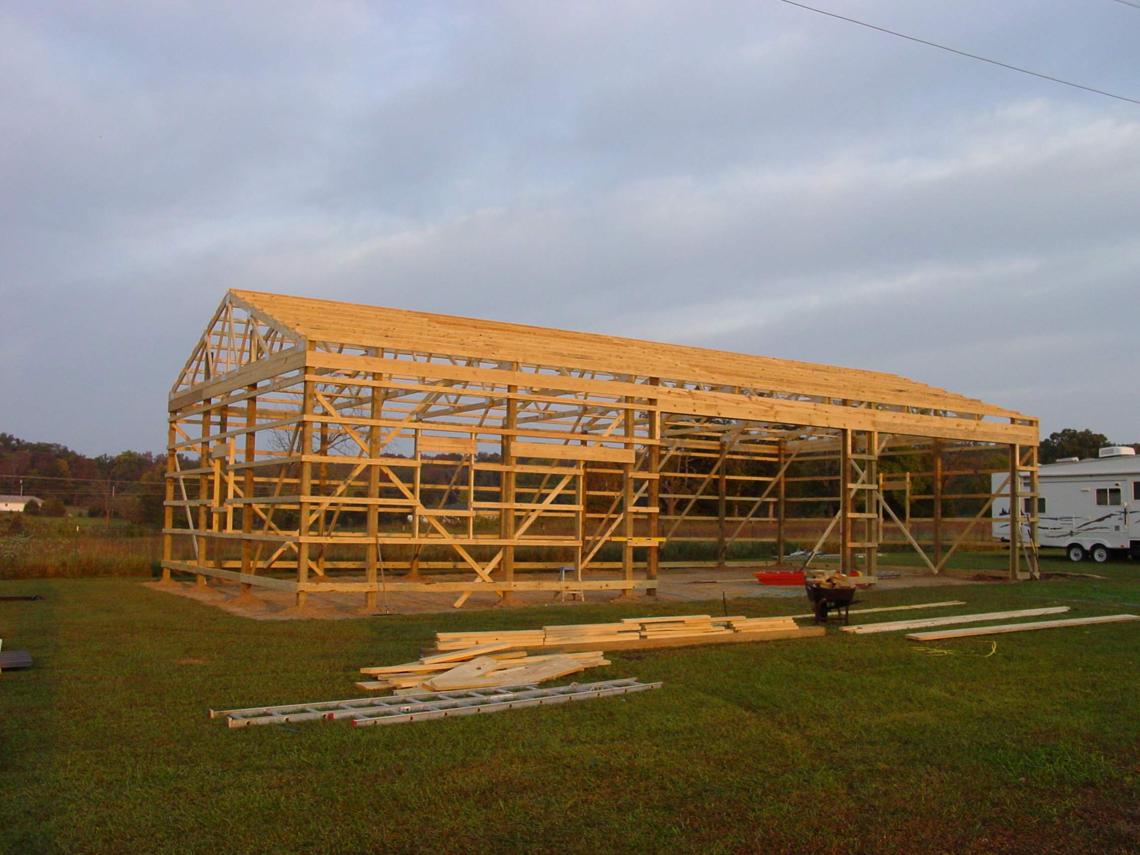

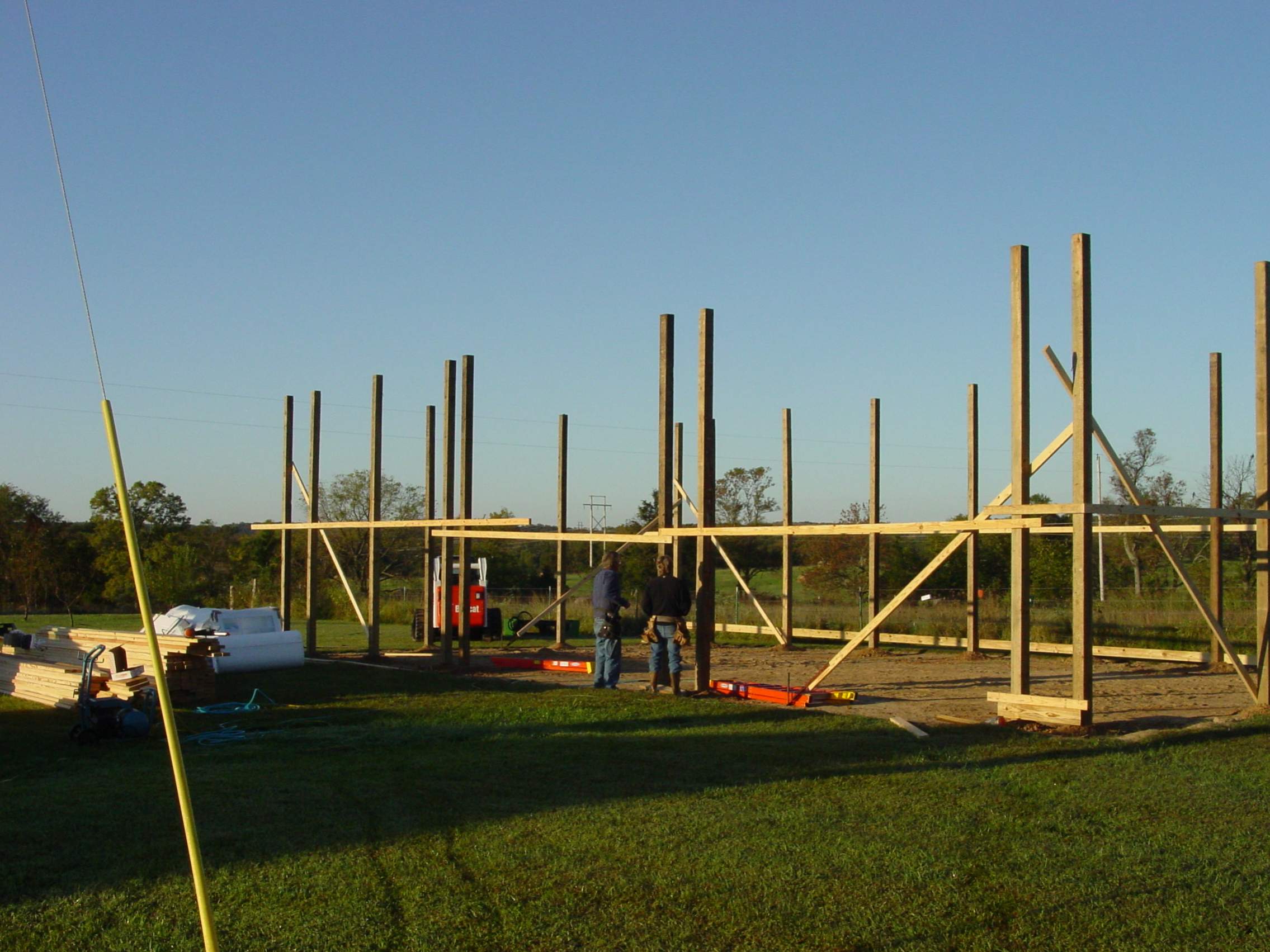

In answer to the questions about my shop/garage. It's called a pole barn or more tecnically a "post frame building". There are lots of companies out there that build them & usually advertize in newspapers, weekly advertizers etc. Their adds state real attractive prices, --but thats just for a very basic structure (posts & framing, metal siding, one walk in door, and a sliding door, labor).
The nice part about these buildings is that they are endlessly adaptable for just about anything from livestock to storage and can be built in any size needed. Some information on mine:
1) 30'X60' or 1800 sq. ft.
2) 12' sidewalls
3) Two 10'X16' overhead doors. 1 walk in metal door
4) 3 standard size windows
5) All sides and roof insulated 1/4" reflective bubble wrap
6) Concrete floor smooth finish
7) 40 year metal w/colors of your choice
8) All labor to build included in price
9) Quoted at: $22,208.00 Actual: $22,865.00
Here are some construction pics: 006.jpg
   / New Kubota Owner #30
Nice skid steer attachment for setting trusses. My builder had a homemade one he used to set trusses on our barn with 14' wall.
