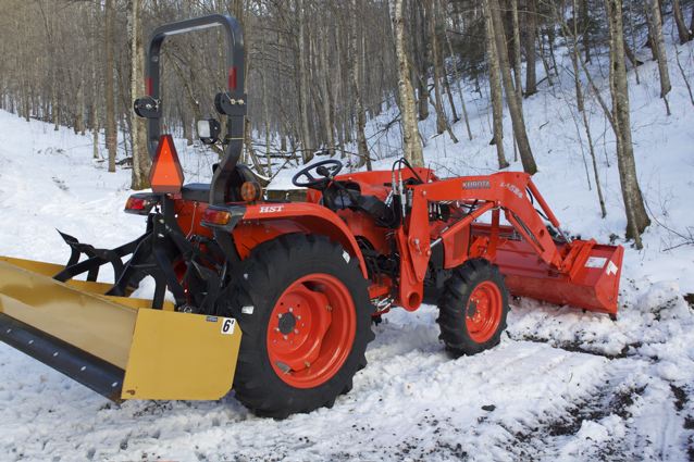

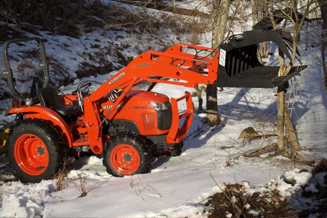

Thanks everyone for the help. Here are some pics. I absolutely love the tractor. Having no experience with Tractors I really relied on the forums here and I couldn't be happier. Never heard of a Grapple before! Really glad I got the R1's.
