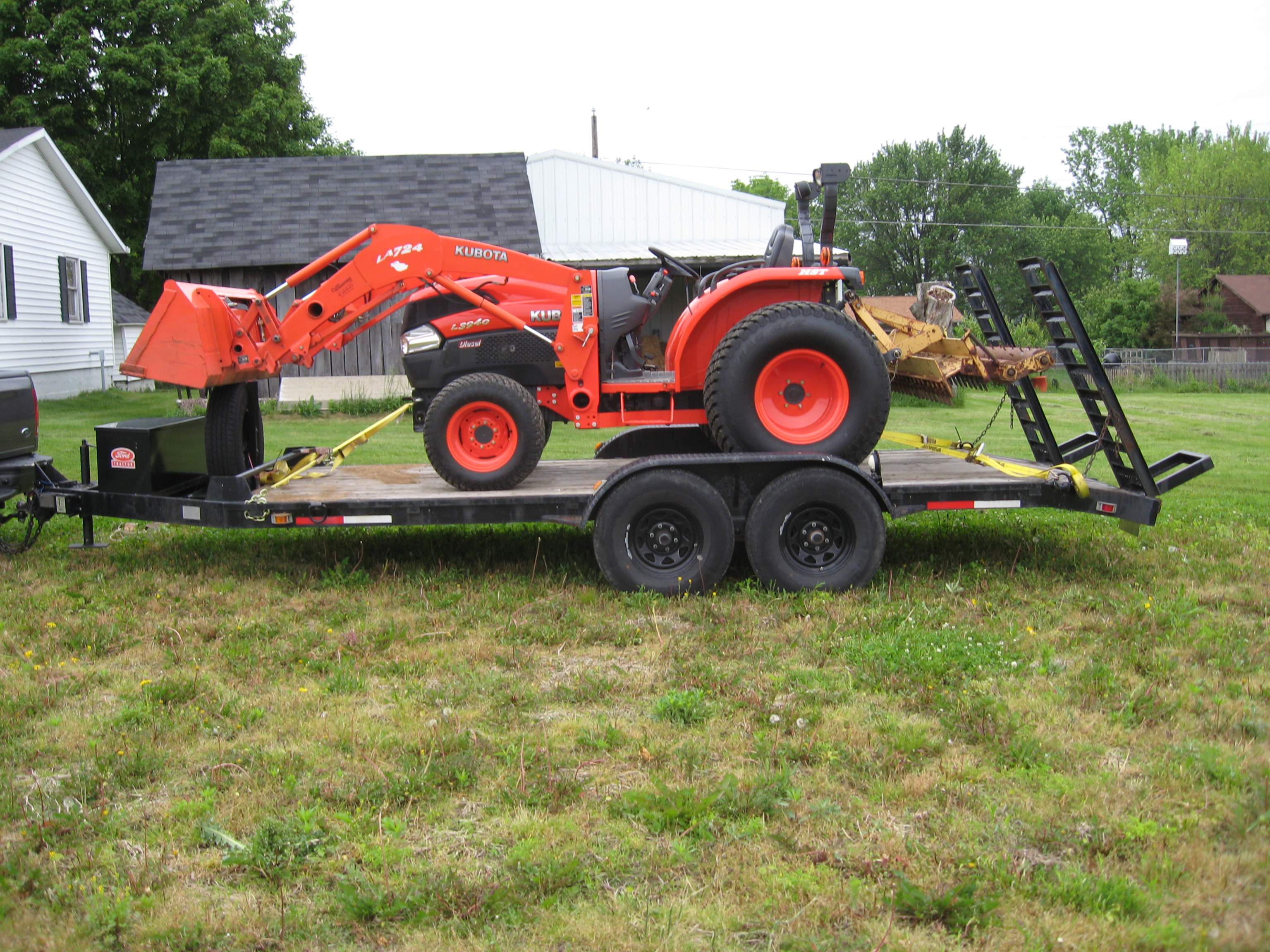

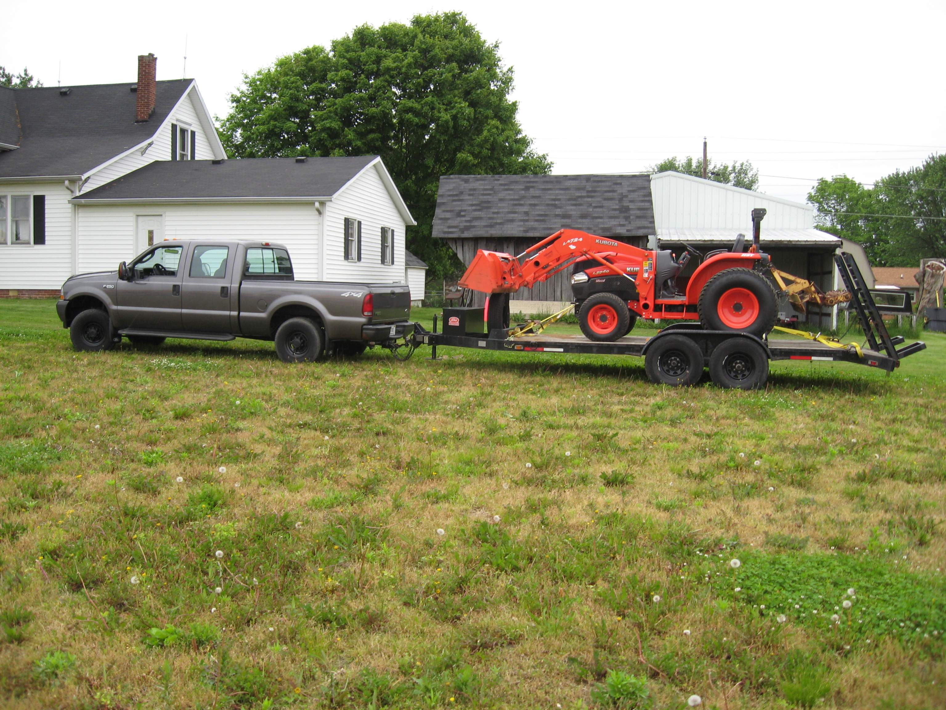

Make sure your truck and trailer are up to the task with proper load ratings. I would suggest a minimum 18' long trailer (16' +2' beaver tail is okay). Trailer brakes functional? Take plenty of chain and straps so you have options to tie down.
With FEL, it is a long package. Here is L3940 + FEL. Granted, I have implement on back, but you still need angle on your chains for proper tie down.

FYI. My L3940 weights 3627#, FEL 1486#, and trailer 2640#. Grand total is 7753#. This puts a little over 1200# tongue weight on my truck. Philip.

Philip: Yikes. I've got the HD Towing Package and can pull 8,700 lbs, but max tongue weight is 890 lbs. Don't know the weight of the trailer but will ask my friend. May need to go to plan B.
   / New L3800 vs. 2008 L4240 #17
If you have room on trailer, move tractor back to reduce tongue weight. You can always look at backing tractor on, don't know if that would help or not. Philip.
