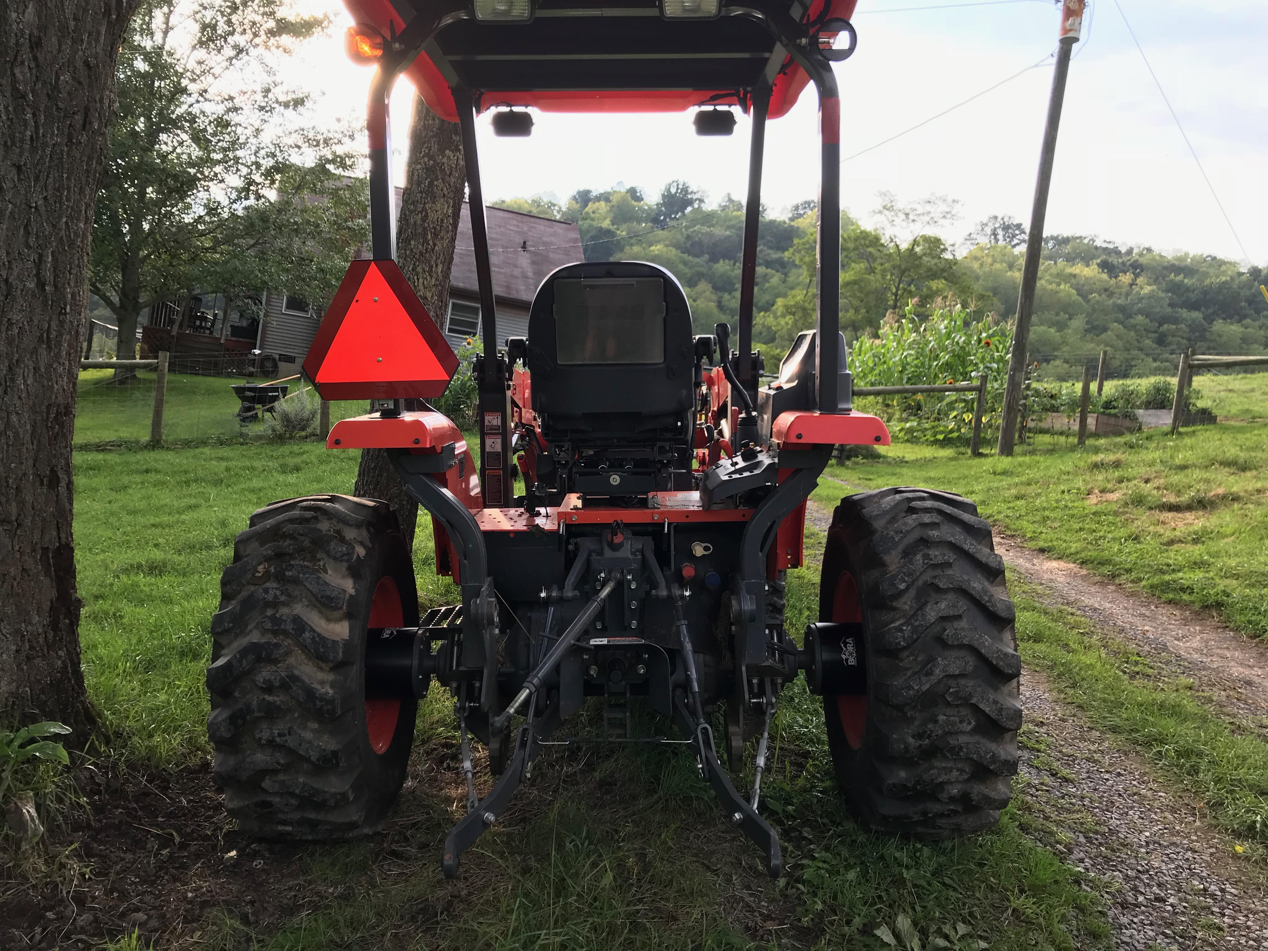

Thanks everyone for the advice. I just ordered 6" spacers from BORA for the rear, nothing for the front.

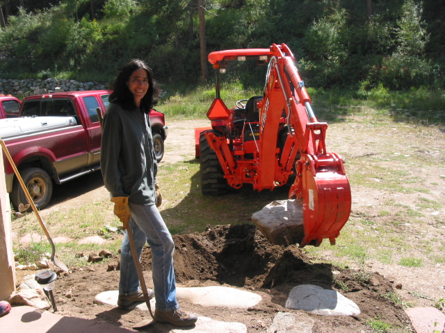

BTW, the thumb will pinch down hard enough to hold a rock out just about indefinitely. See the attached photo. So if yours doesn't, you can probably make it do so. I guess it would slacken its grip eventually, but if I'm holding a rock out with the thumb I expect it to hold that rock firmly clamped while I get off and measure, or take pictures, or consider a rock....or do something else for fifteen minutes or so. I'd never, ever say to trust any hydraulic system completely - my assumption is always that it is going to fail right now in the worst way possible - but so far it has held longer than we needed it to and no signs of letting go.

Thanks everyone for the advice on spacing out the wheels. I finally received the 6" spacers from BORA and got them on my L47. Couldn't be happier - they definitely add confidence on the side slopes. Photo attached.
