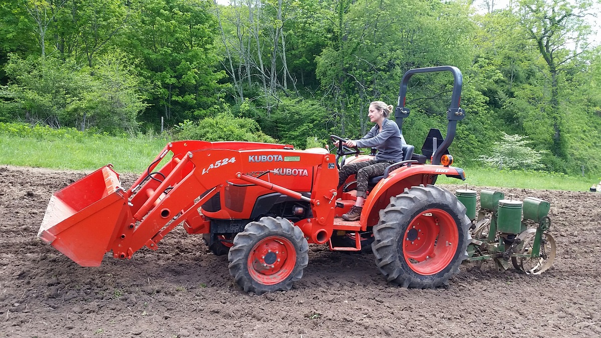

I was in the same boat about exactly 4 years ago. Bought 200 acres with roughly the same mix – only in the mtns of VA. Primary use is cabin in the mountains escape and hunting/fishing. So over the last 4 years things have changed a little bit but I know exactly what position you’re in. The house had not been lived in for 2 years so the house and property needed work.
Year 1. Ordered a L3200 with loader, bushhog, box blade and a couple other items right away just to get things going. At the same time also bought a used Kawasaki Mule 3010. One of the best purchases ever. That thing is amazing and gets used more than anything. Unbelievable how it will climb and the amount of stuff it carries. Definitely recommend a UTV. Also bought a ncie big Stihl chainsaw and weedeater and all the attachments to go with it to leave there.
Probably have about 2 or 3 acres of yard grass to mow so next was a BX1860 in the spring of that year. It has a 48” deck and loader valve but that’s it. Just a good basic 4x4 lawn mower.
Year 2. About a year after buying the place I bought a Yamaha Big Bear ATV. Wanted something simple and 4x4 that is a little more nimble than the Mule but helps when other people are around. There is always somebody that wants to ride the 4 wheeler.
Started to work on food plots a little more this year. The first year I attempted to use the box blade with the sheers down for a disc. Results were marginal so I bought a used 5’ tiller and rebuilt it over the winter. I think I have $500 in it and it was been great – through the rocks and all. Also found a nice spreader on craigslist that was used once. Bought a wood splitter and of course more tools.
Year 3. All day bushhogging with that 5’ bushog is getting old so picked up a 100hr M5640 /loader (wanted to stay away from tier4) with a new 8’ Woods mower. Mowing time now cut in half but barn space is becoming limited quickly. Also picked up an old JD 2 row corn planter from my butcher for $300. Neat old piece of equipment. Had my wife planting corn.
So the “farm” has been a work in progress with every year something being improved upon. The house has also needed a lot of work but it seems that gets pushed back when it’s nice outside. There’s always something to do. Trails are mostly cleared now, some new ones made, food plots established, etc. Pond still needs attention, some gates/fences need work – always something but always fun.
I think I have $80k - $85k in equipment/tools now. Adds up quick but I like to buy new or as close to new as possible (exception of the corn planter – probably from the 60s) since I do not want to spend time working on equipment. I started with Kubota and stuck with them as it is easier for maintenance, they seem to be very reliable and parts are easy to find. Fortunately no repairs needed.

I wonder @abeal... do you wish you would have started with the M5640 instead of the L3200? Would that have saved you in the long run and still be fine (not too big) for all your tasks?
UTV's are how I started down this road... I started looking at them and got good advice that I probably should make the tractor my first purchase and the UTV my second one.
Tough call but I think not. Almost went with a MX5100 and 6' cutter to begin with but I appreciate having 2 tractors - especially when there is somebody to help. That L3200 is so handy and useful. I can get that through the woods while there is no way I would be able to get the M5640 in there. It's a dream for food plots. I have found that it is difficult to find the "one tool for everything" approach and while I was able to manage with the L3200 for a couple years the M5640 basically just reduced mowing time and is used almost solely for mowing. Would have been much cheaper just to hire mowing but it's fun buying tractors!
