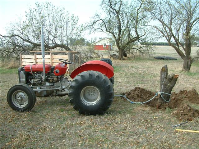

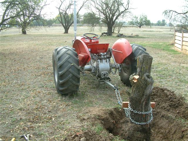

If you plan to work the hilly slopes on your property, be aware that all wheeled tractors are more or less unstable on slopes. You need to find a tractor with the lowest center of gravity and widest wheel track. Look at some of the threads in the Safety forum here on TBN to see how quickly you can get into trouble working on steep slopes with conventional tractors.
Here's an example of a low CG tractor. My 1964 Massey Ferguson 135 diesel has been modified to squat very low for work in the orchards around here.
With those wide rear tires (18.4-16, 16" dia rims), the track is 84" wide and the rear axle centerline is about 16" above the ground. The front spindles have been shortened to keep the tractor level. The rear tires are loaded 2/3 fill of water ballast (no freezing problem here in the North Sacramento Valley). My tractor dealer (Dave's Tractor in Red Bluff, CA) has modified new Mahindra tractors in the 40-50 hp range to resemble the setup on my 135.
Wide rear tires and/or duallies should be on your to do list when you go tractor shopping. Ask questions.
Good luck and be careful out there.
