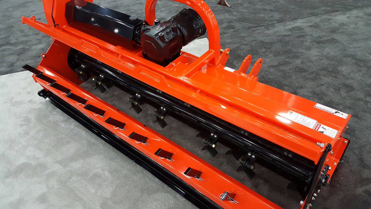

OK now that I have seen the jpeg. images you linked to:
1. they are not using flail shredder hammer knives that gets a minus.
a. the side slicers are simple sheared side slicers and I am unsure if they are hardened heat treated side slicers.
B. The side slicer hangers are secured with nylock nuts and bolts-not good in my opinion as they use strap iron to mount the knife hangers on a single stub weld and if an impact occurs the rotor will go out of balance if the metal weld stub is broken off this gets a negative -.
1. there is a very good reason the mounting stations on flail mower rotors are designed the way they are with twin stub weldments for side slicers or hammer knives this gets a negative -.
2.The trash door only has a "fully open position" that works for changing knives and shredding tall brush in one pass- that gets a demerit only because the existing Maschio units can be adjusted to limit discharge flow in tall brush where locking the hood in several positions with the bolts provided by Maschio can offer a fully open to closed/sealed position+-.
3. the recutting bars are kept in the new units (a big plus)++++++++++++++++++++
4. the recutting bars are only held in place with spring cotter pins(that gets a minus as heavy brush mowing will eventually break the spring pins and the recutting bars will fall out (that gets a minus) It will be too late when the user finds them gone. - -
a. they need to replace the spring pins holding the recutting bars with fine threaded bolts and nylock nuts to hold them in place OR use a continuous rod with a cotter key on both ends like the Vrisimo units use to hold their side slicers in place on thier flailmower rotors +- .
The images do not show whether their mowers have the shields in the intake side of the flail mowers -+.
