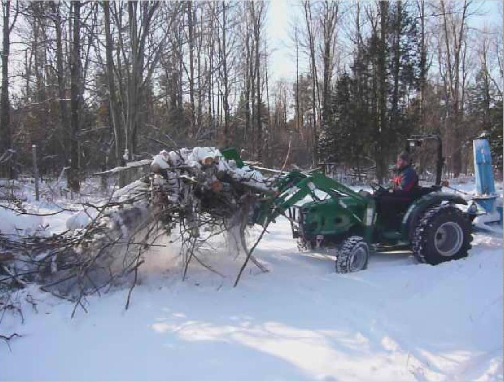

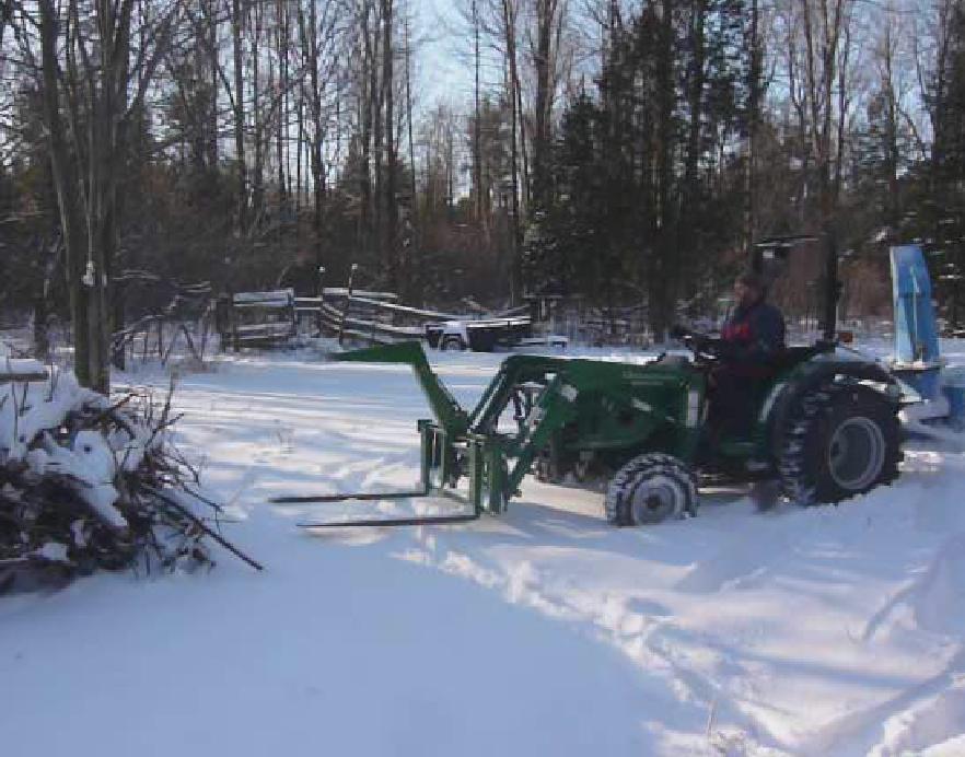

Since you are getting forks, here is another must have :D. I made this grapple add-on for my forks. This moves A LOT OF BRUSH and the grapple only added about 60 lbs to it. I have it plumbed back to the rear remote. This grapple is no good for rocks though.
Interesting, mwb - so it's a 1-armed grapple? Looks simple enough to mod up!
   / New Landini 4140 Delivered Today #22
yes, only one arm on the grapple. I had planned on making it three but thought I would try it with one. This is designed specifically for logs and brush.
