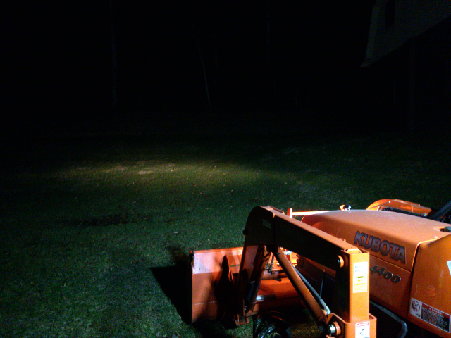

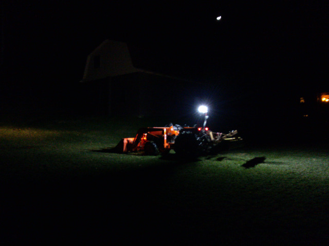

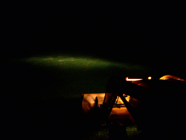

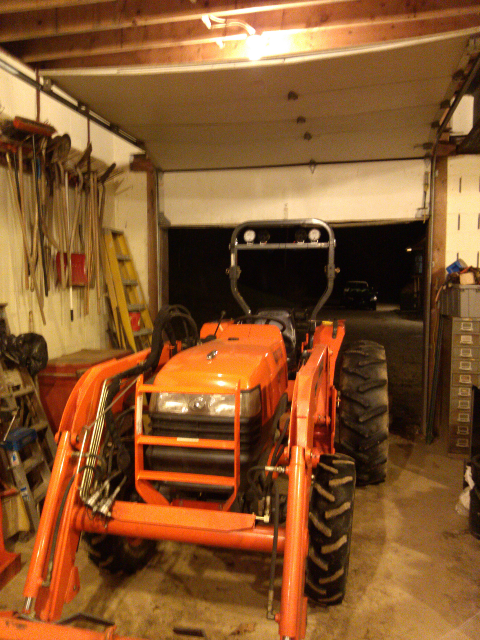

I ordered the 27W LED Round Flood lights from LEDstore on ebay. They were delivered from the west ccoast to WV in a few days and the lights looked really good. I ran down some plastic washers for the swivel points of the lights. I put 2 facing forward and 2 facing rear. I made brackets out of unistrut and welded some bolt ears on. I picked up the power from the factory work light circuit. I used panel mount toggle switches and drilled and mounted them in the light bracket. I turned them on after dark and all I can say is WOW. I had a few questions for LEDstores and they responded quickly and to my satisfaction so my next light purchase will again be from them. Ledstores :thumbsup::thumbsup:
   / New LED lighting for half the price #68
dex3361: Pictures please! :)
   / New LED lighting for half the price #70
Here are a few pics of the lights. They are the flood type and with the front and rear on I can see all around the tractor. The grass shots do no justice to the lights but itr gives you an idea of the pattern the lights throw.
