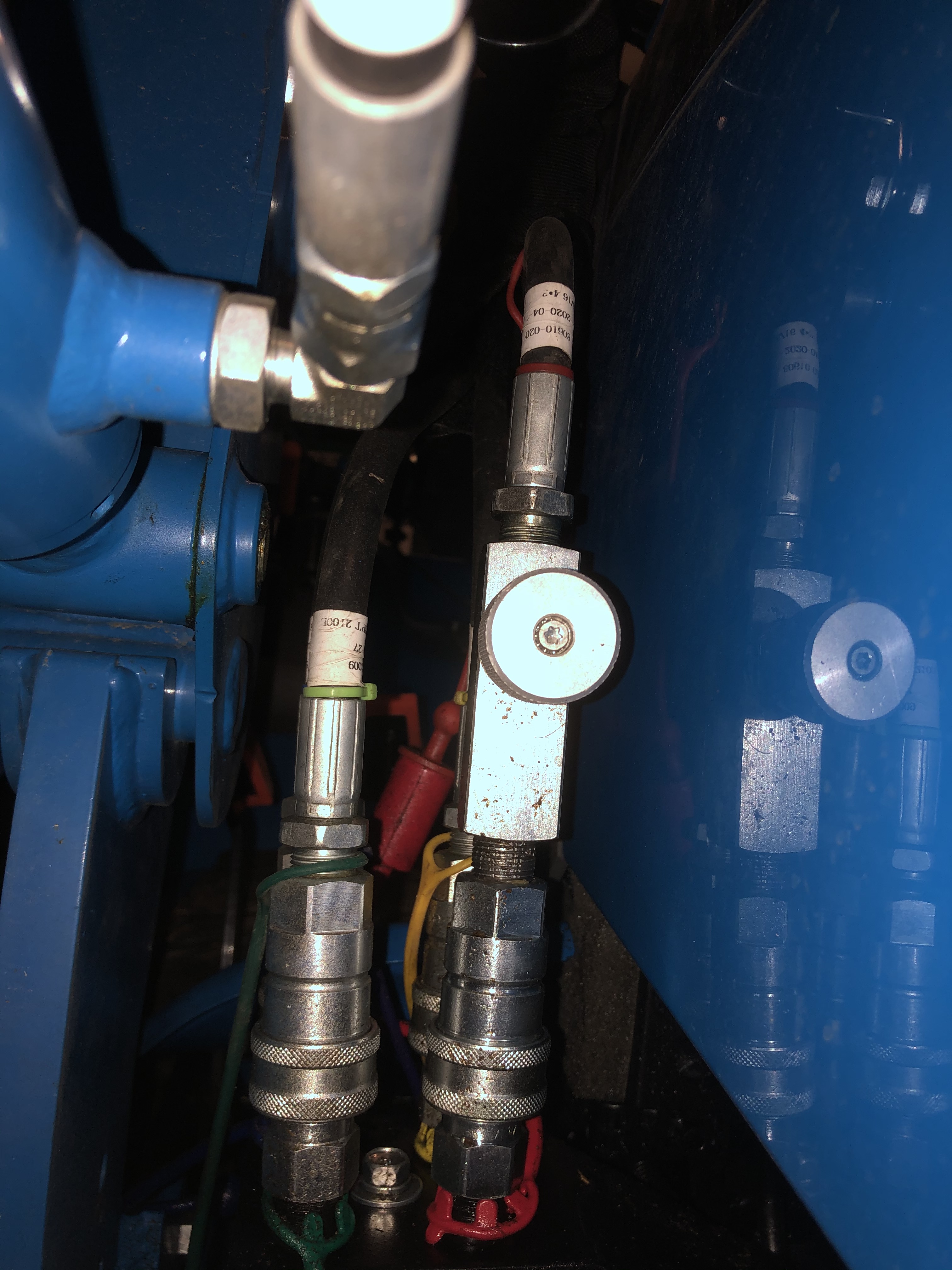

The dealer placed a restricter value on the drop side of the bucket hydraulics. it is a rheostat type valve that I can manually adjust the flow. I keep it pretty tight which makes the bucket dump a bit slower but gives better control when using the bucket to scoop material. it seems to keep the bucket from rolling forward when digging/scooping.
Would you be kind enough to post a photo of this valve, showing where it is installed? I'd really like to do something like that.

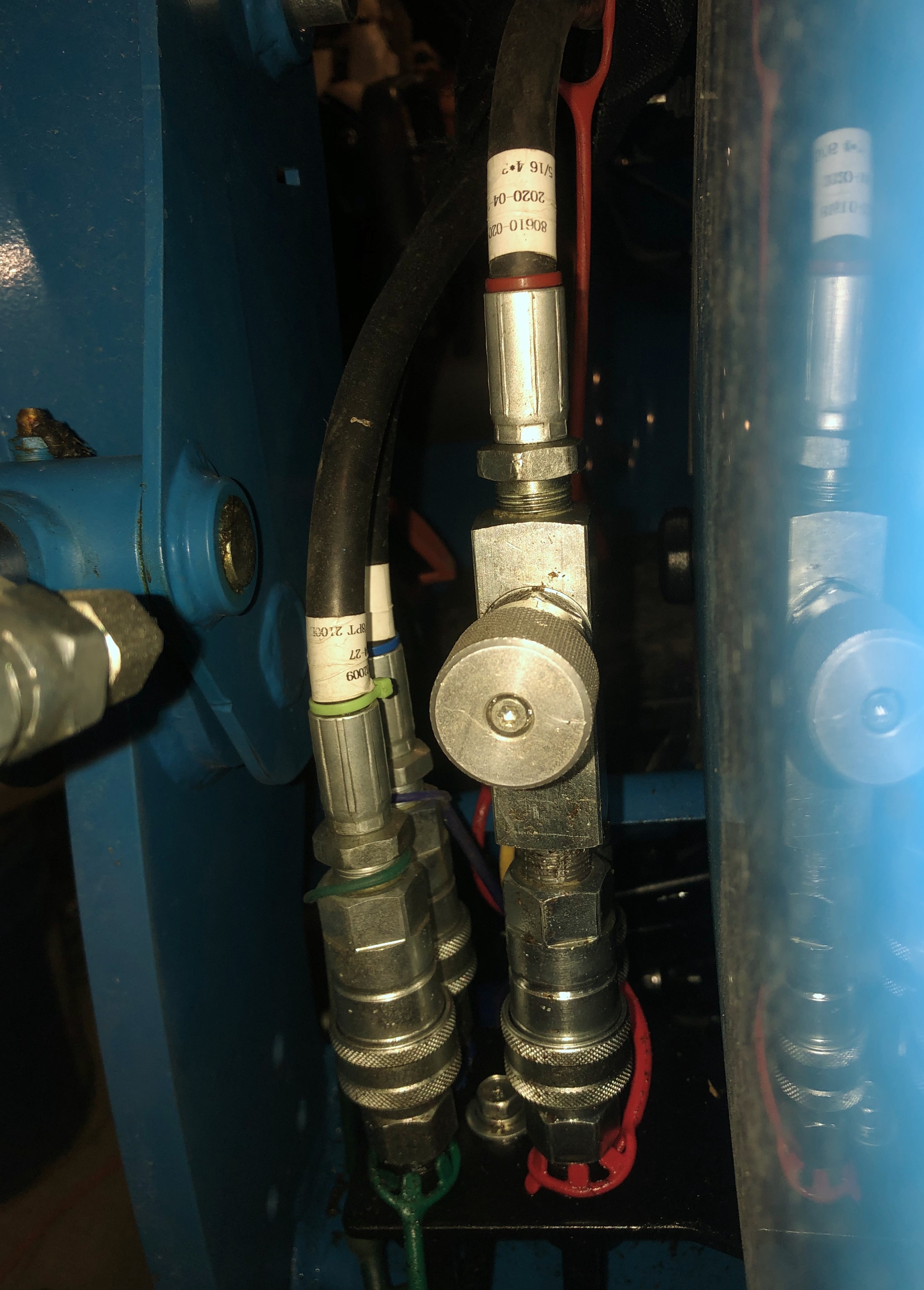

Here are 2 pictures of the restrictor valve: MT 125 valve 1.jpgMT 125 valve 2.jpg

More properly called a "Flow Control Valve" it's important that it only effects flow in one direction, a check valves unseats when fluid moves in the other direction.
that also means it's important to install it the right way. If you use an ordinary needle valve, movement in BOTH directions will be restricted and force will lag.. very annoying.
They're quite common in fluid power systems both hydraulic and pneumatic but rarely seen in consumer products. the speed of mechanical systems using fluid power is usually controlled by designing pumps, actuators, and lever-arms to get the desired effect and not require adjustable speed controls - not just for cost but also to avoid manipulation by untrained personnel.
As far as the floppy bucket problem, I fixed mine by just getting the air out.

Well as it turns out the flow control valve leaks like sieve. So yesterday I took it off and followed the instructions I saw in a YT video called "floppy bucket Syndrome". So far it seems to be helping, but being winter I haven't been able to really test at this point. I did notice better control and stability in the float function so maybe this will work overall.

Good that you point the directional flow type vs bi-directional. I use variable control valves in a couple of applications, choose the variable to set things where I want them rather than guessing when purchasing, and want the bi-directional type for my applications....not what you are doing.
