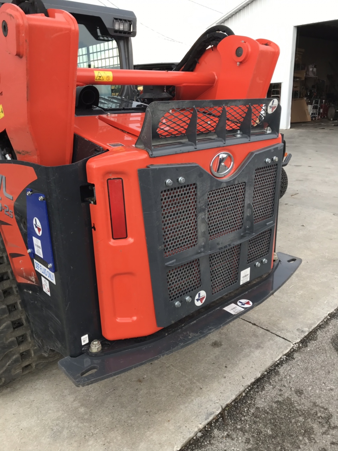

Here's a couple of pics of the TR340 just for comparison on visibility and hose routing. Notice how everything is tucked tight and inside the frame and booms, visibility out the rear, rear door protecting the radiator, etc. Will be interesting to see how the LS unit evolves and would like to see some specs on it.

I wouldn’t be against a live demo but I’ve already seen enough to know I won’t be owning a blue skid steer. The side hinge door would be enough to turn me away. I can’t stand those. The loader arms look artificially over built to make a box for the hydraulic couplings. Just moving that safety brace would make it a lot better. As it is the side visibility looks almost completely blocked. Rerouting the hoses off the back and off the top of the boom would also help visibility. I don’t think it would take very long for a tree branch to remove the hose loop on the back The rear visibility looks pretty much non existent. The Kubota skid steers have a 3/4 thick plate that sticks past the door for a bumper that also serves as a tie down place. I don’t think the little stamped bumper would hold up as good. The back hatch needs a complete redesign. I don’t think a live demo would leave you impressed. They’ve already screwed up so much so far my expectations are pretty low for the rest of it. I saw a Kubota with an optional forestry guard in which I thought was a pretty nice option. IMG_7451.JPG
