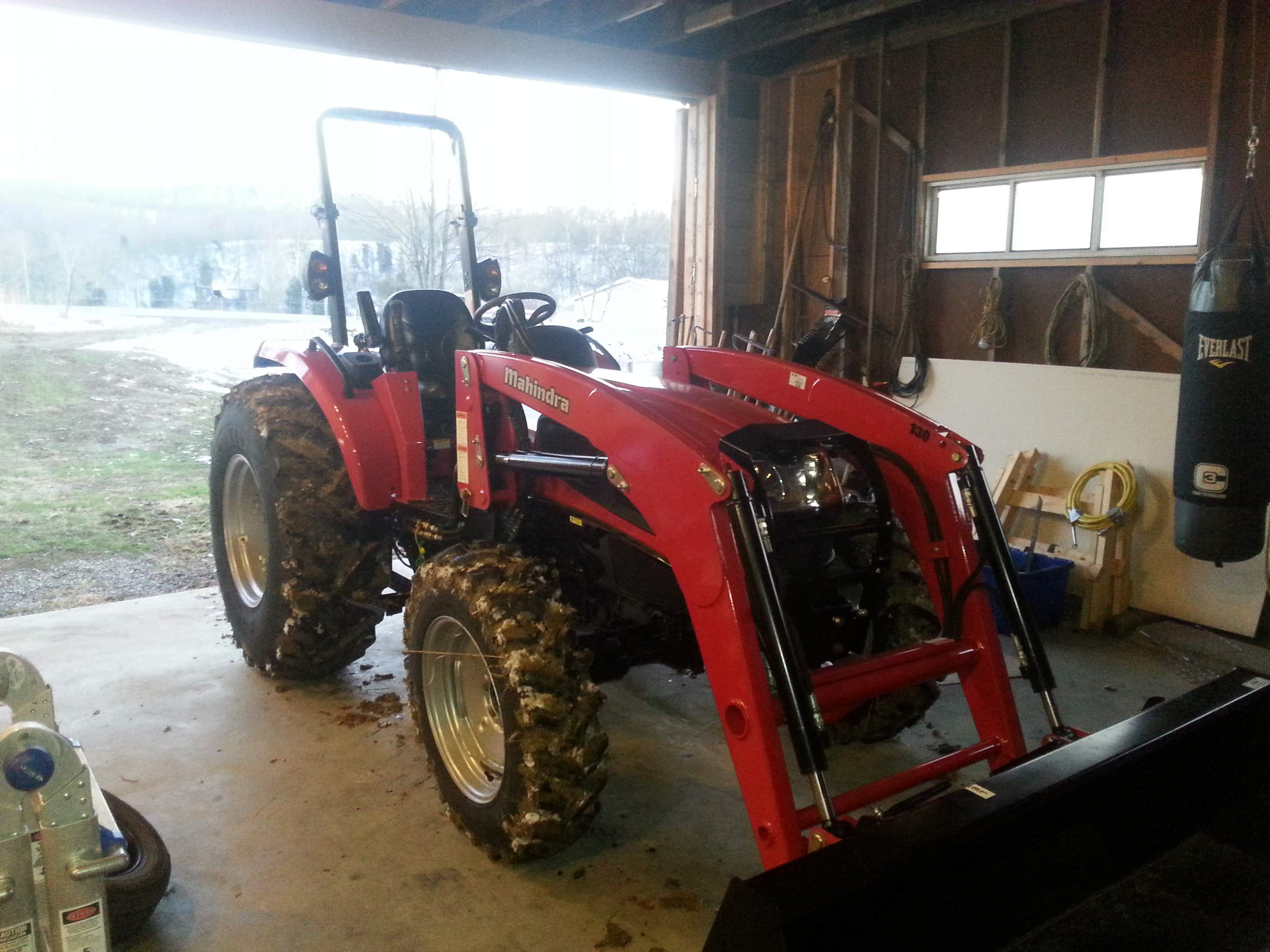

Well I went and did it. I have a brand new 5035 in my possession. It was the last tier 3 machine on the lot. I got a 6 foot tiller and a 6 foot shredder along with the front end loader. I had the dealer run hyd lines from the rear hookup to the front end loader. So I can operate a grapple I have yet to purchase. I came with AG tires, which is what I wanted. I'll get the tires loaded when I get a chance. I'm really tickled. This is the first new tractor I have ever owned.
This is also my first diesel. Do you have any recommendations for fuel additives to prevent jelling? Do I even need to worry about it?
How about a block heater? once again is it needed? Any thoughts?
I attached a bad photo from my cell.

Always happy to see a member get a newie that one-ups my best. Very nice pick, IMO. Congrats!
