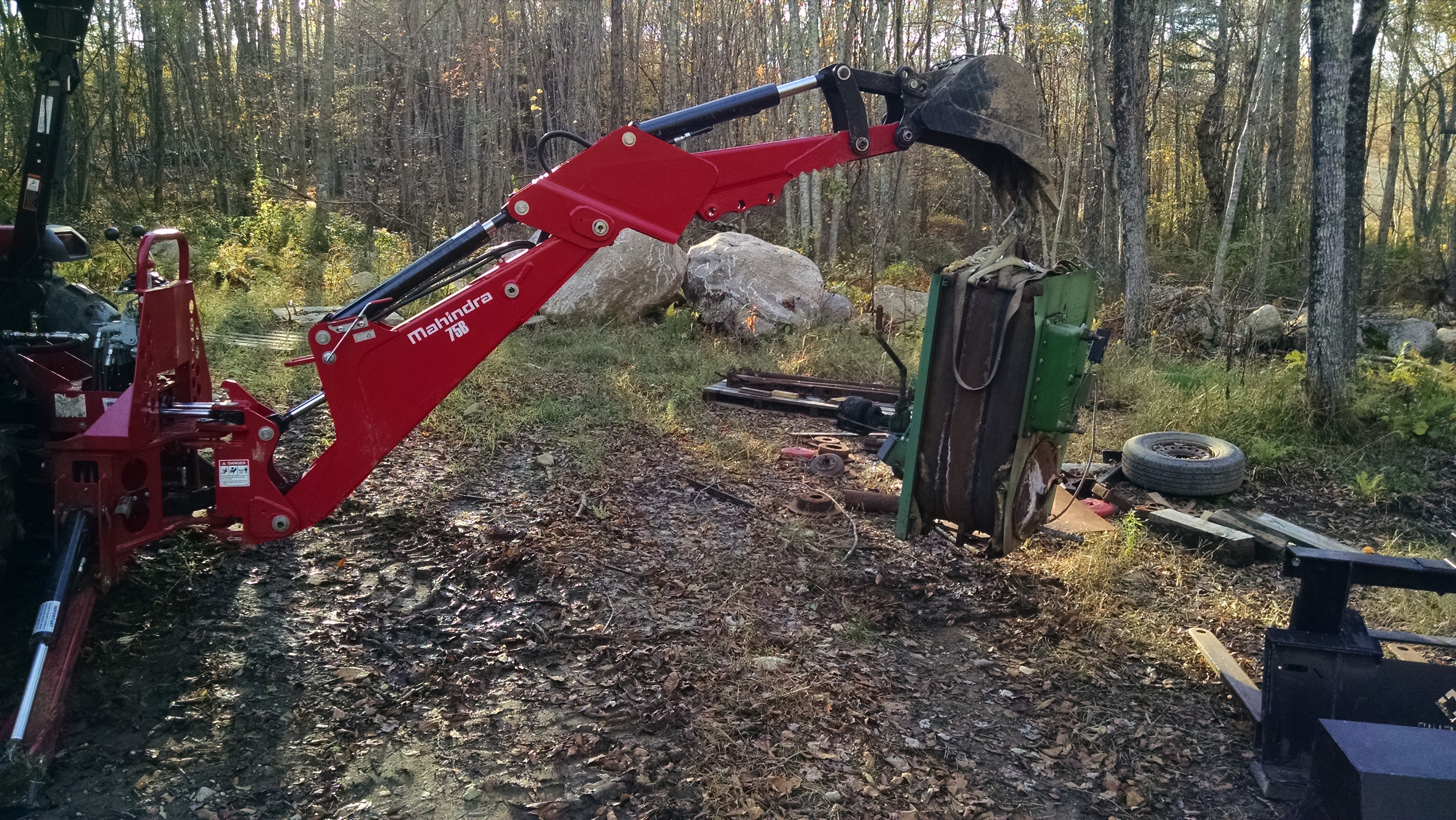

Yes, I have one. I bought it this past summer - installed it myself. In general I like it. Like I mentioned, the adjustment of the boom relief valve made a big difference. From the factory, they were all set at around 3k psi. If you tried to set the boom at one position, and use the other functions to apply force (bucket when prying a rock or root, crowd when lifting, etc), the boom would drop. Bringing that boom relief up to 4k psi made it much stronger, as the boom will now lock into place much better.
Here's a picture lifting an old GM boiler. I would estimate this at 1200 pounds.View attachment 496424

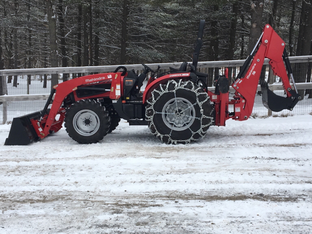

jb1390. As far as the chains go I appreciate your advice. But I think I'm going to go with the rears. I only plan on putting them on once in the early winter and off once in the spring. I do no driving on any pavement. All of my driveways, parking areas, and roads are all stone or dirt. I really need chains. I have owned several machines over the last dozen years. (Usually buy low hour, used machines and sell them after a couple years and after a good amount of work done. Have made out well but am done with that.) I have had problems slip sliding around with every one of them. Even my last one, a JD 210C with loaded tires. Still slid around. Many of our areas get packed down and turn to ice. In addition to that, it is not only the moving of snow that I am concerned with. I do a lot of work in the winter time when there is no bugs and it's not too hot. Like it that way. So I do firewood processing for the next season, and now have a LOT of cleanup work in the woods after having them thinned out. Plus a lot of trail work. Moving dirt/fill to low areas in trails, etc. Tons of that over the coming years. So I don't want to put too much stress on the front mechanics of the tractor. Lifting heavy loads with the grapple or bucket and then moving them around with studded chains on the front tires.
Do you folks have your rear tires filled?
