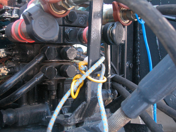

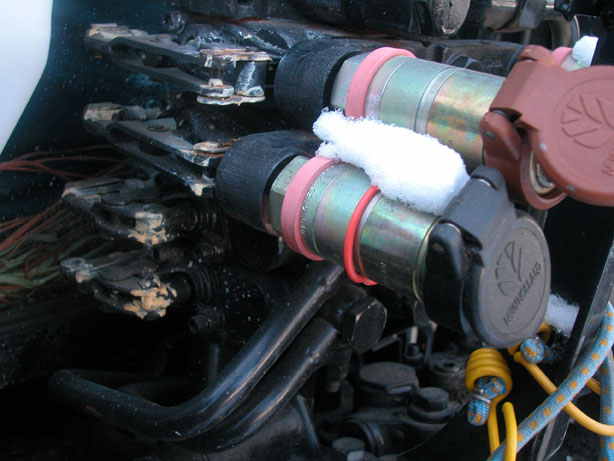

Hello, I have been reading this site for awhile, but just figured out how to get registered. I have had a NH1920 for several years and recently bought a 2004 TC40 and a 2002 TN75D. Today, I purchased a BushHog M446 Loader for the TN along with a NH kit of pipes to relocate two of the rear remotes to the underside of the tractor for connecting the loader. The instructions for the plumbing kit are not very clear - only drawings, no text. I can't figure out where to mount the bracket for the relocated quick-connects and the routing of the 8 pipes. Does anyone have this setup on their TN and would be willing to answer a question or send a picture? Also, has anyone installed the loader mounting brackets (NH or BushHog) on a cab tractor who could shed some light on raising/tilting the cab to access the bolts? Thank you in advance for your help. Jason - Senoia, GA

My TN75D has the side loader outlets, hard plumbed into the rear remotes. If it doesn't snow too much I'll try and take some pictures tonite to post tomorrow. I believe that the newer TN's have the actual loader valves mounted by the side outlets.

Thank you - that would be most helpful. Pictures - especially of the area below the right step where the bracket mounts to hold the four quick-connects and the area where the pipes connect to the rear remotes would help me to finish the installation. The small illustrations provided with the piping kit show a mounting configuration of the bracket under the step to holes that do not exist on my tractor. I agree with you - the newer tractors that I have seen (with the black paint on drivetrain) have the actual valves mounted in this location. Good luck with the snow - I wish that we had some in Georgia to play in.

finally got the pictures detailing the side mount loader hydraulics. Hopefully these will help. If you need more just ask. I didn't go under because of the snow on the ground. Andy

   / New Man -TN75 Mid-Mount Hydraulics/Loader Question #9
another view
