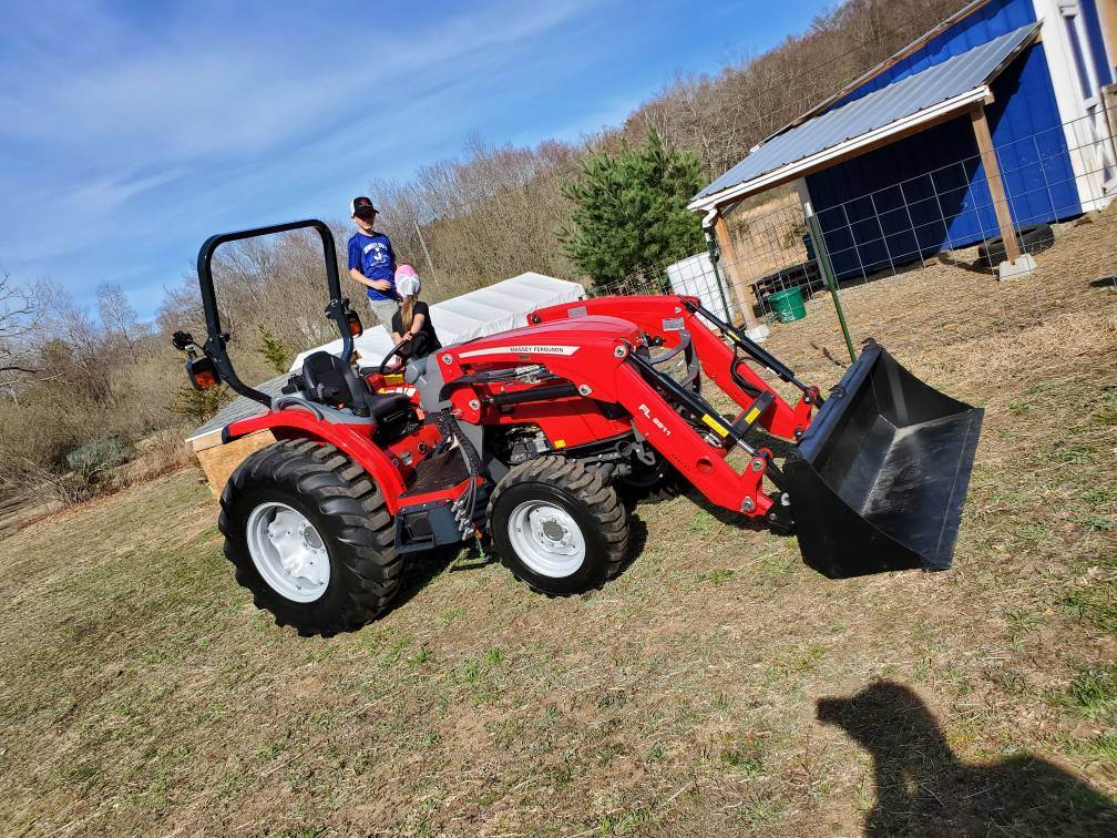

Here is the new unit we took delivery of a couple weeks ago. 1835MHC
