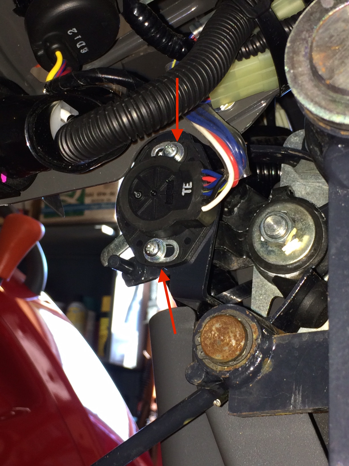

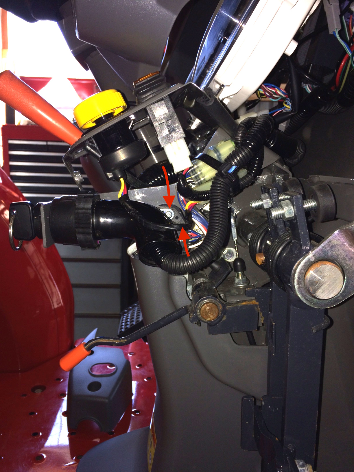

Sold my JD 4005 and 300x loader. Purchased a beautifully designed 2016 leftover MF 2705e with L135E loader, R-4 Industrial Tires, HD Bucket, Skid Steer Quick Tach style latches, Rear Hydraulic Remotes. ONE GLITCH: HELP. Now at 9 engine hours and ECU Trouble Engine Llight(lower right dash Yellow in color) causes throttle to be at idle while on. Happens usually if started with tractor throttle position at idle. Cannot be driven unless restarted with throttle elevated off idle position. All fluids, belt, fuel, etc. are full and checked. ANY TIPS on clearing ECU or what is causing this??? Thanks in advance.

Disconnect the battery cables and touch them together, then reconnect. Touching them will discharge all current stored in the capicitors and should remove short term memory. If the light and code comes back, call the dealer as the loss of power sounds like an emissions problem.

Didn't work. Check light came on again at idle position and no ability to throttle up. Have to call AGCO/MF for a warranty claim.

I contacted the dealership I purchased the MF 2705E from, The Belle Mead Garage, a NEW and GREAT CUSTOMER ORIENTED DEALERSHIP located in Belle Mead, NJ. To save a service call if possible, he suggested that I check the Throttle Position Sensor adjustment located under the hand throttle assembly. I accessed the Throttle Position Sensor(TPS) by removing the gray plastic instrument and steering shaft covers. The TPS was in the fully clockwise position and two screws were snug with no visual indication of slippage. I loosened the screws, repositioned the TPS by rotating the adjustment fully counterclockwise and retightened the two screws. I removed/reconnected the negative battery cable to clear the ECU trouble codes. Restarted the tractor with no Yellow Solid Indication Warning Light. The engine idle position was now at approximately 1000 rpm. After repeated throttle up/down and restarts, as of this point there are no ECU indication lights.
