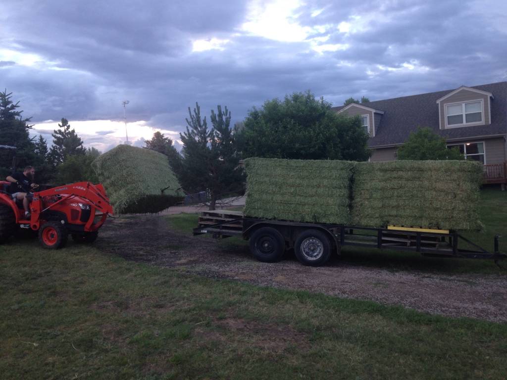

Economy Ls arent safe when moving big bales on the loader. With my former L3200 I helped a friend move a small barn load of allegedly 1,200lbs bales. Could lift them maybe 1 bale high on most bales & it was heavily blasted + loaded tires. It was sketchy as **** with the back end barely on the ground despite 200lbs of junk on the back of a 5' rotary cutter.
My L4060HSTC & LA805 loader on the other hand runs out of hydraulic oomph lifting 1,700lbs & feels solid with little to no ballast (I normally properly ballast anyway).
If you plan on lifting any big bales with a loader, get a Grand with the medium (LA805) loader. An economy L will do fine with a 3pt bale spear, but not with the loader. You only get a foot or 2 of lift with the 3pt bale spear though.
The economy Ls are fine machines, dont get me wrong. They just have their limits & half the weight (and price) of a Grand. I upgraded because I wanted a cab & other bells & whistles as I started doing side work with my machine. After owning it, HST+ is the only fancy feature i really use, but that 2 speed shift on the fly tranny is so worth it. IMG_8896.jpg
