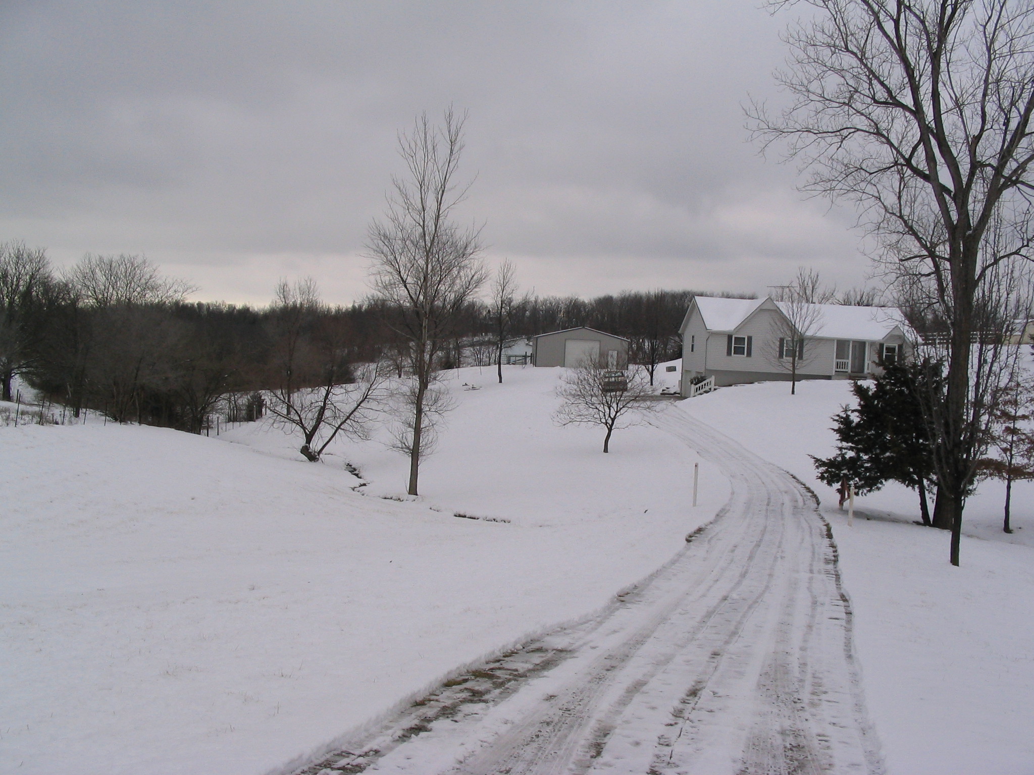

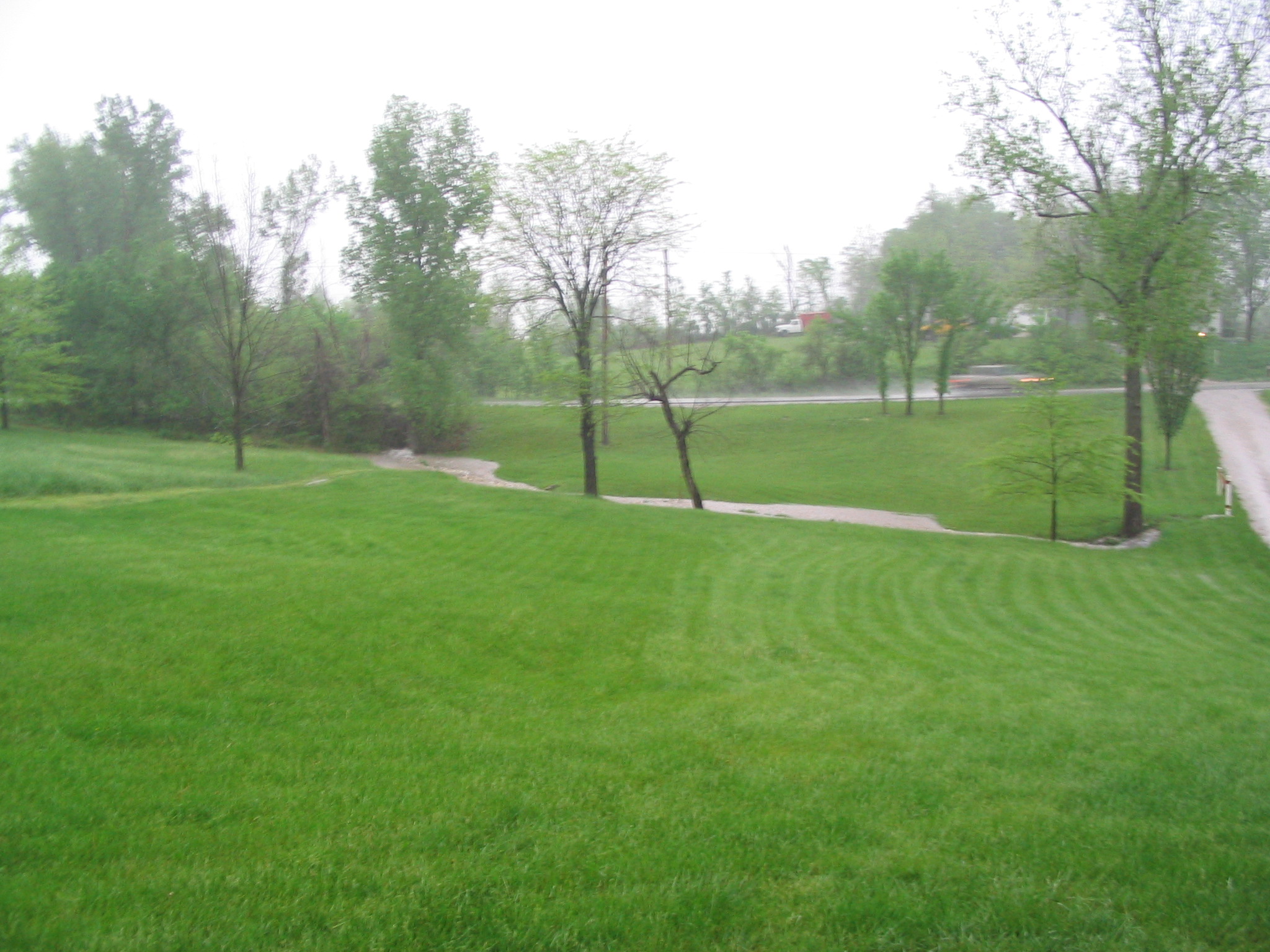

Hi all. New member from Missouri here making an introduction. I have recently moved to six acres of rolling hills that need to be finish mowed (2 acres) and rough cut (4 acres). Slopes in some areas are fairly steep (up to 17 degrees) but for the most part, it is just lawn and pasture grass on fairly gentle slopes. Some of the ground is a little rough, but no stumps or rocks to speak of.
I'm on the verge of making a decision on a compact utility (or maybe even sub compact?), however, I'm somewhat torn. As you can see from my avatar, I'm doing the whole thing now with a 1989 JD185 (38 inch mower deck). It is a tough little lawn mower for sure, but won't last much longer under this pressure.
To the point, I'm thinking of a 2520, but have some reservations that lead me to also considering the 2305. I really like the idea of staying small for the maneuverability and finish mowing ability, but am aware that it would take forever to mow the 4 acres with a 4 foot cutter. I will also be buying a 200CX, rear blade, box blade, 60 inch rotary cutter and snow blade. Maybe pallet forks and snow blower just for fun in the future.
Questions:
1. The stories of the 62D mower wheels have turned me off on that deck (maybe unnecessarily?) so I'm considering going with a RFM. However, the dealer pointed out that running the wheels wide side out(necessary for the side slopes?) would not leave much trimming ability with a 60 RFM. Does anyone here run a 72 inch RFM on a 2520 and does it handle it OK? (I'm thinking of a Frontier GM2072R).
2. On the slopes I mentioned, does everyone agree that the rear wheels must be run wide side out? I would rather stay away from weighted tires if possible.
If it works, I tried to attach pics showing the front yard and the 17 degree side slope (to the left of the driveway in the snow picture).

The width of the wheels make a world of difference and with slopes up to 17*, you do need them set out. As far as weights go, there are ways to get around them being semi-permanent. Here is how I did it.

I saw a pic yesterday where Deere had installed the grease fitting on the 62d. That fixed mine. A 72" mmm is listed for the 2520 so a 72' rfm should work. Always try to mow up and down the hills instead of side hilling. I do mow some steep ditches with my 2520 (side hill) with no problems though. JC

Thanks for the responses guys. Good information as always. I really think I have settled on the 2520 because I need the 60 inch rotary cutter for my pasture.
My wife reminded me that I once said I was glad I "overbought" when I got my lawn tractor and she thinks I should go for the 2520 over the 2305. So, who am I to argue with her?
I'm hoping that the combination of a rear finish mower hanging on the back and some suitcase weights on the front, along with setting the wheels on the wide setting, will provide the hill stability I need. Seems like mowing up and down on some of them isn't an option due to obstructions located at the top.
I guess if it feels scary, I can always keep using the lawn tractor on the real steep areas and the big machine on everything else.

I'm really concerned about the stability aspect of things because there seem to be a number of areas where the only practial way to mow is side hill, not up and down. I'm just afraid that trial and error may not be the best way to find out the limits of the 2520. I know that I can mow these hills all day long with the lawn tractor, even lean to the outside and the thing doesn't even start to tip, but, having no experience with a bigger tractor, I just don't have a feel for where the limits are.
