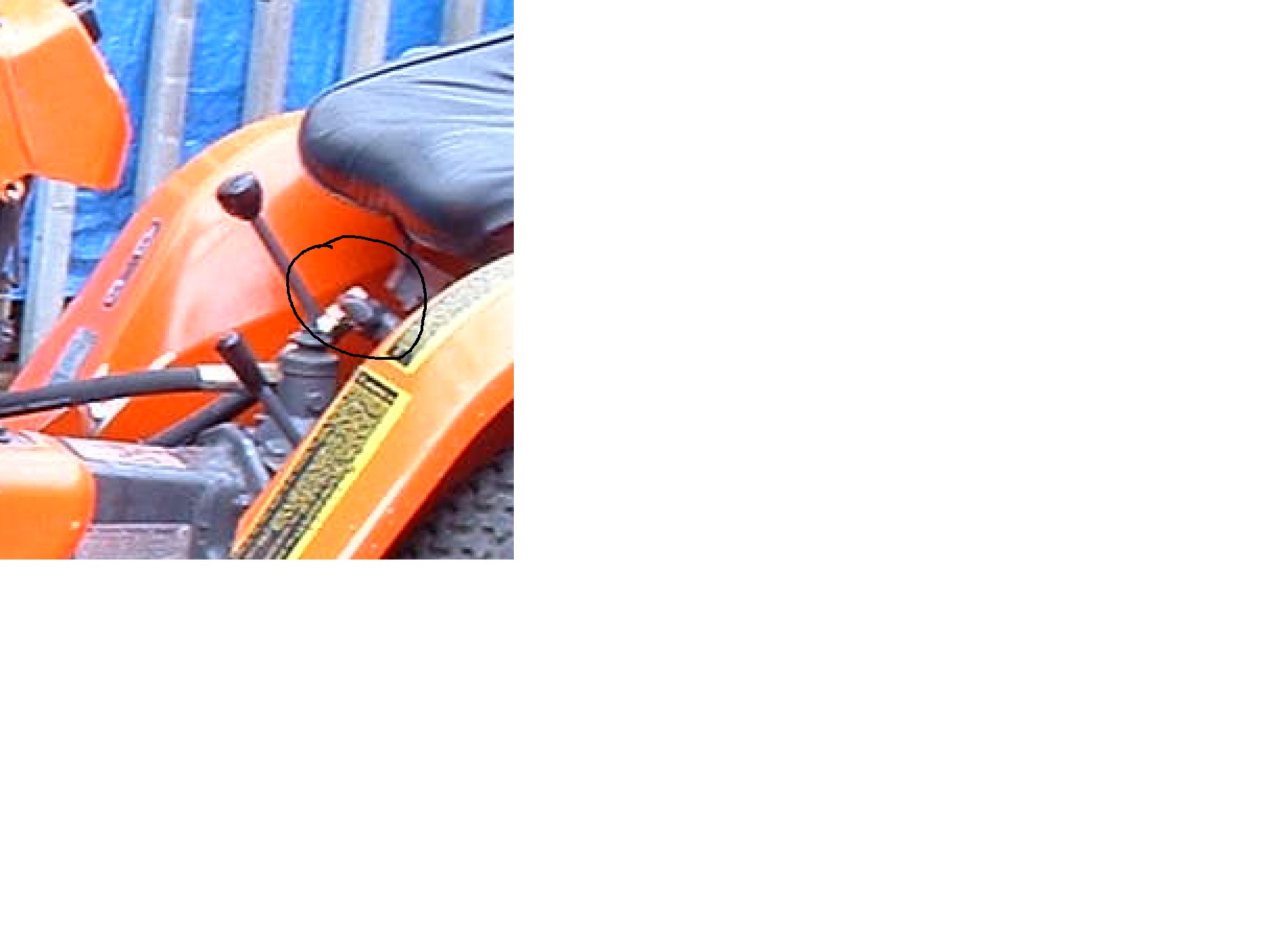

There is a selector switch below the front of the seat on mine with a port to the right side. This feeds my Spool valve for the FEL. To power the backhoe you would tap off the Power beyond port on the spool. System drains back to a fitting that replaces the filler cap for the transmission.

To operate, 3pth hitch lever placed in neutral, selector switch in front of seat is switched with arrow pointing towards right, engage the 3pth lever and operate the FEL. Switch 3pth lever back to neutral, switch selector arrow to the left, operate 3pth as normal. FEL not operational.
