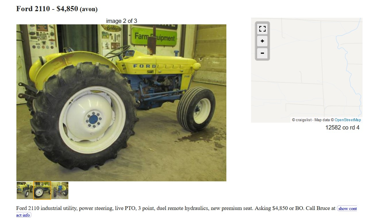

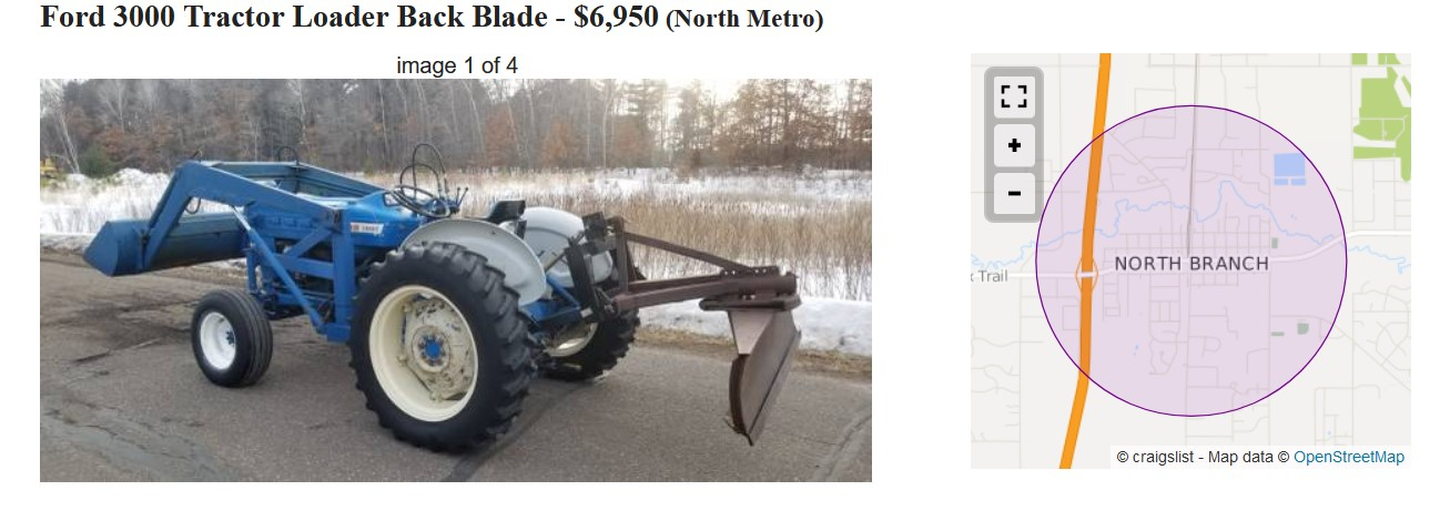

   / New Member Looking At First Tractor - Ford (9N/8N) #35
I'll say it again, these look like options worth looking into.
