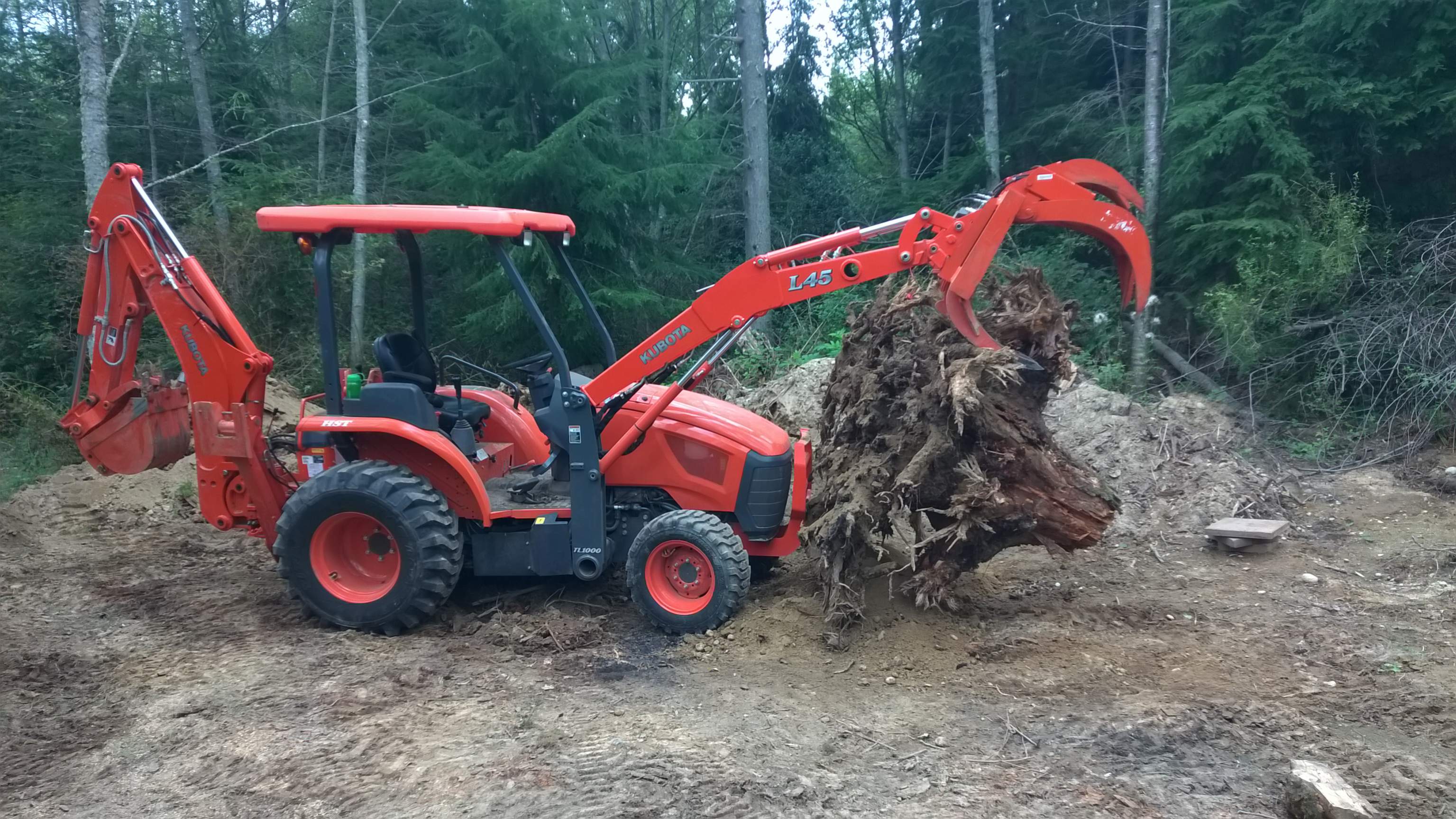

Will there be digging involved. Landscaping or moving rocks. Any land clearing (the attached picture was from me removing a stump, when I was clearing an area for a 12x12 shed)

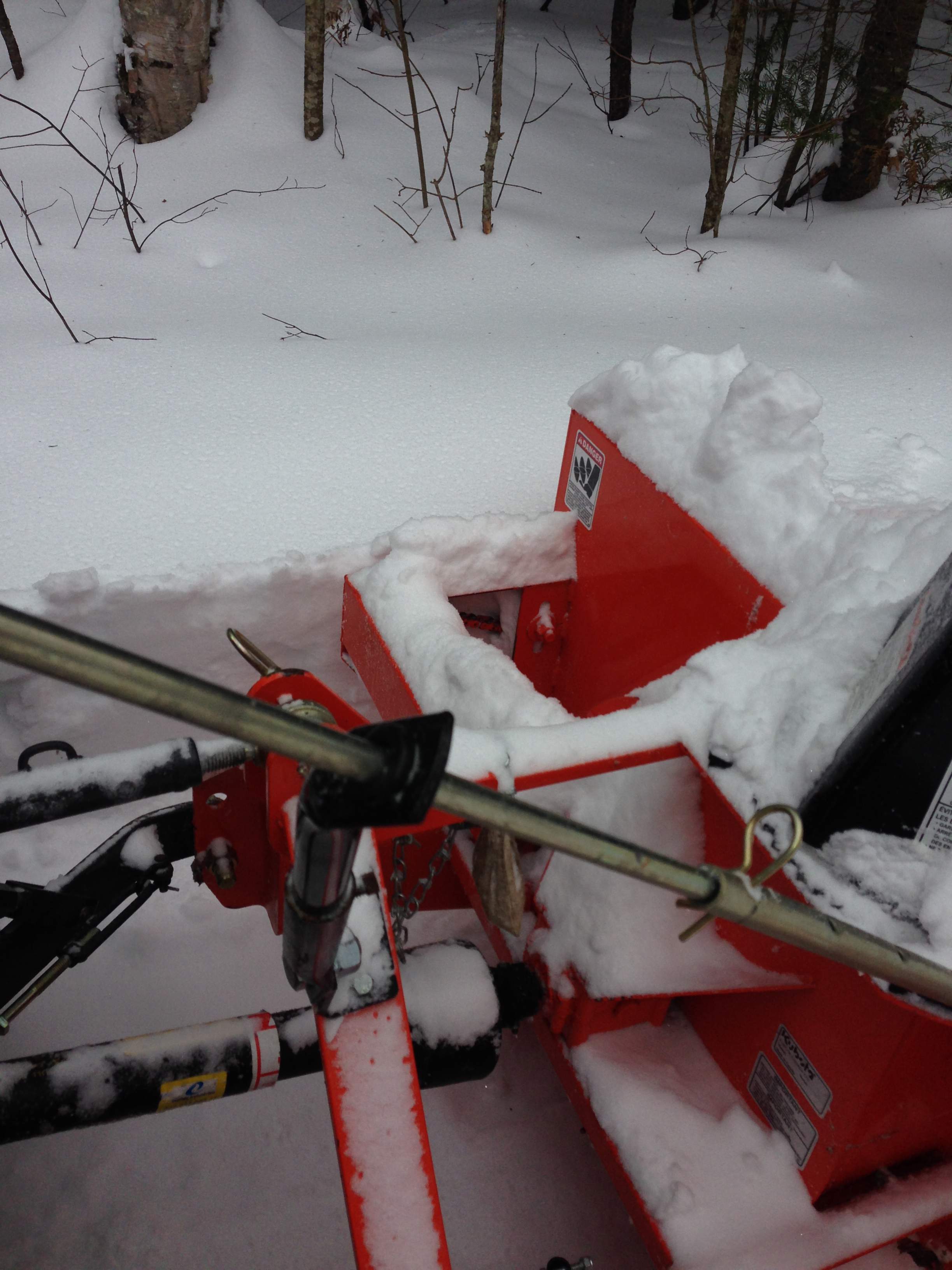

For your BX25, that would probably mean you waited until the snow was a couple of feet deep. If you're getting that much snow you're going to have to make multiple trips anyway, so not letting it get super deep shouldn't be a huge issue. There are a lot of discussions on the topic, and the folks up north mostly seem to say it really isn't a problem.
Actually my rear blower, the B 2789, for my BX 25, could handle 2 feet no problem, but I've never had that much. Nor have I ever had to make multiple passes with it. It's quite the beast, and so I am confident that it will handle anything, especially because it is so sturdy compared to the front mount model. The OP's 900 foot driveway is a very long driveway, and it would be a big pain to have to move those windrows after plowing until the road got too narrow. I also have an ATV, so what I do for smaller amounts of snow, and for the sake of speed, is plow with a $500 snowplow that I put on the front of ATV, and then I will use the blower if I need it, or when I want to blow away the windrows after a few smaller snow falls.* This system works great, and especially at the beginning of the snow season, when I plow with the ATV, I can leave a little bit of snow on the driveway, and I pack it down as I'm driving with the ATV. Then, we have a nice hard packed base for when I use the blower, so that I do not pick up gravel.
*Another nice thing about the ATV plow setup is that you can clear a path in a big hurry for when e.g., you arrive home and can't even get in to the driveway, or when you need to get the tractor out of the garage before you start the blower. I generally like to plow 2 rows down the middle of the driveway first (one pass in each direction), which I can do easily for anything up to about 8". (This takes mere seconds, because the ATV moves so fast and has such excellent traction.) Then I make 2 passes with the rear puich-type blower (one on each sides, where the windrow is), and that's it. Works very well! On the other hand, if I have a large amount of snow I go straight for the tractor and I can usually get away with 3 passes (the third one being a "clean-up" pass for the middle. This, of course, is when it is the most fun (remember the fun factor?), because there's nothing like watching THE BEAST chew into a pile of snow that is as high as the blower is.
Kind of like this:
Regarding traction, I have NEVER run out of traction when I had these on:
