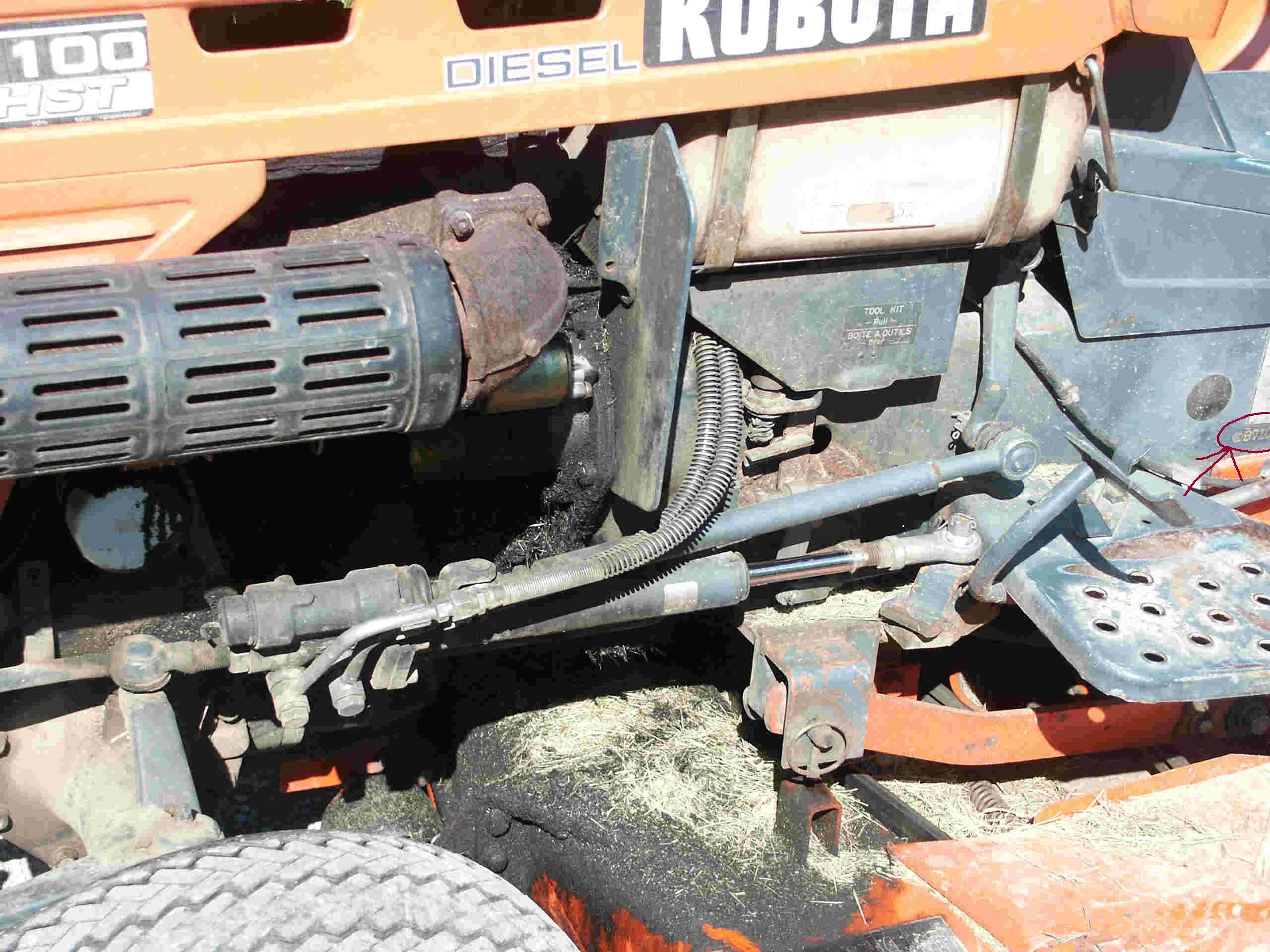

Now don't judge a book by its cover but here it is:
   / New member need help with old serial number #2
That seat was robbed off a chair from my '86 high school Spanish class, I swear!

G'day, Mate! - and welcome to TBN. You are right to think the seller's asking price is high. $4k AUD ($2.6k US) is about twice what something like this would bring here. I'm assuming from the pic its not 4 wheel drive.
   / New member need help with old serial number #4

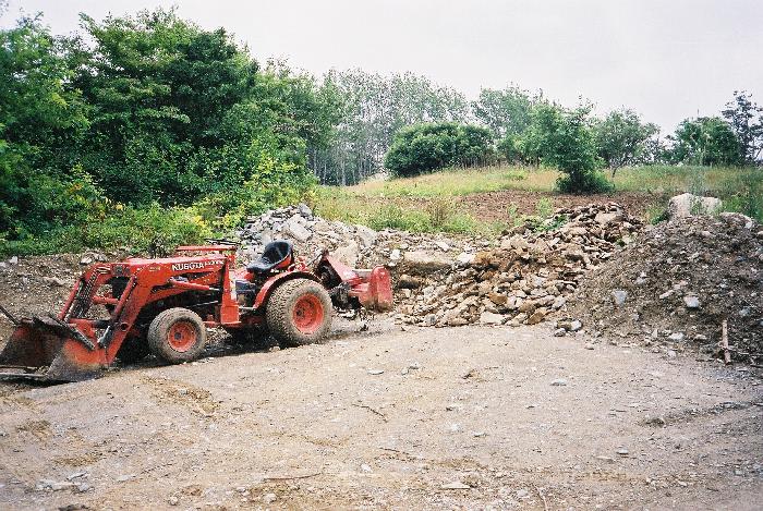

It does look a lot like a B7100. If so it should be a 16 HP. tractor with about 12 or so at the PTO.:D
Comparison picture but this one has four wheel drive and HST.:)

Welcome to TBN. Look on the left side of the transmission housing above the foot plate. There should be some numbers/letters stamped in to it. Part of the sequence is the serial number. This applies to tractors sold in the US and may not apply to your tractor. Post any numbers you find and one of us might be able to tell you the year of manufacture.

It should be on the left side of the of the trans housing like texbaylea said. If you get that number for me I can tell you what year it is, if it is a B7100. I have the numbers right in front of me.
The numbers circled in red are the numbers to look for, the serial number follows the "B7100" in pic.
