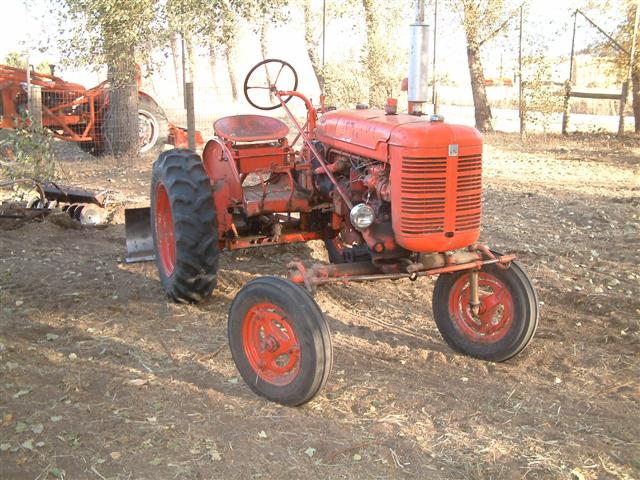

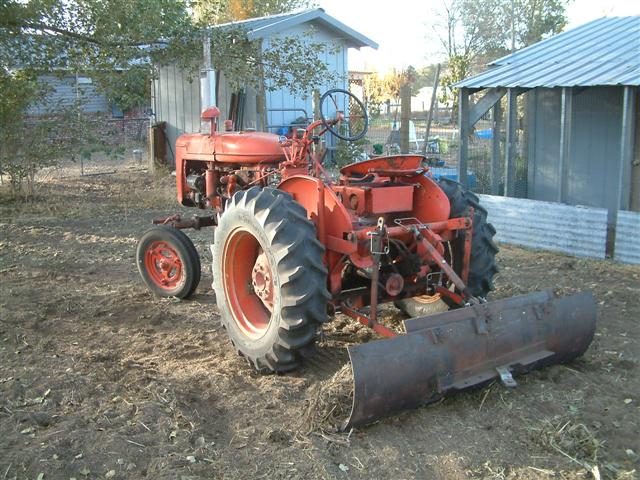

OK. I understand your situation better now. You're thinking about going into what used to be called truck farming (row crop veggies). So here's a suggestion--get yourself an old Farmall A, B or C tractor. They're relatively inexpensive and you can shop around for tilling and cultivating implements that will fit.
Last year I bought a 1951 Farmall Super A tractor for $1300, including a mid-mount sicklebar mower and a rear blade.
